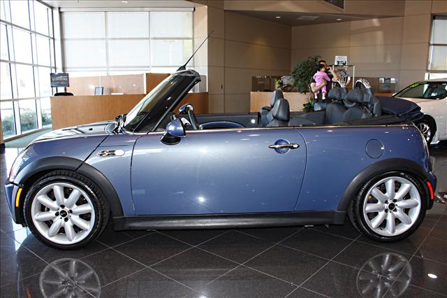

Can you kind folks take a look at this picture and tell me if you see anything that doesn't seem quite "right"? I went and looked at this car today, and aside from minor normal wear & tear issues, everything looked good with the exception of one thing - the rear ride height. Maybe I'm just fixating on it, but I don't recall having seen this much "tuck" on the rear of an S car before - coupe or cabrio - without it having some sort of lowering kit. I'd be shocked if this car did, as the Carfax shows it was a 1-owner lease for ~4 years. I wouldn't imagine there'd be many mods done on a leased vehicle... Anyway, without further adieu, here she is:
Hmm... I also just noticed that it has black plates on top of the strut towers (not connected by a bar) that another '05 I am looking at does not have. Perhaps it has been modded?
interesting. I took a look at the picture before reading your post or any of the following posts and the first thing i noticed was the rear looks really low. Maybe its the photo, but the rear definitely looks as if it is not stock or something is going on back there
Maybe take a look at the rear suspension and see if anything looks not stock
ah, it possibly has been modded (minimally at least). The black plates are strut tower defenders made by m7, cravenspeed, or the like. They protect the struts from becoming mushroomed from heavy impacts, etc.
They are good, and a lot of people do have them on their cars.

Pix/Description: if you're interested in the car, go test drive it and bring a list of things you want to check and ask about. Photos are 2-dimensional and deceiving depending on the angle/perspective/lighting. Despite the rear wheel gap looking like it's lowered, the car appears leveled. However, the 2 (tail-pipe like) tubes sticking out of the rear bumper are for a bike rack attachment (modification). If the rear end was overloaded often enough, it will sag. I can see the rubber seal where the convertible top meets the windshield frame (driver side) is torn and lots of scratches on interior rear panels. The black plates on the strut towers don't necessarily mean the suspension was modded. They are there to prevent the weak sheet metal from deforming - a defect from the factory. Aftermarket suspension components (springs, struts, shocks, sway-bars) *usually* have colors other than black. There's no side curtain airbags in a Cabrios. Man, they steam-cleaned the engine bay real good... everything has a thick coat of Armor All.

Good catch on the bike rack mount. I noticed the attachment points when I did my walk-around (the dealer didn't know what they were, btw, but I did), but I didn't put 2 and 2 together regarding the possible link between them and the sagging rear. I've looked at many cabrio pics since my original post, and I can't seem to find any that have the same appearance in terms of rear wheel gap. I even found another '05 S cabrio on the market with an 04 build (by VIN) like the one above, and its ride height appears completely normal.
