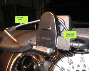

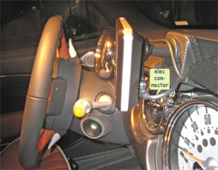

Not Bluetooth!
Its definitely not bluetooth! I have come upon a solution that does not involve this particular kit, and in the long run, I'm thrilled.
But it is bluetooth, I have used it for months, and have had NO problems.
I bought a NUVI 760 gps, a kuda "holder", and we wired it all into the electrical system of the car. Its a GPS with bluetooth, and my call all come through and go through the NUVI, through the auxiliary to the car speakers (not directly to the car speakers -- its important that it goes from the phone to the NUVI to the car system. Apparently using the NUVI directly through bluetooth messes up the sound. We then wired the cigarette lighter plug with the traffic module directly to the electrical system. The only thing that shows at all is about 1.5 inches of wire behind the holder as it goes into the dash. The only negative is that though the NUVI remains portable, I cannot take the adapter with the traffic module into another car, since it is permanently wired in, but I probably wouldn't anyway.
The sound is great. In addition, I get a phenomenal gps, far superior to my husband's factory nav in his MINI, an audio book reader, traffic alerts, both visual and audio, full use of the steering wheel controls, and all the other goodies on the NUVI 760. I've even been able to use a personalized MINI icon as the pointer on the gps.
My husband and I got lots of pieces of input from this list, and we were able to add our own little bits of creativity, to the point that I wouldn't change it even if I could get the old phone kit to work and get it for free.
I was able to find the NUVI 760 at a great price online, bought some of the parts needed on ebay, and luckily have a husband who gets this stuff and was happy to do this for me.
I would guess we could put together a little explanation of what we did and how we did it if it would help, although I am not sure we could get to it immediately.
Our next little project is to retrofit heated seats. My 2008 MCSc Sidewalk came loaded with everything except heated seats (it came from Texas), but we have discovered, through reading this list and others, that many of the cars come with everything built in ready to be "activated" with one electrical component. One thing I read said it is true of all the English Malt Leather seats! So......
Mikey tried to be helpful but never acknowledged the problem to be really there. I now know of 8 such cases. Too bad.
I hope this is clear. No Parrot, no "kit", just a NUVI 760 with wires and fuses added. By the way, when I'm listening to an audio book, it stops for traffic alerts and then picks up right where it left off. I LOVE the whole system.
bcg
(not proof reading, got to go to work!)
pics of nuvi 760 set up
Can you include me in the list for request for pics for nuvi 760 set up.
Continuing....Nuvi 760 bluetooth phone, etc.
Here are the last two photos.
Here is our explanation, also:
Kuda mount, with connectors. On the right, the upper connector is the right angle auxiliary cable which plugs into the aux port in the glove box. Below that is the mic connector, which runs up the driver's side pillar and across to the light console above the mirror. On the left is the power connector and traffic antenna, which plugs into a female 12V connector wired into an add-a-fuse in the fuse box. Popping off the instrument panel decorative trim allows access to the space behind the dash; all cables are run to that space and behind the dash to their connecting points. Neat!
