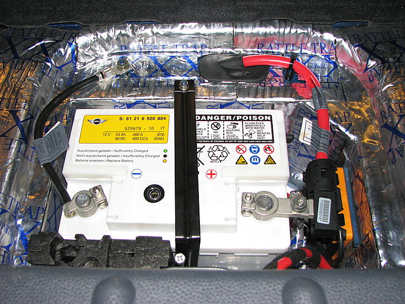

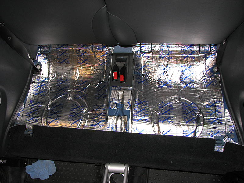

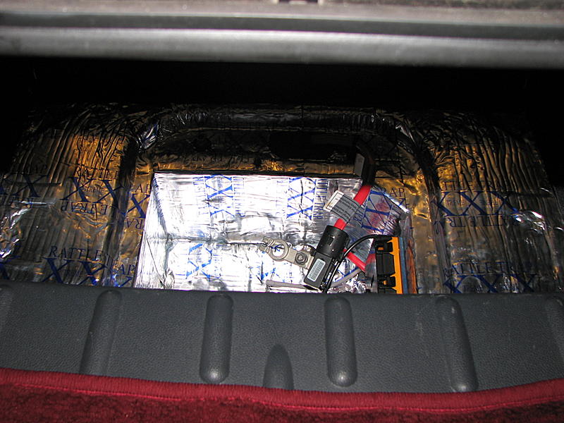

i decided to use sound deadening material to quite down the noise coming into the cabin (caused by the aftermarket exhaust). btw, i went with the ireland engineering single exhaust.
i ordered fatmat rattle trap off of ebay. i've heard good things about fatmat and it was cheaper than dynomat, about $100 for 50 sq feet @ 80 mil thick. the fatmat basic is 50 mil. i applied the material under the rear seat and the trunk floor/battery compartment.
the rear seat cushion came out easy enough but i could not remove and the rear seat back rests. and yes... i did read all the posts about removing the one bolt between the seats and lifting 45 degrees up and out but it did not budge. the trunk was pretty easy too. all in all, for my 1st time doing this it took me around 3 hours.
took the car for a test ride and i'm happy with the results.... i believe it did help quiet the exhaust note in the cabin and hopefully my wife does too
