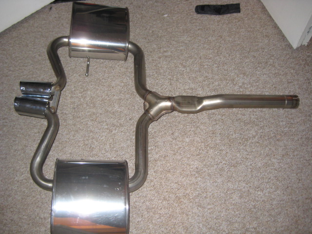

i just bought a jcw exhaust and i don t know if it fits my 05 Mcs convertible? can someone help me?

All kidding aside for just a moment.. Does the exhaust pipe come to a center point or does it go off to the right?

it comes to center ...i hope i bought the good one...

it comes to a center point sO?

For the convertible the exhaust should have a compressed/crimped section of pipe before the "Y" split going to the rear mufflers. The JCW exhaust that came on my 2006 GP had the convertible crimp. However, depending on where you obtained the exhaust it might not have the crimped section.

ok this is the photos of my exhaus do you think it s good for 05 mcs convertible
