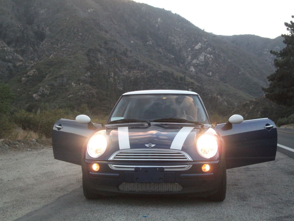

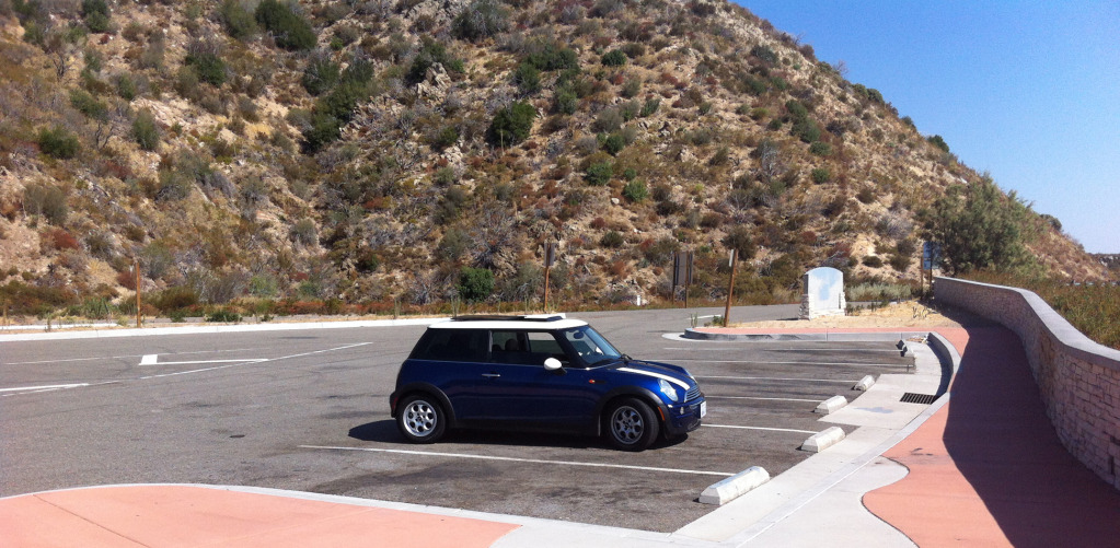

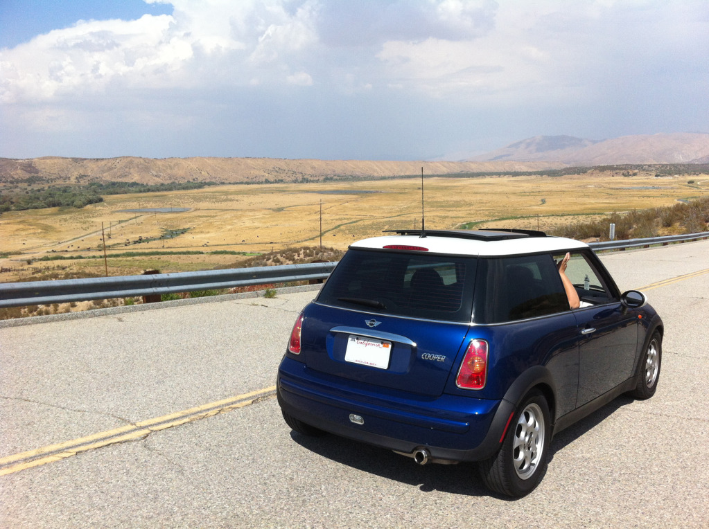

Hehe Congrats on all miles have done
Here is a few of my pics of my 2003 Mini Cooper, from our recent trip.
(97,000 miles)

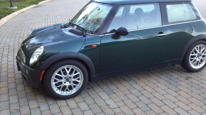

My 2003 r53 is almost at 126k. Everything has been pretty healthy with it. Before me, the owner replaced the PS pump, but that was the only major repair. Still on my original clutch, too! Our other MINI, 2005 r53 is at 182k on a rebuilt engine because of a faulty tune.

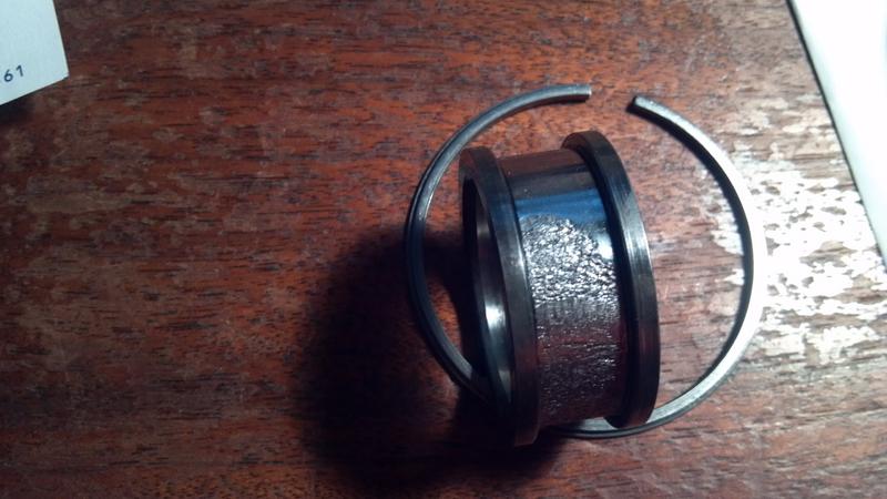

Bearing Problem
Here's the failed bearing from my R65 Midlands rebuild project. This is the inner race on the output shaft roller bearing. (The bearing at the differential end of the shaft.)
The rollers looked good and the outer race was also smooth. Not sure what might have cause this. The oil I drained out was clean, there were almost no metal pieces in the case, and I really don't ever drive it hard.
My guess is that it's just fatigue-related. As I understand common roller bearing failures you get metal fatigue due to repeated load and eventually you get some pieces flaking off. Those pieces can sieze the rollers and cause them to slide rather than roll and you get this sort of damage.
Anyway, I have all new bearings in the unit now and I replaced the fluid with full-synthetic Red Line. So I'm hoping that's the last I'll have to mess with the transmission...

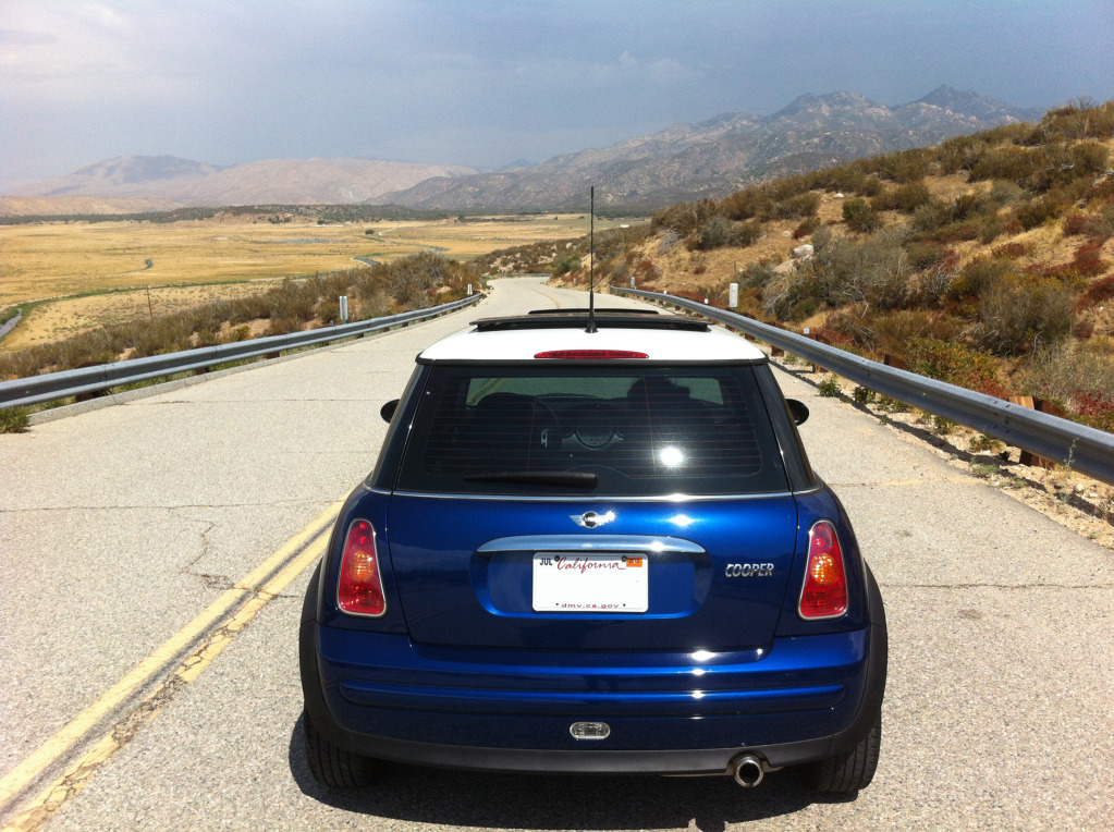

Yup, i tend to like the first gen looks better then the 2nd or 3rd gens. Im sure a number of you have tried the newer models and glad to here some prefer the 1st gens. ^-^
Being the only mini cooper around here in the city lately is nice, from the stares and pointing, and comments, it's nice Just wish i can see and meet more mini's on the road, n ones who don't just look away from you while passing you (tend to notice newer models owners do) is just plain rude -_-
N i laugh when i see people in even mini's stop at a POS Gas Station :D
By the way INDI Blue Rocks for older models :P (Hope you all enjoy the pictures i post up too!)
