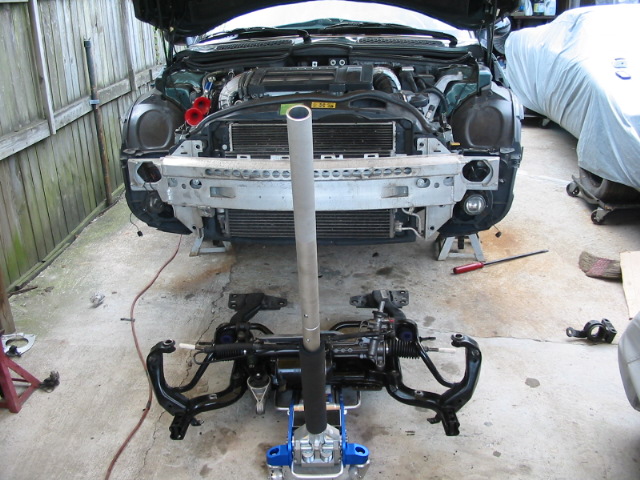

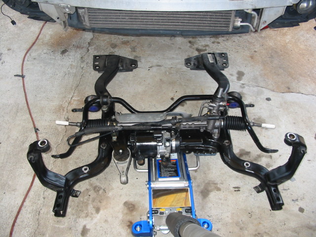

Mine has 110,000 Not a great story here. First, at about 90,000 it started throwing Codes and eventually the car was not running as good as it should. Did a Compression test to find that 2 cylinders had lower compression. More reading I found that the Chrysler Neon Engine has VERY SHort valve Guides that allow the valves to wear them earlier than normal which is also one of the reasons they went to the Puegot engine. I found a good used head (10K miles) and replaced the head bolts with ARP Studs and a Cometic Head gasket. I had to buy the cam aligning tool and on e-bay I paid $35 for special made tools that Mini wants $150 for to pull out the Modular Front end.
Next, the car developed the "Christine Syndrone" where the windows and sun roof would open and close all by themselves. I found that the Keyless entry in the drivers door caused that and replaced it and no more problem
Next I found that the Control arm bushings go bad at 75 K or more miles. When you really look at how they are made it is surprising that they last as long as they do! For me, the best way to replace them is to get the Purple Power Flex Bushings from Auto X Cooper for about $95. The best part is for $15 you get the INstalled Bushing in a core and all you do is send the destroyed Core back when finished! The deal here is you MUST remove the Sub Frame to do this and the Torque to tighten them is "122 Pound feet of torque"! The only thing I have ever tightened this tight was the old VW Alxe nut that used 3/4" drive Socket.
Next, The Steering Rack started to leak and the rubber at the top of the struts cracked so I am replacing the Rack for about $200 and the Strut camber plates with a 1 degree negative plate from Auto X Cooper and the Drive shafts new from the "Find" for abpout $100 each.
Not the Mini's Fault, When I had the car at "Passport Mini in Alexanderia (I mention them by name to let you know that I do not hate anyone enough to send them there) They lied to me about waiting on a Part that was never needed or ordered and they cut the Drive shaft boot when checking the car, Left the Under pan down and did not reinstall the fastners, Broke the Dip Stick and messed up the roof hatch seal and nasty fingerprints inside the car that they said would not come out but did come out easily! the car was there for several weeks while they did nothing!
So over the last 2 weekends (Sunday only) I have removed the drive shafts, (to be replaced through no fualt of their own) the Steering Rack, the COntrol arm Bushings and the Top Strut mount and the Fan.
SOmething good about the Mini! The Sub Frame does NOT support the engine and is reasonable to remove so that you can replace the Control arm Bushings, Steering Rack and work with the Struts and drive shafts.
Yes, it is a neat car but be aware that it is not designed for everything to last more than 100K miles Specially when you "Enjoy" the car. With the new After Market Strut plate and Control arm bushings and the newer head I expect to get to 200K Before I replace the head again but this time with a Re-worked head with longer and better Silicon Bronz Guides.
I also went through 3 exhaust, The Stock went at 53,000 miles when the Header split right at the catalytic Converter near the Flex coupler. The Worse exhaust was Magnaflow! The best is through one of the site supporter the Stratmosphere! It is a little expensive but the welding alone is the Quality of what you see on Motorcycles. It is almost too beautiful to be under a car!
I also bought a set of adjustable lower rear arms TSW WHo is bought our by someone on thise seb site so "Remove" a little of the rear negative camber.
Next, as a lot of you have experienced, the Low Speed fan circuit goes out. I used "The FInd" to get the correct fan for about $85.00 it also helps to have the Pins to slide out the front end to replace this also.
Next,

I would take a Serious Look at the compression of the other cylinders AND Put in a spark plug Sert. If you have the early (Read non French Engine) then most likely you already have Valve Guide problems.
I did my first Oil change at 3,000 then at 6,000 then the dealer at 10,000. Then I did my next at 15 and 20 before the dealer did at 25,000. I used nothing but Vavoline 5 w 30 Full Synthetic Oil.
This weekend I JUST finished the car. I replaced the
Strut Tops with the 1 degree Neg Camber plates
Inner Ball joints (I took the Grease Needle and lubed all of the Ball Joints with Molly Grease)
Left & Right Drive Shafts
Steering Rack
Rear Adjustable Lower control Links
Braided cable Brake lines all of the way around
New Radiator Fan Assembly
New Catalytic Converter (300 Hole metallic)
(Replaced the Brake Pads a week before I did all of this)
Took me 3 Sundays and a few days during some of the weeks when it was not raining Now I can get back to working on the Porsche 911 and my Motorcycles.

Working on the Mini and doing all of the things I posted above. ALso note the Purple Power flex Control arm Busings and the Old one with nothing in the center!
Attached Thumbnails anybody with high miles (maybe even over 100,000) COOPERS ONLY!!-img_4282.jpg   anybody with high miles (maybe even over 100,000) COOPERS ONLY!!-img_4283.jpg
