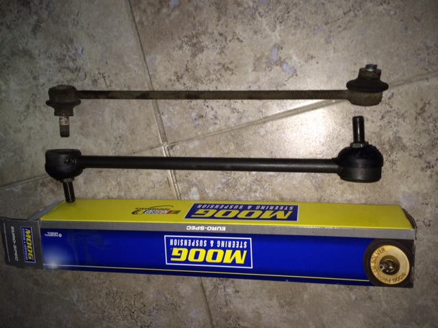

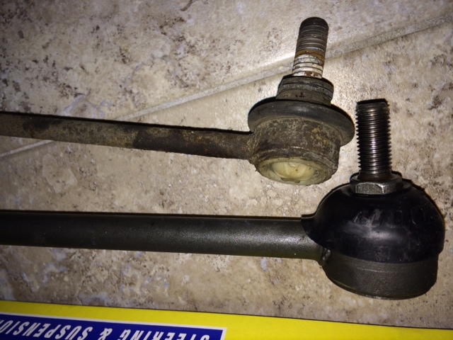

Hmm, they're right! In a first-gen Justa the intercooler simply isn't under the scoop! Neiother is it under the scoop on a second-gen Justa.
But since this thread is a first-gen thread...on a first-gen "S"...
My cheapskate mod: Moog endlinks. 2x thicker than OE, with zerks on the ends, pretty nice, inexpensive "mod".

Folks have asked, pics, got 'em from Rock. Zerks came with, greased 'em and they fit like a glove. I'l need to grease 'em when I change tires winter to summer each year, but no issue for me. Of course, the originals went 90kmiles, so they must be pretty OK!

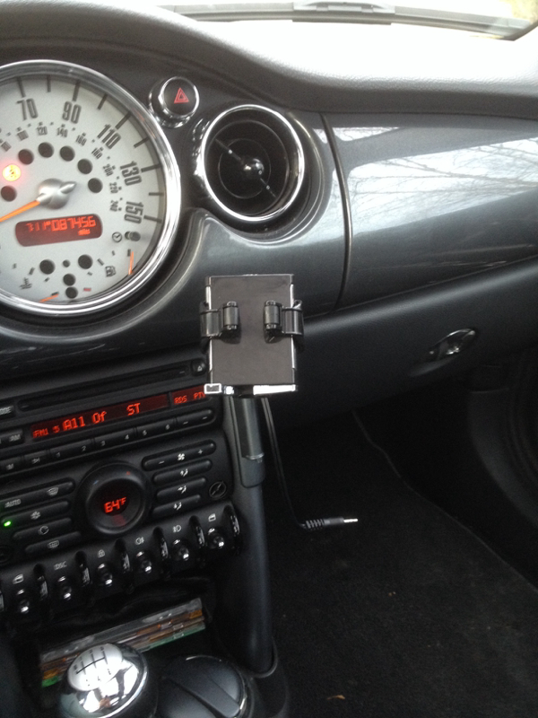

Ipod holder. 13 dollar suction cup mount from target. Cut off suction mount, drilled out the hole on the cup holder. Flexible metal rod fit right in. Reattached the bracket to the tube. Works great!

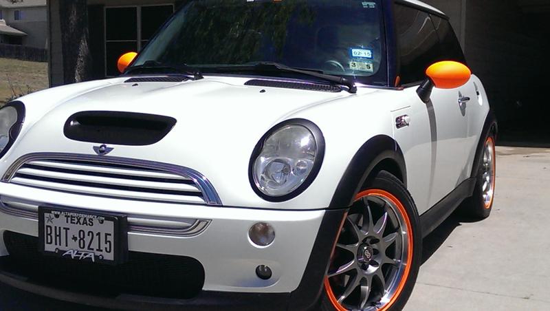

Some of my cheapskate mods
Plasti Dipped Headlight Trim, Scoop, Mirror Covers, Rim Lips.
Debadged Boot. Added Supercharged Logo.

How did u end up doing your scoop and headlight trim? I really wanna do this.

Scoop and Headlight Trim
For the scoop i took it out. For the headlight trim i just masked around it. The glory of Plasti dip is if you get it somewhere you dont want it, it peels off !
Make sure you use the dip right.
Well shaken and warm can
2 light coats, 3 heavy coats. Peel your masking tape right after the last coat to prevent the lines from getting messed up.
If you mess it up. Peel it and start over !
The whole project took about 30 minutes in the hot Texas sun

Thanks for info I'll give it a try next week. I've heard the scoop is a pain to remove but I'll try it.

Scoop
No worries. I think its only one bolt. If you dont wish to remove it, just mask around it ! dont forget to tape a trash bag to the scoop under the hood so you dont plasti dipp the intercooler ! Ahh. Scary thought

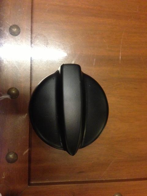

Hobo Boredom Therapy: 3M vinyl + heat gun + plenty o patience=
Reversible & better peeling resistance than dip!!!!

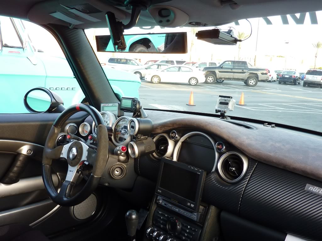

Yes
Dry carbon Dash etc.
