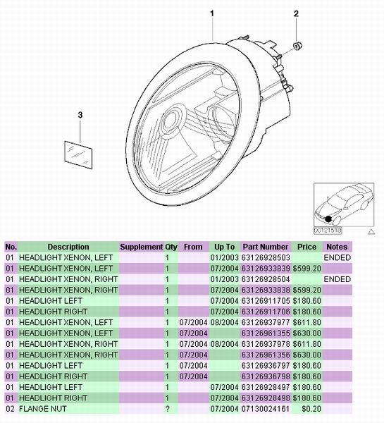

Why not? Sure they will... Give them the part number and they will order JUST that.
You can buy just the outter housing... and they do use the same bulb... part #3
Attached Thumbnails 2005 Xenon Projectors...-housing.jpg   2005 Xenon Projectors...-xenons.jpg

but the problem is....show me which one is a part number for a housing without bulbs. You can buy the bulbs without the housing, but not the housing without the bulbs. The top part number includes bulbs and thus is very expensive.
