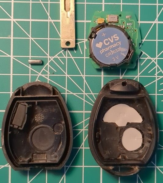

Original key blade, circuit board, shell halves including rfid chip, and roll pin. The buttons have broken and fallen out and I've covered the outside of the shell with adhesive-backed vinyl.

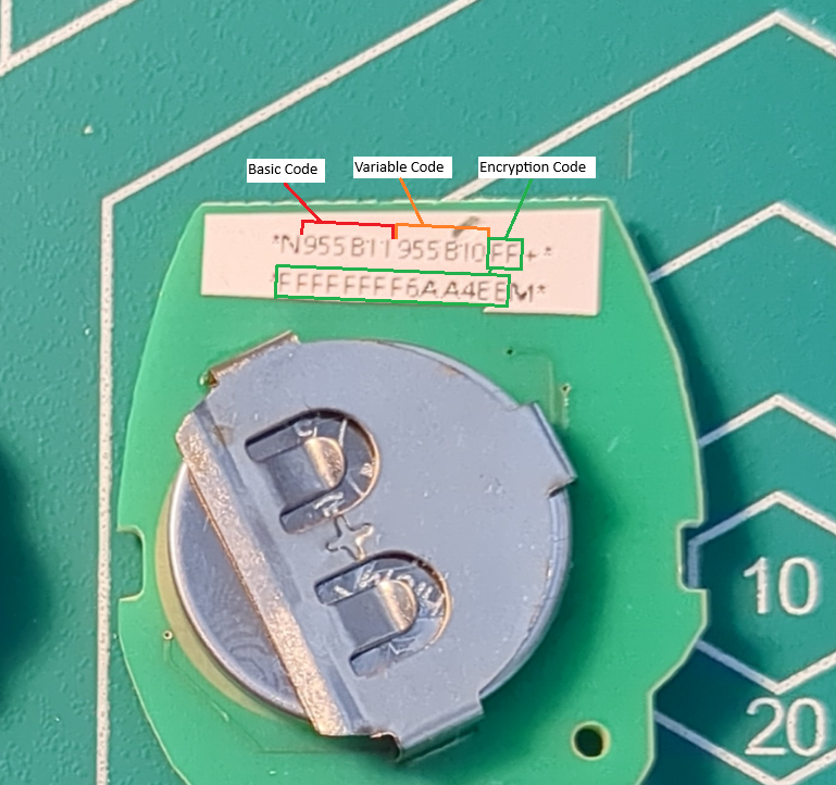

The original RFID chip (the 5-sided gray shape inside the left key half) is labeled PCF7930AS. I believe the term "ID73" is used to identify this specific one, but this may be incorrect. Some people accidentally throw this out, this is needed to start your car. The silver rectangular component above the battery on the PCB has "KYOCERA 315K" written on it. I believe this is the crystal designating the remote's frequency, in the US supposedly we universally use 315MHz. I believe UK uses 433MHz

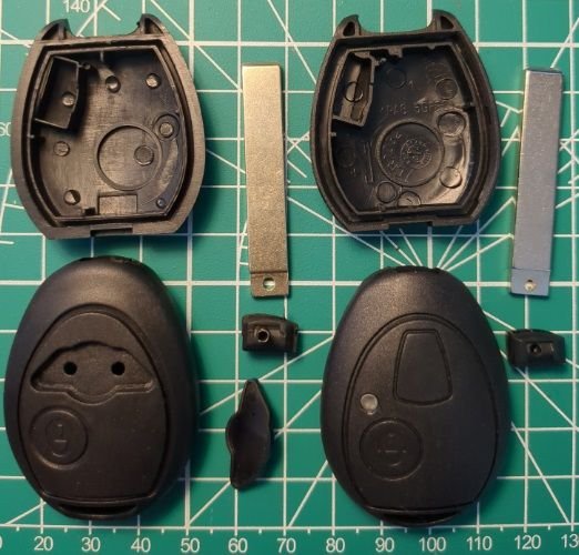

The more common style of aftermarket shell (2 versions):
Shells ordered from 2 different sellers on AliExpress. Each was about $4. On the left, close to the original. On the right, allows the indicator LED to shine through. Both attach the key blade differently, the roll pin attaches the key to a small plastic insert that clips into the end of the key handle. Mini badges for the one on the left must be bought separately, and are sold on size. Itll be listed as
Shells ordered from 2 different sellers on AliExpress. Each was about $4. On the left, close to the original. On the right, allows the indicator LED to shine through which is a useful feature. Both attach the key blade differently, the roll pin attaches the key to a small plastic insert that clips into the end of the key handle. It's a less stable design. On one of them, the key already "wobbles" and I've only just put it together. Also note the base of the key blade has a 1/2 millimeter cut in 5 mm of it, so the end is thinner. The blade might not swap into other shells as easily. Mini badge for the one on the left must be bought separately, and are sold on size: will be listed as "mini badge 22mm".

Second, how do you get into your key and disassemble to swap parts?
  1. Insert a flathead screwdriver into the recess under the keyring hole, and pry off the back cover.
  2. Gently bend outwards one of the two clips on the sides that hold the remote PCB in, and lever out the PCB
  3. Undo the clip holding the immobilizer chip in, and pry it out with a small screwdriver
  4. Remove the roll pin by destructively drilling out the plastic on the front shell and pushing it through, or by grabbing the inside of the roll pin with precisely sized screwdriver tip or other small pointy tool, spinning it as you pull it out far enough to be removed with pliers.
  5. If your original key's buttons are broken off or not working, the button components themselves can be desoldered, removed, and replaced with a 3x6x2.5 mm push button microswitch. I bought a reel of 50 on AliExpress for $2.

What to do with your trashed old key shell?
  • I covered the face with the broken buttons with adhesive-backed vinyl "grip tape". I bought a sheet on ebay for another project and cut it to size.
  • I removed the PCB to swap into one of the above replacement shells
  • I filled in the area where the PCB was with 1/8 inch of epoxy, so the button holes wouldn't feel like holes through the adhesive vinyl. (Below, far right)
  • This created a remote-less key, which Mini themselves used to sell, unfortunately even theirs was same size as the key with remote.
