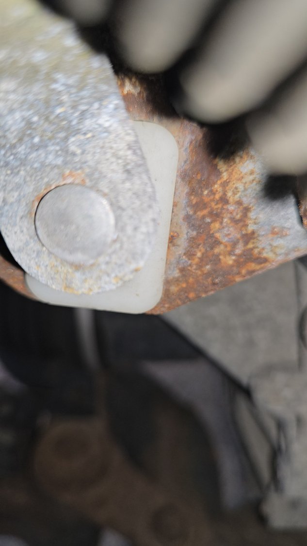

Anyone see anything wrong?

With regards to the shift-weight bushings: It is hard if not impossible to see their actual condition unless you remove it. In the fourth pic looking down from the top, The top of the white rectangle bushing doesn't appear to have excessive wear. However, the real wear occurs within its inner walls where the shaft moves around and wears out the inside. Unfortunately there is no way to see the condition of the pivot bolt bushing without removing it. Trust me - that pivot bolt is/can be a real PIA to remove; threadlocked and torqued down with gorilla force and doesn't allow much room or access to work in. Not impossible; but can be a pain.
I would look at other potential suspects (as mentioned in the other replies) that maybe the cause relating to the issue before moving on to removing the shift weight.
I'm not 100% certain the shift-weight (bushings) is the problem.
