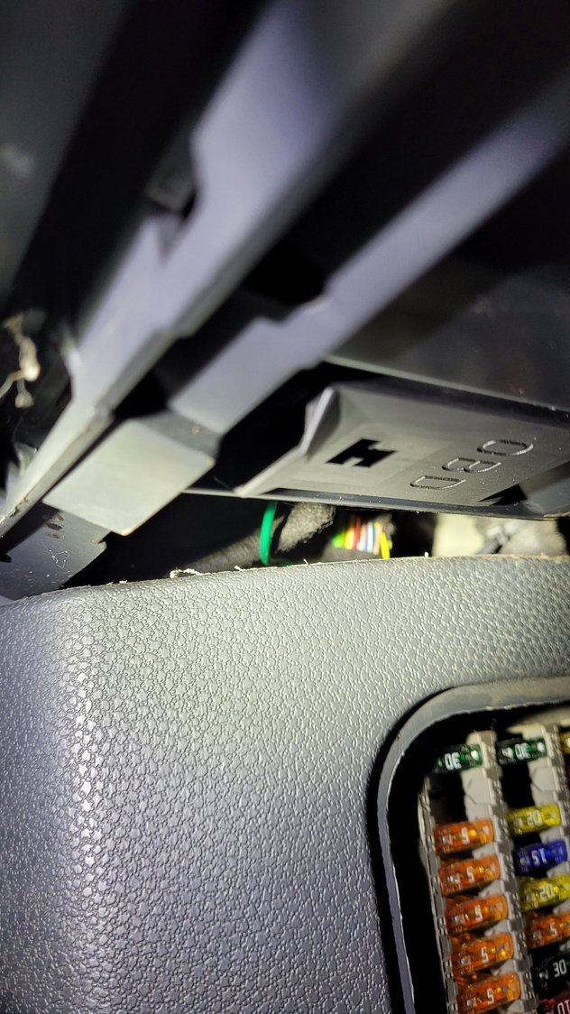

I have this 2006 R50 which had a mysterious wire going from the footwell fusebox to eventually the power steering pump connector. The small controller connector, not the big power feed one. The pump is working so no issue there.
Now I'm trying to unbodge this as I did an engine swap and got a new to me engine harnas with it. So I thought, great! If there was a broken wire in the old harnas, the new one surely fixes it. But it didn't and I am left clueless.
First the bodgy wire from fuseboard to the pump connector.
In the last photo you can see someone unplugged the green wire and put another yellow one in and crimped that green wire from the fuseboard to it.
Here is what I got so far.

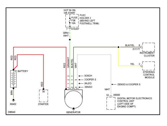

I found these two wiring diagrams:
The first one shows the pump on the left, looking at the bodge they took a live 12v feed from the fuseboard, cut the green wire near the pump and crimped it on there. I checked and this bodge wire is only hot when ignition is on or engine is running.
Now with the new harnas in the car I checked and yellow is getting 14v when engine is on. The green one doesn't has any voltage. Which is obviously my issue. So this brings me to the next diagram.
The green wire from the first diagram is apparently fed by the alternator. So I shifted my attention to that. So I thought, let's measure the voltage of the green wire coming from the alternator plug. That one is very accessible, as it clipped in onto the engine mount. Now this is what really makes me confused: on the back of the alternator are two pins, but the connector on the engine mount has three?

Yeah, assuming the documentation you posted is correct, the Bosch and Valeo alternators only have two pins in that connector, while the R53 and Denso have three.
I figured out how all this worked at one point, but I’ve forgotten now. I think that fuse (F38 or F39) is actually labeled wrong in one of the two diagrams, and I also think it’s feeding voltage to the alternator instead of the other way around.

Yeah, I have a copy of the whole pdf of this from the TIS. I think the F38 label is a typo, and it should be F39 (at least in the US). I don’t think F38 is even populated (see here). You can tell something is off because those two different diagrams with different fuse numbers call out the same connector number (X10207) and pin number (7).
From your descriptions (assuming I’ve understood them correctly because your seemingly interchangeable use of green and green/white is confusing), I would guess that there’s a break in the green/white wire somewhere on the pump side of the junction where it splits off to run to the alternator. Or if I’ve misunderstood, the break could be on the other side. I’m having trouble visualizing where you’ve checked voltage. Is fuse F39 good?

So I shifted to the fusebox at the drivers footwell. After digging it out I found the bodge wire and the original green/white wire, at the pink plug:
As you can tell, someone had de-pinned the green/white from the pink connector and pinned that new bodge wire into it. After unraffeling the tape I found the de-pinned green/white wire to be intact. So I checked it for continuity to that big round connector and it was fine. So I de-pinned the bodge wire, pinned the original green/white back in and sure enough, everything worked as it should be!
To be fair, someone did put effort into it making it look not bodgy. If only they had looked for where the wire had broken.
Now a few things that are very confusing or just straight up wrong in the circuit diagrams:
  • Fuse 39 has nothing to do with it
  • Green/white at the alternator side is just a blank. The alternator does not send a signal on it as it isn't even connected!
  • Green/white is fed by the fusebox, not the alternator

From what I’m seeing online, it looks like fuses 38 and 39 are different between pre/post facelift. Maybe the two diagrams are for two different years? Mini changed the fuse panels between the two, so I could see them having the same pin on the connector potentially go to a different fuse.
My 2006 also appears to have those circuits on 38.
Interesting that it’s the green/white that is a no-connect at the alternator instead of the white.

Ding ding ding, you are the winner. Look at what I found hidden within a YouTube video from "fusebox diagrams":
Seems like they changed the fusebox in 2005 and the power steering pump fuse shifted position.
