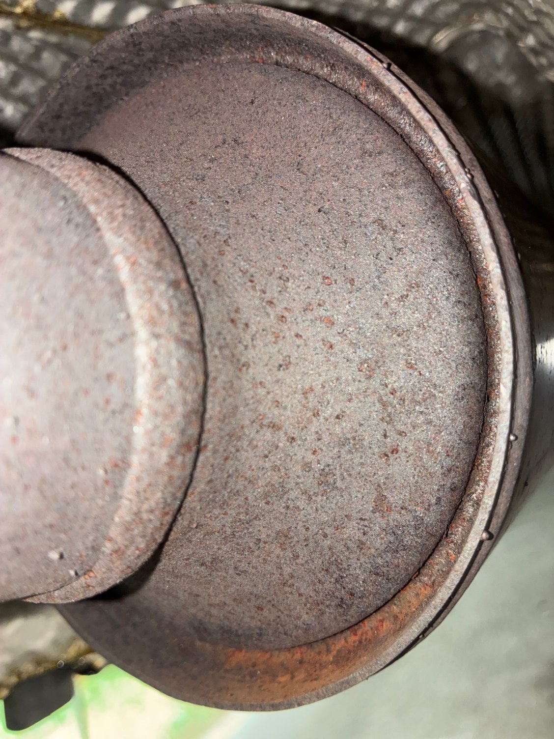

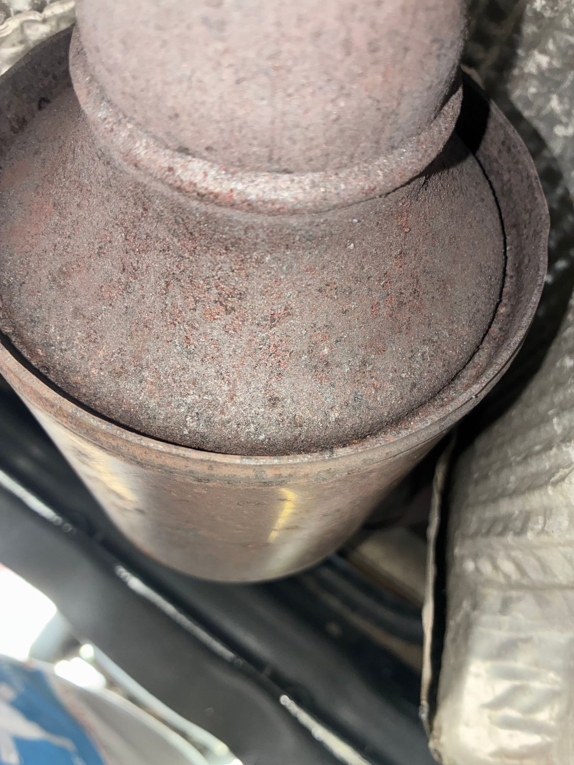

I am sorry to hear that you’ve landed on the cat as the cause of the noise. I had hoped that would not be the case, though from your description it seems just like my problem.
Here are two pics of my cat, which to me looks like it has a crack. It’s tough to tell shadow from crack, however.

That is a press fit. It’s BS. There is a thread about getting it welded. I read that, and had mine welded. Solved a random misfire. I had it done at a shop - never took it out. Done in place.
