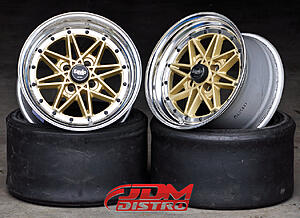

I can't help with fitment question, just wanted to comment on the wicked cool wheels...
...they look like Work Equip 03
Such wildly radtastic rim designs were a JDM specialty,
and the Equip is like an evolution of old Star Shark II:
http://retro-japan.blogspot.com/2014...ar-sharks.html
Neat stuff.

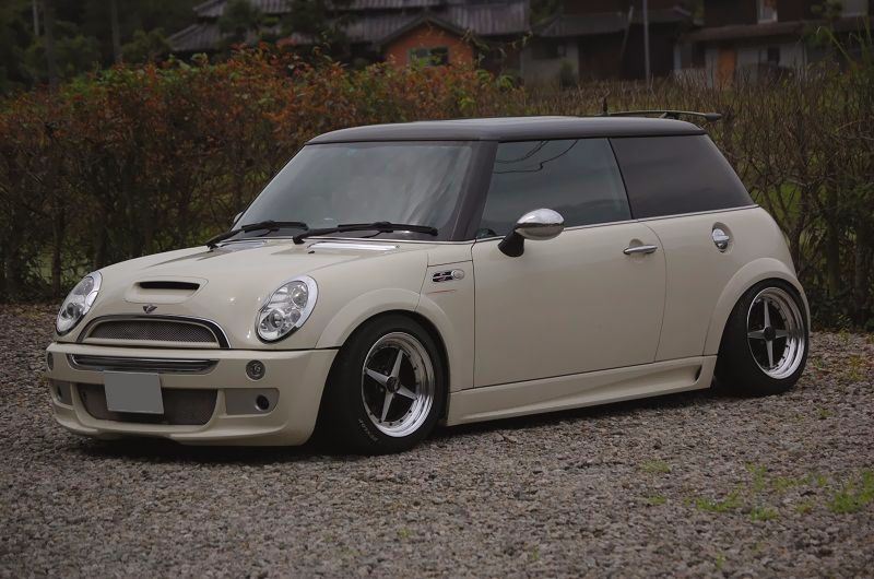

The 2nd time in that pic above, I almost bought a set just like those but found the ones I got on craigslist for a hell of a price and were brand new in the box still..
these were what I was planning on ( rotas)
Old Apr 16, 2020 | 06:04 PM
Oldboy Speedwell's Avatar
Oldboy Speedwell
Joined: Nov 2017
Posts: 1,947
Likes: 809
From: NW Georgia, USA
The Rota's are cool but I like the ones you got better.
Both are Work Equip designs tho.
Found an R53 with some of those 4 spokes fitted:
I like your style better.
