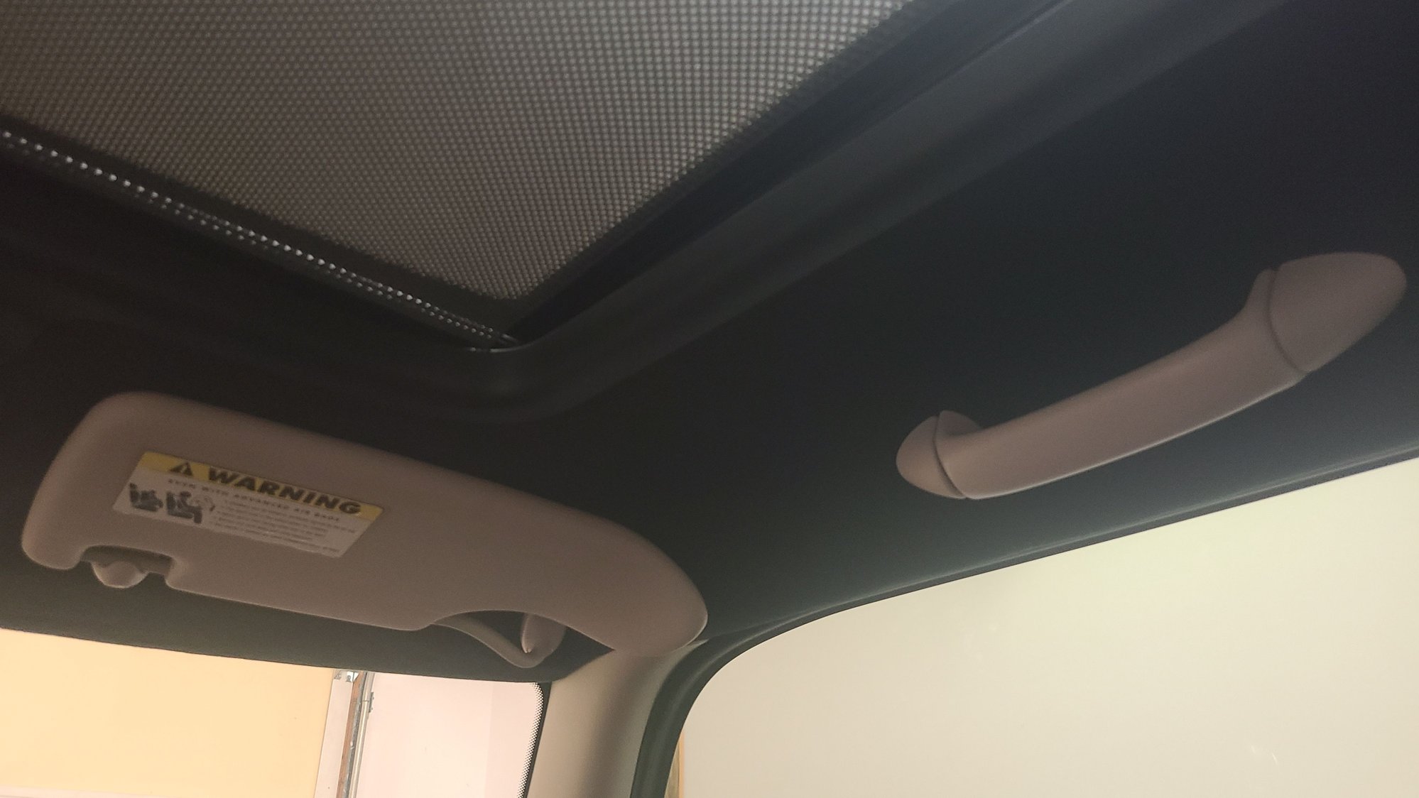

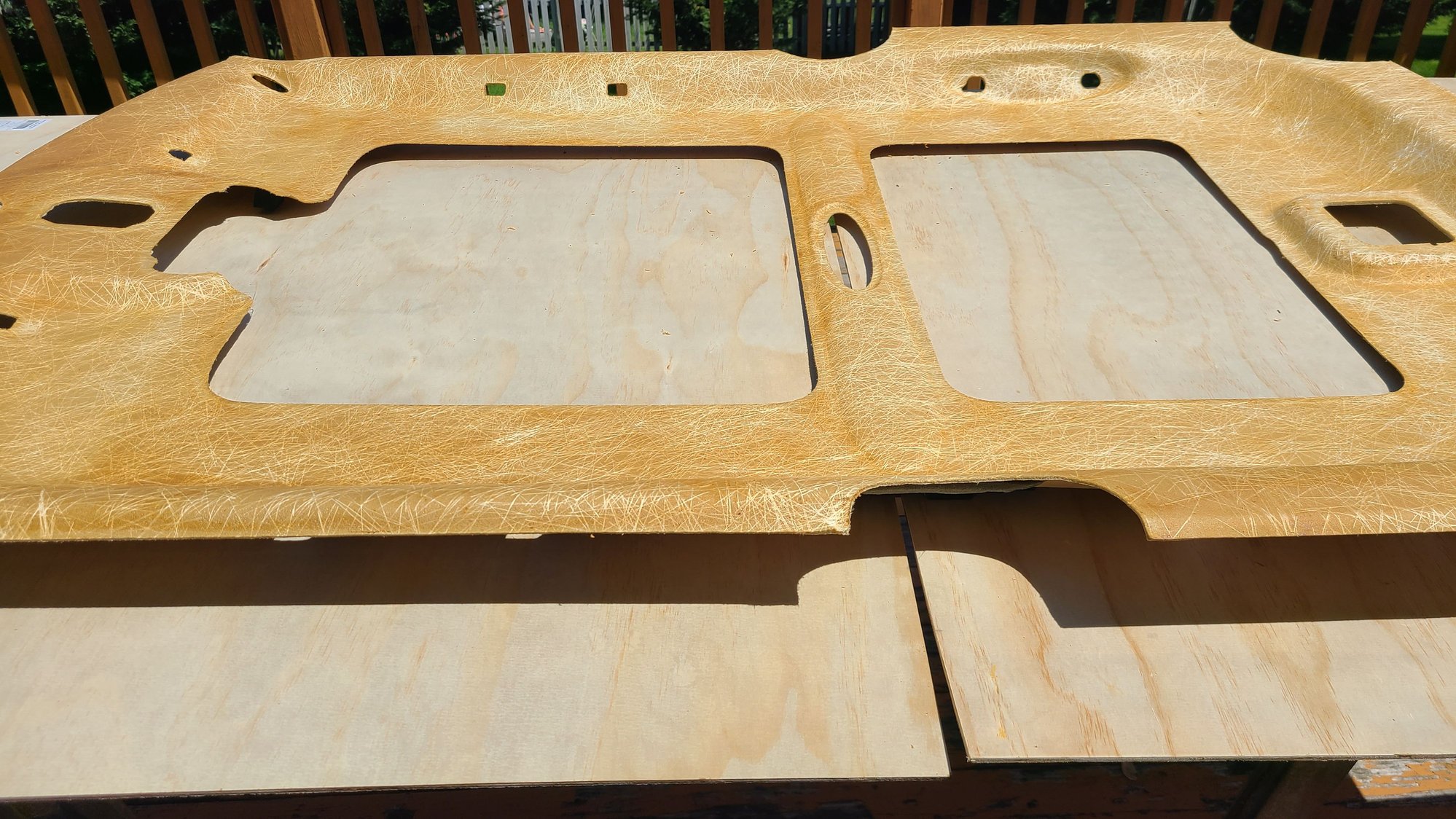

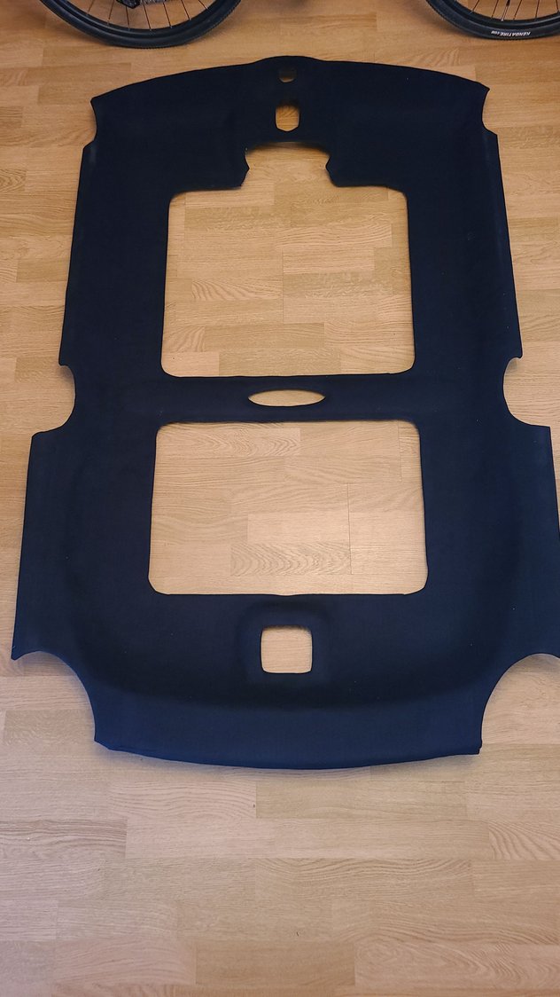

It's been a minute since I've been here, but had some medical stuff that needed my attention .Still have the 06 R53 and it was time to do the headliner. Did the usual prep. I used laquer thinner to get all the glue residue off and make it nice and clean. Hobby Lobby had a sale and I got three yards of black for $24. Got two cans of 3M headliner adhesive and I was good to go, or so I thought. First time around truly sucked.(see pic).It got some wrinkles and when I tried to get them out the project went down in flames. Back to HL, three more yards and $40 dollars later I had a covered headliner that came out much better. Went back in the car easier than getting it out. Getting everything back on took way longer than I thought it would. Didn't put the rear grab handles on since the MINI is a two seater(never cut the holes in the headliner for them). I'm happy with the results even thought it cost me an extra length of material..

Headliner looks good! I've done one without sunroof a couple of months ago and it's certainly not easy.

headliner looks great! nice work

Best advice I can give is go slow...I found that a thin plastic spackle knife helped with the weather strips.( 1+4 inch)…Prep is key. Make sure the backer is clean...Put plastic down on what ever surface you are using..Lay the liner on and make 8-10" folds towards the middle(I started with the back)I also covered the remaining fabric with cardboard(the part that's not folded up)I sprayed just enough adhesive across the middle between sun roofs and fastened it down, Worked my way up. alternating side to side doing short 8-10 inch sections. The cardboard on top keeps overspray from adhesive off of fabric. Repeat for the other half. .I did mine solo ,but I could see how help would have made it easier.
Trim it to about 1"...Then fold it over and glue it. I only cut out the sun roofs/lighting/mirror/and sun roof controls. It was easy enough to find were the other stuff goes by feel and just slit the fabric when the liner was installed. I thought Getting it back in was gonna suck but it went back in with little trouble. Pillar trims snapped back in no problem. It was a little fiddly getting all the trim pieces screwed back in , but it came out better than I had hoped....
The first time I did it I tried to glue too much at once and the results showed. Take your time and do small sections smoothing it out as you go..
