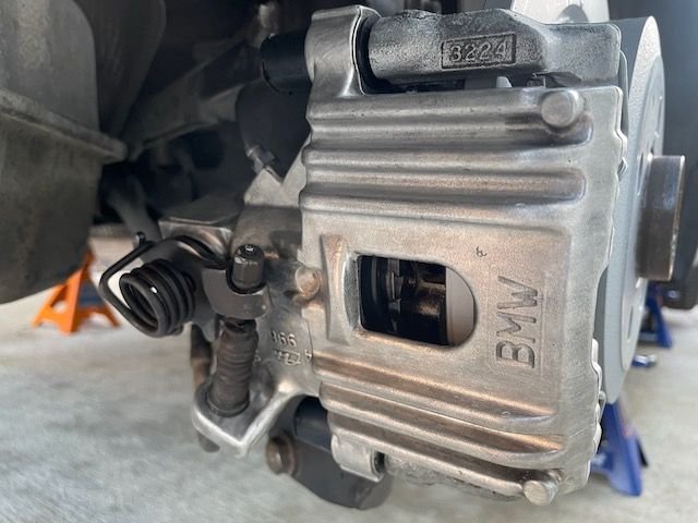

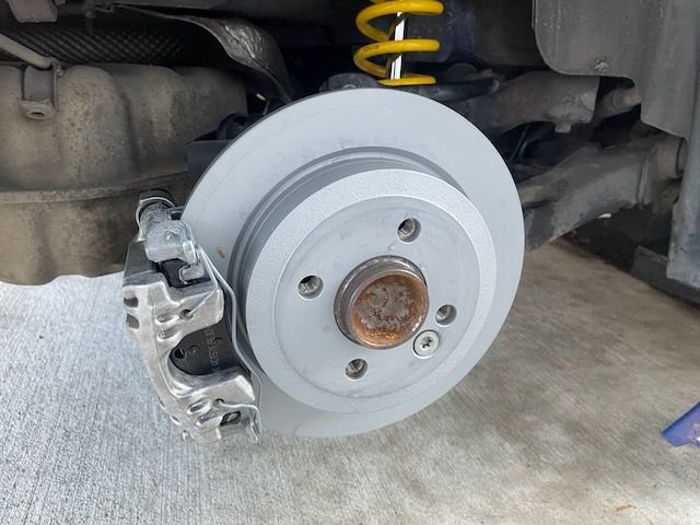

I finished the rears. I'll post some pics
one question for now. do the rear caliper pistons not have an o-ring? the rebuild kit did not come with one

Old Mar 24, 2025 | 07:52 PM

Good question - I never took mine completely apart. All I could see was the rubber boot around the pistons themselves.
Old Mar 25, 2025 | 08:19 AM
Posts: 36,768
Likes: 2,553
I have taken them apart and its pain to redo the seals. Also we dont have the seal on its own anymore ( it think people just swapped calipers). Just the dust cover, some people have matched up a seal they found.
Also i found the piston on the rear likes to corrode and stick. Both the caliper bore side and the piston itself. You cannot rebuild them if the bores are messed up and pitted with corrosion. I had to replace mine with new ATE rears. We have the bremmen part ones in now which i would have gotten if we had them at the time. Yours look pretty clean and might not be bad. The salt here killed mine.

Yea, we use to rebuild calipers (Seal Kit) back when I was earning my dosh by pulling wrench. But I have not been able to find such service kits for some time for standard calipers, it seems manufactures would rather have you just replace the assembly.
Pity you didn't upgrade your rubber lines to Stainless Braided, some really great quality hoses out there for about the same price as the OEM Rubber.
Looks great, nice clean up.

ok good to know. I expected the kit to come with an o-ring. nothing. I'll run these while the last
