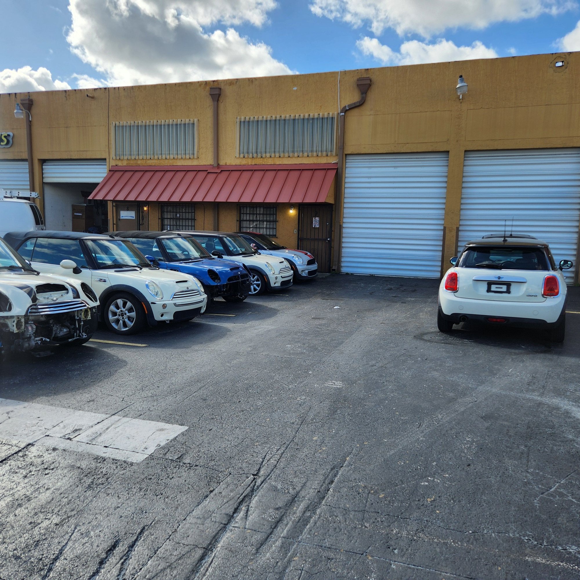

here is a little knowledge, 2006 automatic, original owner , 45k original miles , completely stock , look how dirty that oil was , and was already 2oz low .
