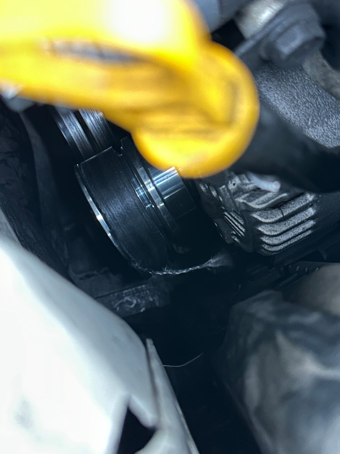

Belt shredded
So belt started to squeak, then I heard a “flapping” noise pulling out of a parking lot.
Pulled back in, saw this (picture below)
Belt has shifted/not aligned/hitting against something so I’ll be slapping another new one on. Any tips to avoid this happening again? Everything looked lined up when I did the alternator and a new belt a few days ago and there was no shift or wobble/wiggle in any of the pulleys down there.

Belt solved
I think…
Went down to pick up a new belt and I was looking up which one/size to get and make sure it’s right. I think this was my problem and why the belt lasted a couple days:
new belt on the left, “old” belt that was just put on, on the right.
The guy must’ve grabbed the wrong belt because I remember having this discussion and the belt number he showed me on the computer matched what I had from the list on detroittuned’s site. Didn’t even think to look at the label but ya live and ya learn.
At least this time I don’t have to take apart the front end and it should be a relatively quick and easy job.
