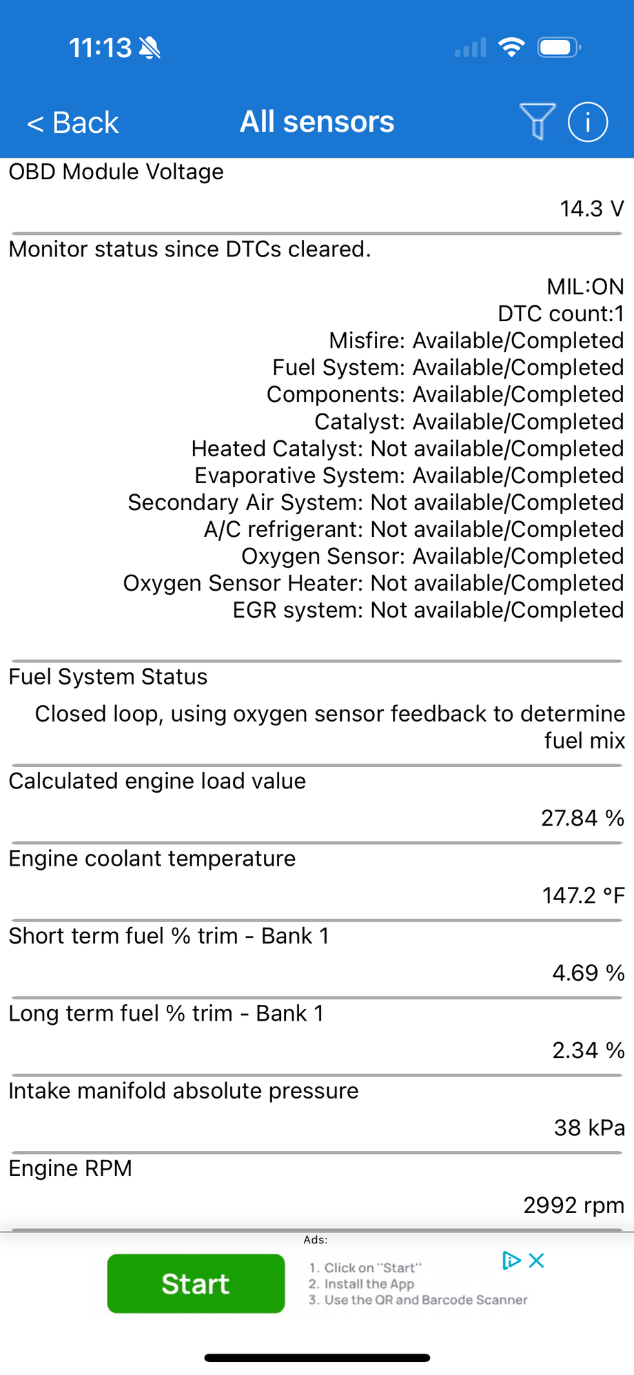

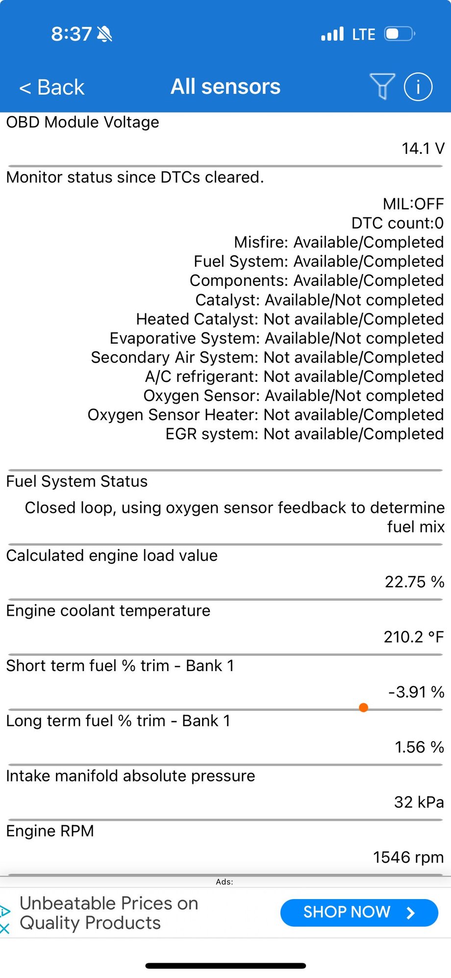

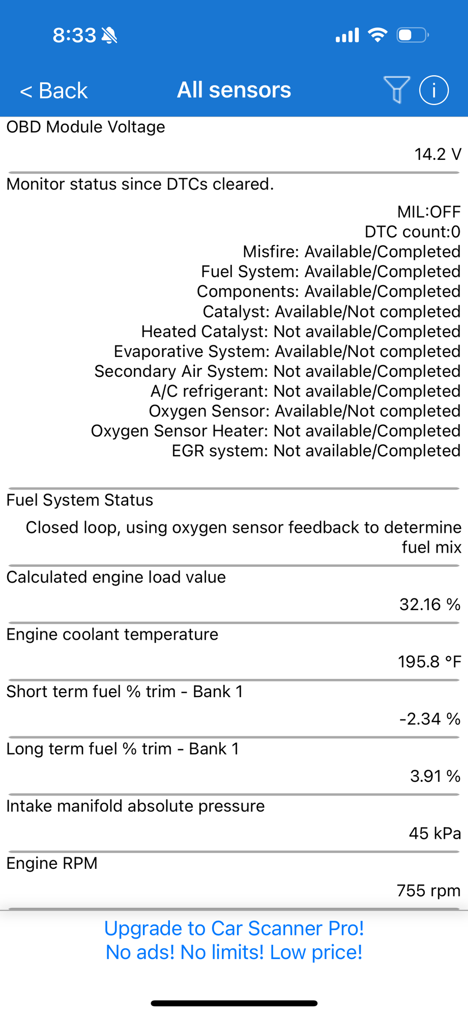

Thanks so much for the quick reply. Here are 3 screenshots of idle, 1500 and 3k (indicated in the screenshot).

Ok! Your total fuel trim at:
3000 RPM = 7%
1500 RPM = 7.6%
idle = 18.75
Total fuel trim acceptable range is -10% to 10% with zero being perfect.
Now what does all this fuel trim mumbo jumbo mean? Positive numbers mean the engine is running lean and the computer is calling for more fuel and it's driving the fuel injectors to be open for a longer period of time. Negative numbers mean the engine is running rich and the computer is calling to pull fuel away.
Base on the numbers you presented, I would imagine your misfire is occurring around idle RPM, and the first thing I would look for is a vacuum leak. I don't suspect the fuel pump low pressure situation because your fuel trim numbers look good at the higher RPM.

I also just notice your intake manifold pressure doesn't look right.
at 3000 you have 38 kPa
at 1500 you have 32 kPa
at idle it jumps to 44 kPa (it should be lower than the 32 kPa you had at 1500 RPM because at lower RPM there's more engine vacuum). This makes sense when combined with your fuel trim numbers as the higher 44 kPa number at idle is telling the computer there is more air flow than their actually is, so the computer asks for more fuel to get to the correct fuel/air ratio.
You may have a MAP sensor that's lying. Shoot me your VIN so I can look up your schematic.

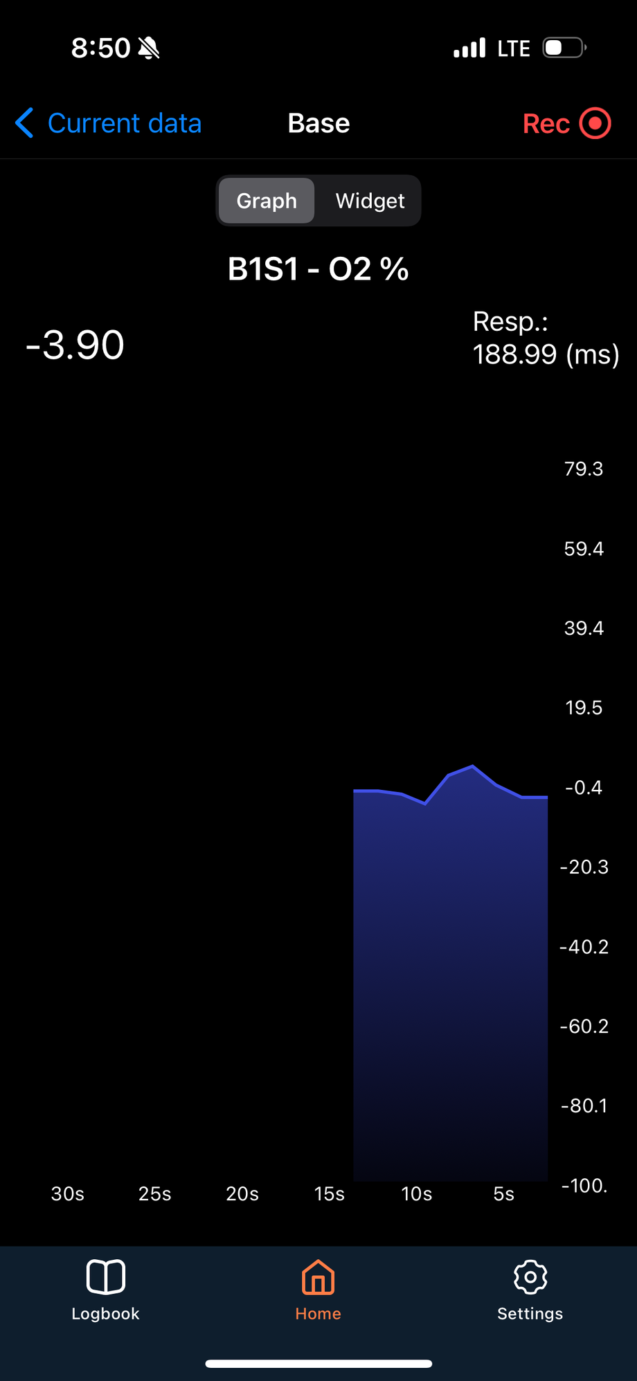

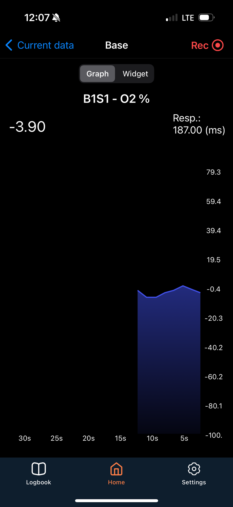

And here is the data you requested, I hope. I wasn’t sure which O2 sensor graph you wanted, but it seems Bank 1 Sensor 1 is what is relevant here? I captured % and V. Note- I’m not sure I did this right, the graph fluctuated a bit as I revved to 2k and tried to keep it there.
again, really appreciate your help on this!!

Well, it looks like your B1S1 O2 is switching, but it's switching slowly. You should see 1-5 cycles per second, and I'm seeing 1 cycle in 5 seconds. How many miles are on that O2 sensor? This could be a problem with the sensor or your tool depending on its sampling rate. Need your VIN.

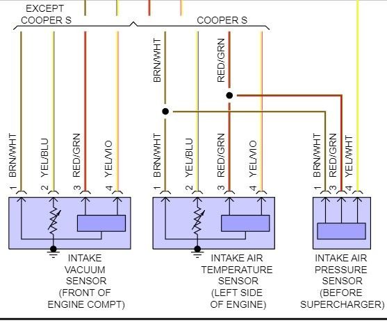

You would be correct. The justa MINI has a vacuum sensor; the S model has the TMAP. The schematic below applies to all R53 MINIs.

They’re all TMAPs. The R53 uses the R50 TMAP as just a MAP sensor. Same part number and everything. Not sure why it calls the R50 part just a vacuum sensor despite even having the temp sensor symbol in that diagram.
To be clear, the R53 has a second TMAP after the supercharger in addition to the TMAP that doesn’t report temperature (“MAP sensor”) to the DME (note how pin 2 on the rightmost component in that diagram is missing).
