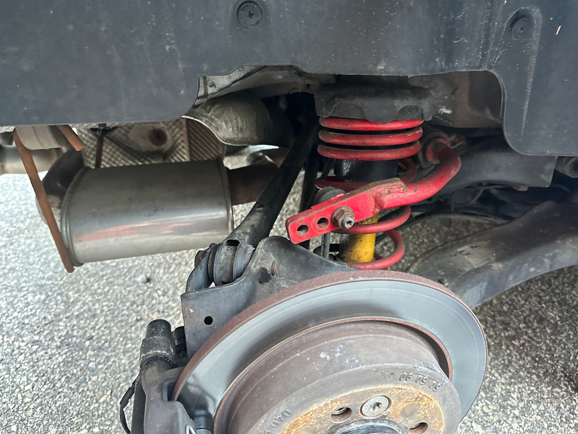

I still have the plastic radiator overflow tank. Any suggestion on an aluminum one?
I also need to raise the rear suspension. Currently on lowered Bilstein springs with Bilstein struts. Any recommendations for stock heights springs?
Have not installed them on this car yet but Bilstein B4 struts are stock height/ride and have a very good reputation for quality. Would go with those and an OEM quality stock spring replacement.
I was hoping I could just replace the spring to get the height back? Do I need to replace the struts too?

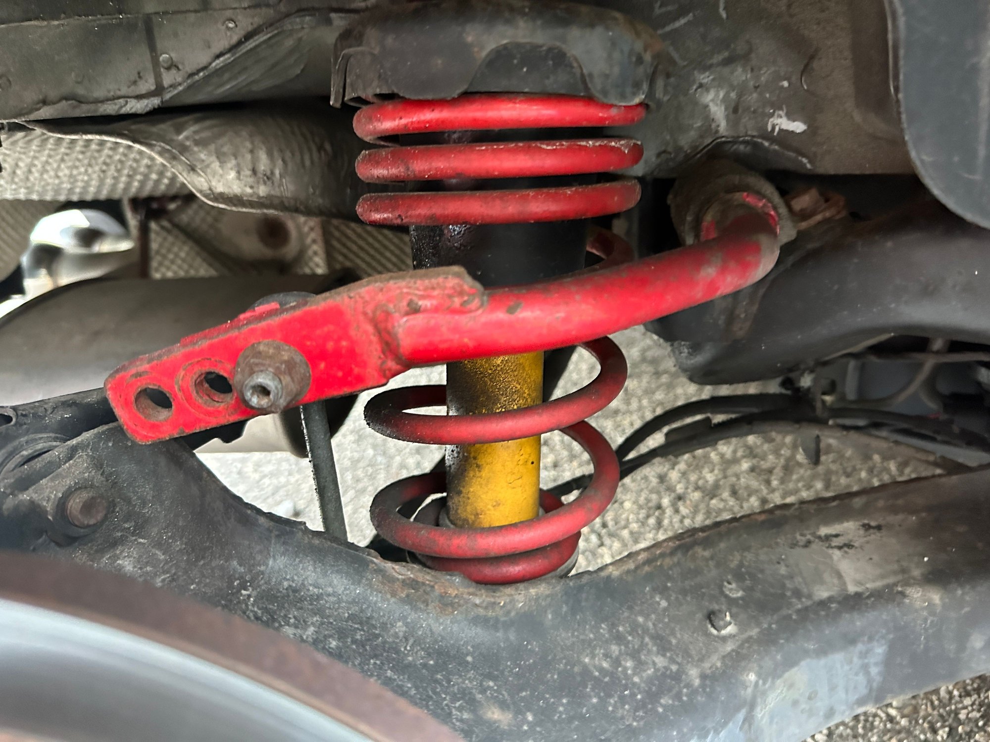

Anyone knows which Bilstein struts and springs these are?
Looks like B6 or B8 to me.

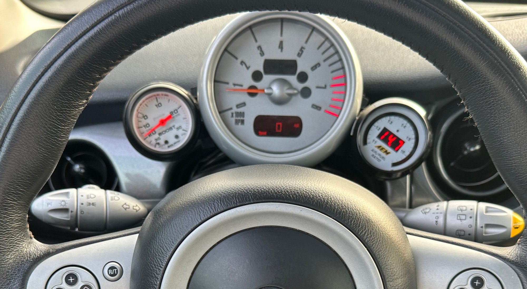

Also, more pics! I want to see how your gauges (boost and AFR) are mounted.
Thanks! I Will contact Bilstein to see I the spring can be swap for standard height.
I don’t know what parts was used, hope the picture helps.

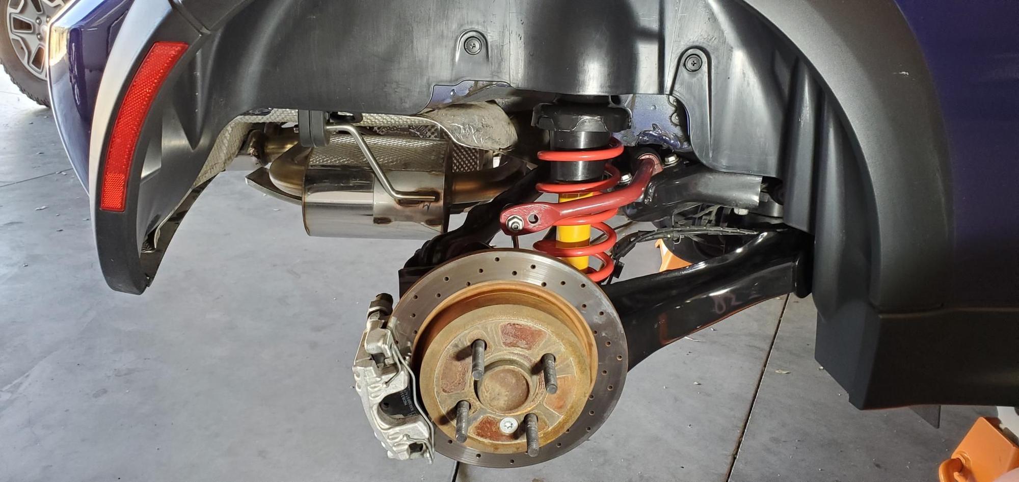

Unsure what springs those are but the circa 2006 Bilstein springs I removed were black. Whatever those are would concern me with apparent near coil binding going on at full suspension droop. Seems to me can't be much compression/rebound travel when on the ground. For comparison, below is the same RR corner with my Koni Yellows in comb with OEM JCW "reds" when I installed those:
