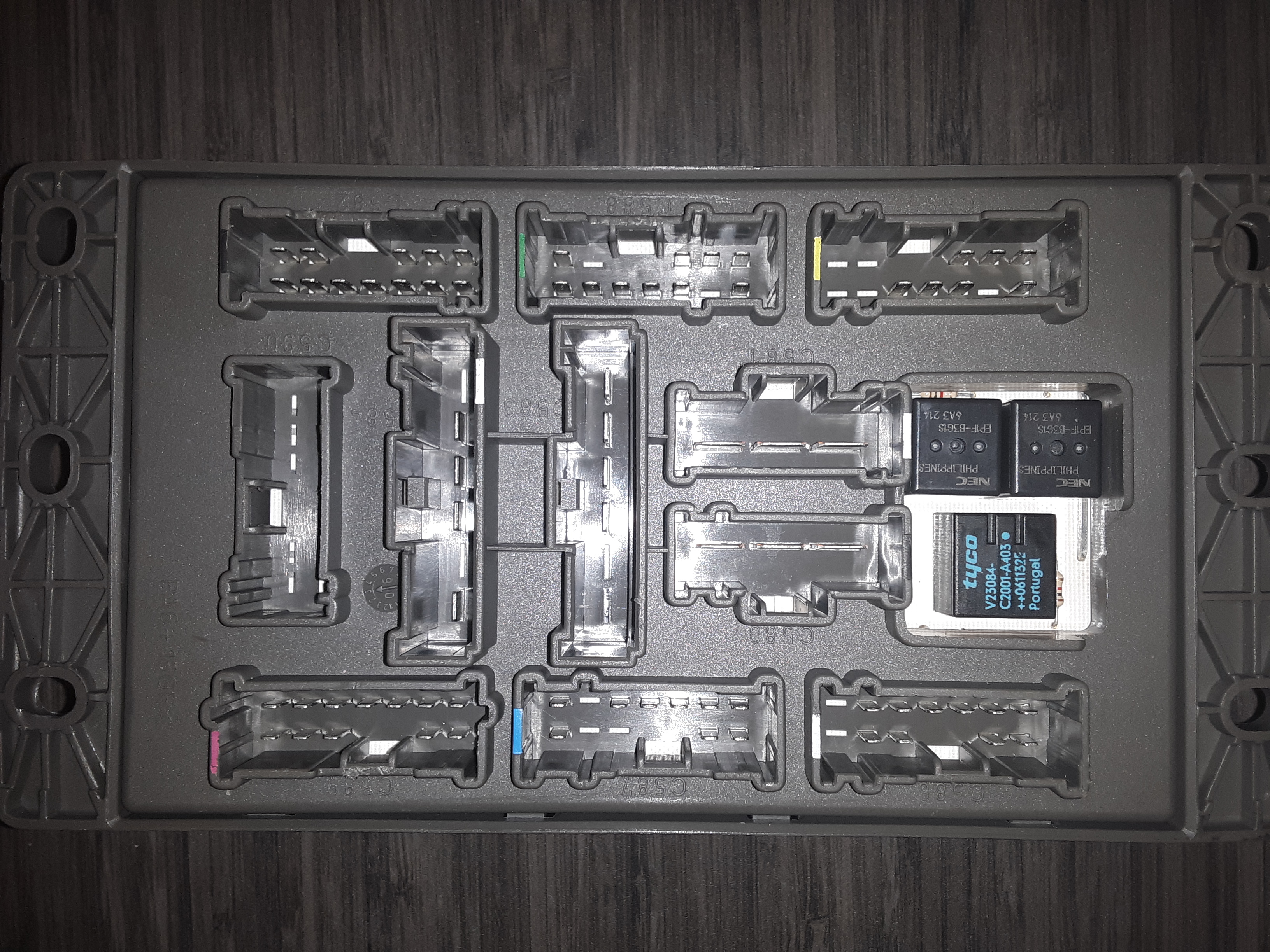

Small thing but the later cars from 9/2005 onward have a non-removable fuel pump relay which is soldered inside of the fuse panel on the driver (left) side footwell. Older cars have the traditional plug-and-play relay, readily available and easy to change out for well under $10. If it goes out (like mine did recently) on a late '05 or 06 car you need to swap out the whole fuse panel.
Probably worth sourcing one well in advance of need. New ones are unobtanium of course, so you'll need to go try a salvage yard or ebay to find one.
Guess that's a 'small thing' that can turn into a 'big thing' when it goes out, but forewarned is forearmed...good luck with your decision.
Yikes - the part can't be desoldered and replaced?
Theoretically yes, requires disassembly of the board, desoldering the old one and resoldering in a new one - which you'll need to source, naturally.
Attached Thumbnails Need help deciding 02-04 vs 05-06 R53-20230428_120135.jpg
