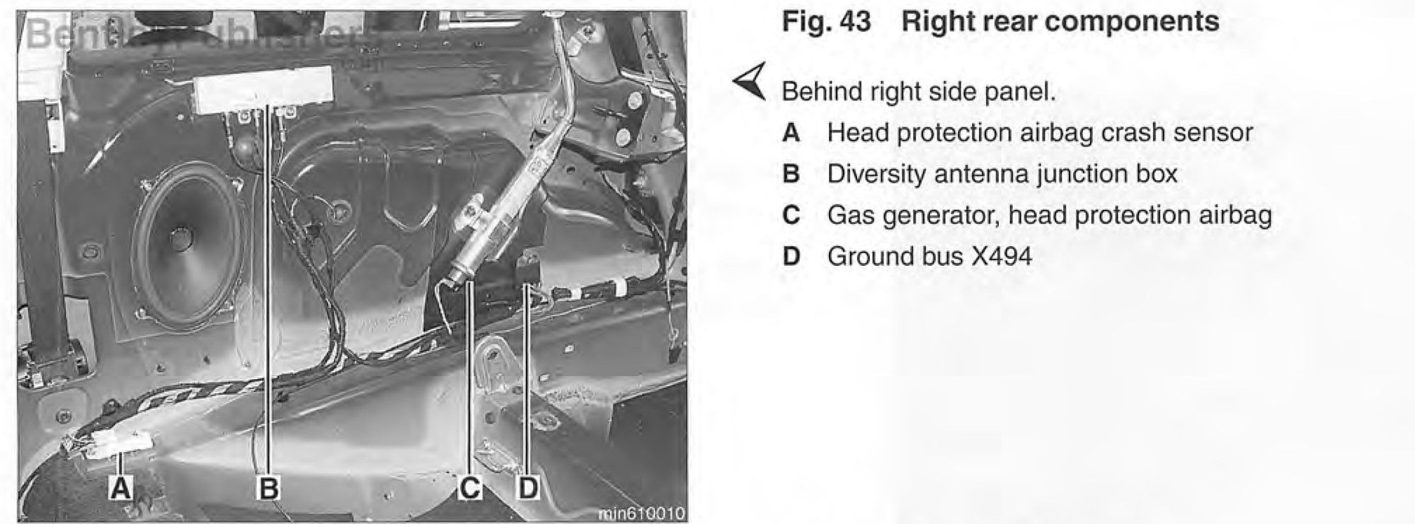

I got this from Bentley, where is the Pillar thing they talk about? This doesn't really agree with what the other poster on forum said I linked about the small sensor under the seat.

They're mounted next to the rear speakers, behind the big plastic panels. It's a real pain in the **** to get them.
There's also impact (pressure) sensors inside the front doors, I'm not sure which one your error is referring to.

Oh I see it in the Bentley under component locations:

Well guys, found the issue. Mechanical wire damage or mouse? Not sure. But pretty sure this is it. Thanks for help and hope this helps someone. There are two sensors in this location, one each side.
Sure looks like Mickey had lunch that day, guess he needed some copper in his diet.
