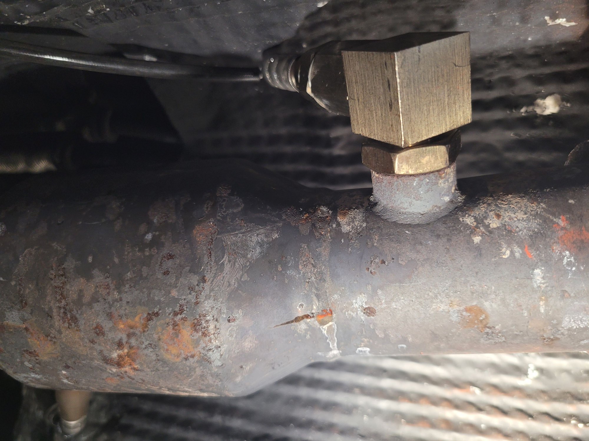

So long story short I've spent the past almost week just testing , data logging and reinstalling the rear 02 sensor and spacer until I found the EXACT combo to keep off the cel and have all emissions system monitors passed ( 02 related atleast )..
I'm running a ported facelift sc with 19% pulley , ported intercooler horns , ported sneedspeed intake Manifold, alta oversized intercooler, 10.2mm plug wires and step colder ngkR ,bmw 65mm tbody and 3in intake , 380cc injectors , facelift ecu with gp tune , Xforce catless headers and Milian non resonated exhaust AND NO CEL.
THE ONLY THING I FOUND THAT WORKS is the right angle 02 spacer with built in cat converter. In the pic mine is cut shorter as well as the mini cat because that was my test piece BUT you DONT NOT cut it.
you leave it asid BUT you must remove the mini cat by unscrewing the cap with plyers and you need to use a washer with the size hole i pictured below.. you place the washer ontop on the mini cat snd screw the cap back on. Then when you put the spacer in your exhaust you MUST screw it ALL the way in and have the 02 clocked so it's tip is facing downward, you will want it as vertical as you can get it without it interfering with the exhaust tunnel..
after you've installed it before you test drive YOU MUST reset your 02 sensor adaptions and short and long term fuel trims. That can easily be done via inpa , some handheld scanners via hard reset will reset everything but ive had little luck with them and the few that have worked were actually cheap ones , the expensive ones never seemed to work.
After you've reset everything go take it on a drive , DO NOT GO WIDE OPEN THROTTLE but do get abit heavy on the throttle and down shift too coming to stops periodically.. you must take it through city stop n go driving for 10min and then upto 55 mph and then 65mph or above each for atleast 5min and then city driving for 10min and back home. Once done driving let the car then idle for 2 or 3min only and then shut it off and completely remove the key and let it sit 10min. Then go drive it again and try and get upto 55mph or more asap and cruise it for a few min , if your cel IS STILL OFF your car has now tricked the 02 into thinking that a cats in place and the car is now running rite and not trying to compensate for the lean condition the rear 02 detects without a cat. if your cel came back on you for your combo may need to adjust the size opening of the washer ontop of the mini cat in the 02 spacer.
YES your car WILL run better without the p2270 or p2096 or p1036 codes which are associated with having a cat delete...
my car DID pass Wisconsin emissions in Milwaukee Co, so it's not like we have easy to pass emissions, they're pretty tightass about it..
Lol when i passed I popped my hood and the guys all started laughing and I told them my setup and there were ALL surprised it passed.. the test pipe fools them on the visual inspection..

I’ve never ever seen one with a catalyst in it. Did it come that way or did you combine two things?

it came with it..
I've tried numerous different types too like I pictured below , NONE of them were of any luck..

Here's how the 02 is clocked and setup in my exhaust.
