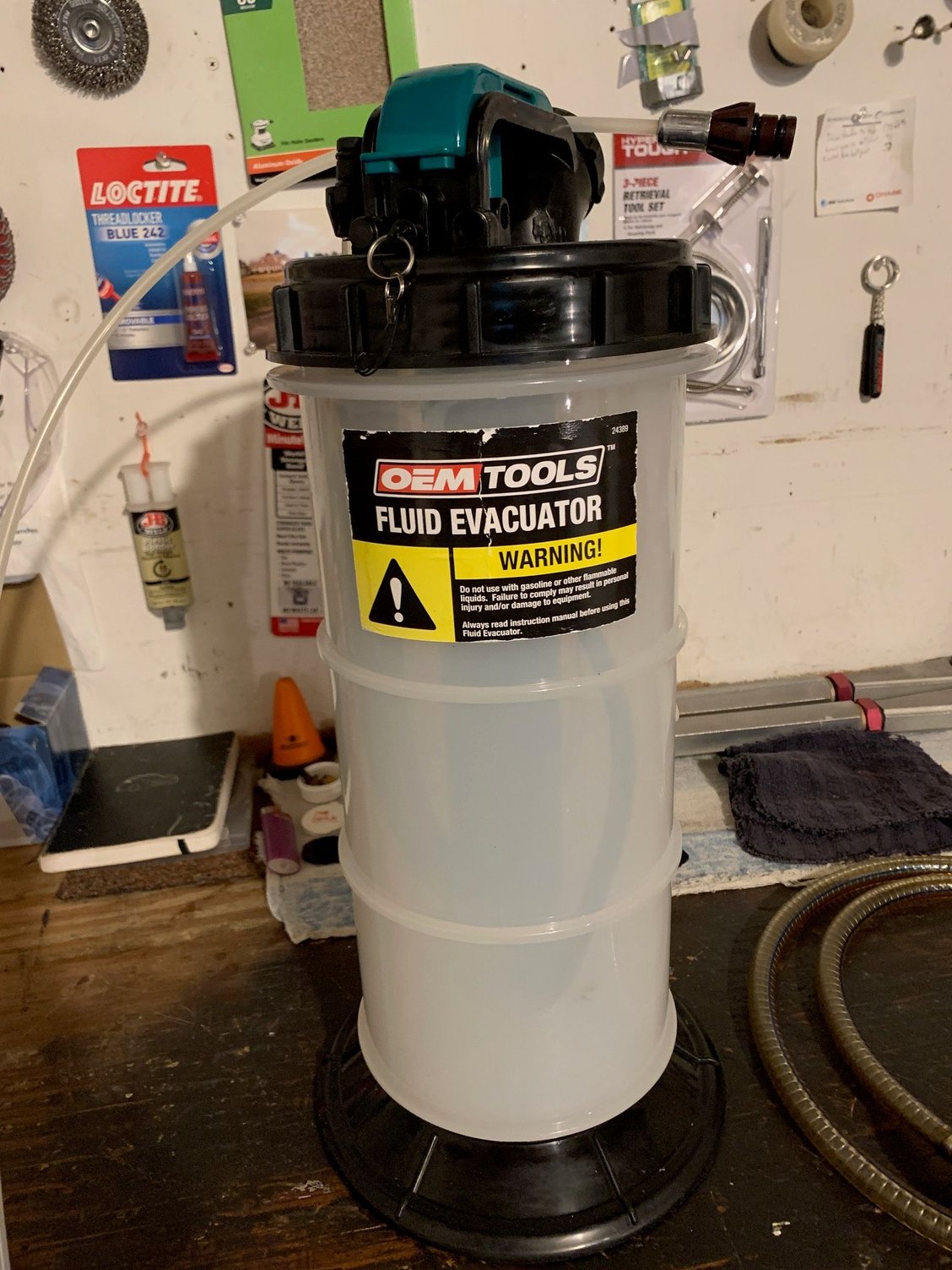

I find extracting oil vs. changing it much more efficient. Always warm the car up to full temp and then immediately start extracting. I make sure the oil cap is off from the valve cover and slowly unscrew the oil filter housing while the oil is being extracted till its loose but not off. During the last process, I will slightly lift the rear-end passenger side with a floor jack about 12 inches or so to to pool any small amount of oil in the pan. Once I hear the "sucking sound" of the extractor mixing air with the last of the oil, I know it's nearly done. Once it finished, its easy to see the 4 7/8 quarts of oil in the holding part of the extractor so I know I'm getting all but a few drops of oil out of the car.

Buggy- I have read your post before- Extractors do work. I have an old Topsider extractor I used on my boat years ago I may try. I also read the post where someone got the tube stuck in the dip stick line and that sound like no fun at all. The shape/bends of the tube make it a little scary. What is the OD of the line you stick down the tube ? .25" ?

Probably like many others here, I too watched Mod MINI's video on using the extractor pump vs oil pan drain method. Regardless, I chose to order a Fumoto valve which I'll install at the next oil change. I have one on my F150 6.2L and Jeep 3.6L and trust them.

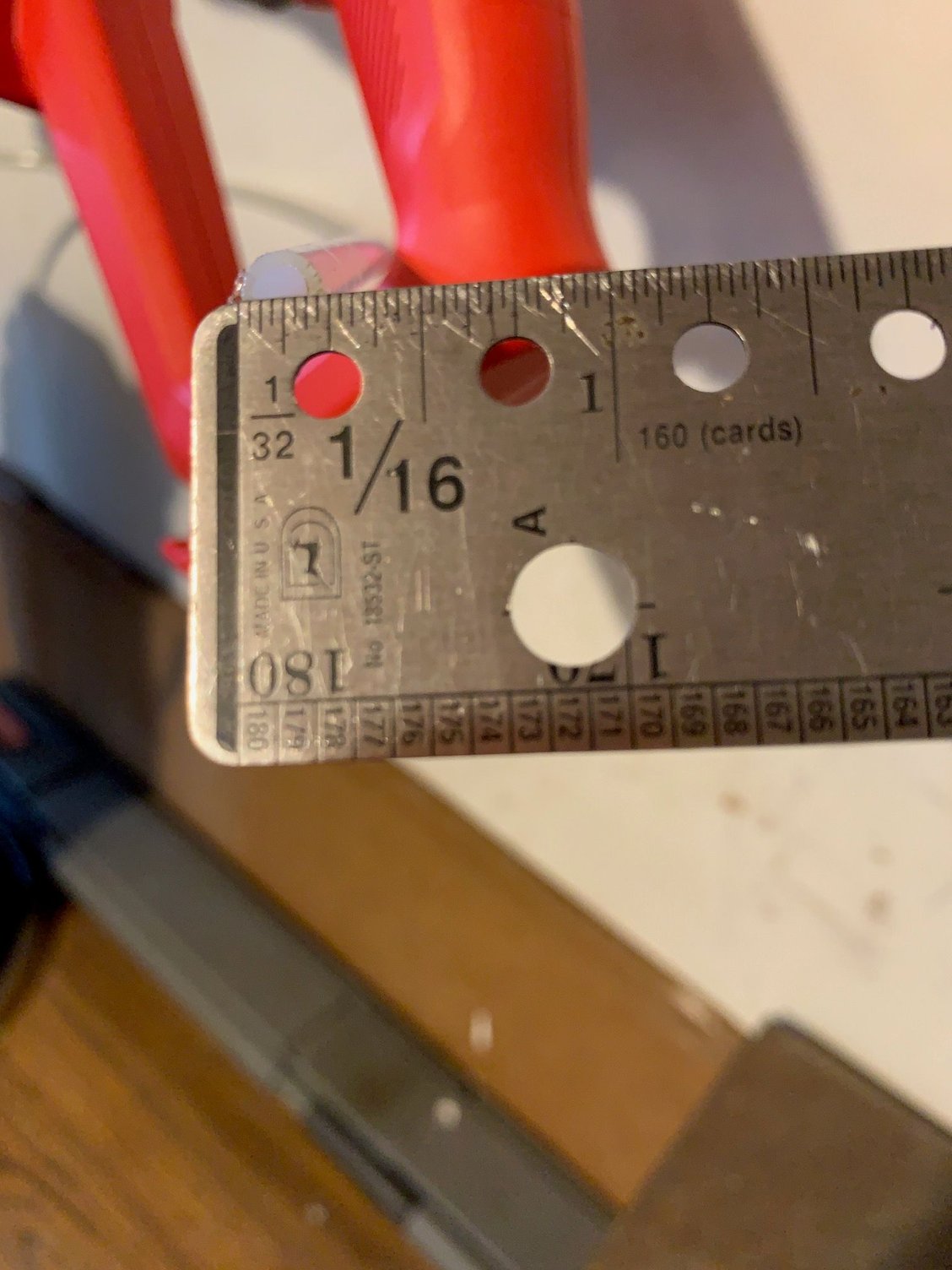

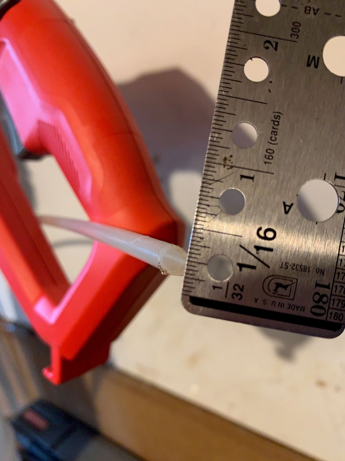

Yes extreme caution should be used when inserting any piece of equipment into a small space. Looks like the ID is 5/32" , OD perhaps 7/32". The plastic tip is "angled" cut. The tube goes in and out as easy as the original dipstick. Remember, everything is heated up initially and then immediate protocol of evacuation is started for ease of the maintenance and for sliding the "smaller sucking tube" into the depth of the lower oil pan.

Buggy- Thx for the measurements. You wrote: "The tube goes in and out as easy as the original dipstick" That is my worry, as my dip stick in the W11 engine is a little glitchy going in. The OD of my smallest tube is at .25" which you would think would not be an issue but still scary. I have looked for a slightly smaller diameter tube that still has enough backbone for insertion without any luck. I may be being too cautious but I'll work up the nerve one day.
