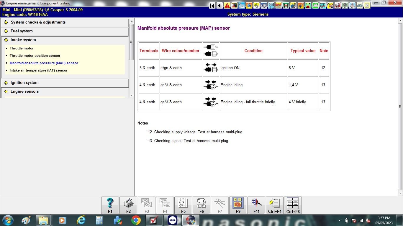

Old May 5, 2023 | 07:02 AM
adriancl's Avatar
adriancl
Joined: Apr 2013
Posts: 334
Likes: 186
From: Romania
rt=red
gn=green
ge=yellow
vi=violet
