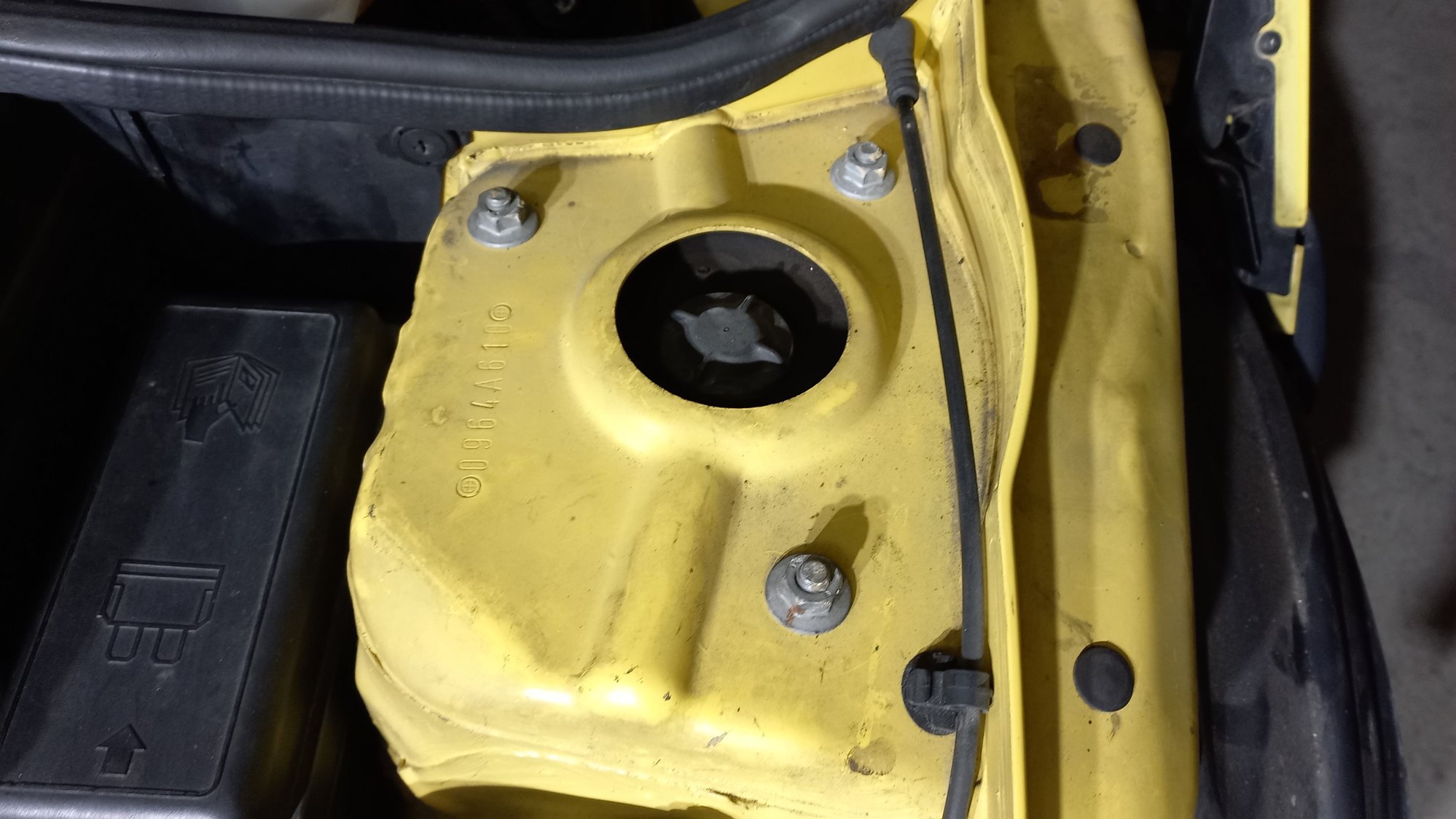

When I bought my 2002 Mini Cooper, I noticed one of the upper strut mounts was torn (all pictures below to avoid clutter). Not a lot, and it's not mushrooming, but definitely something to be replaced some day.

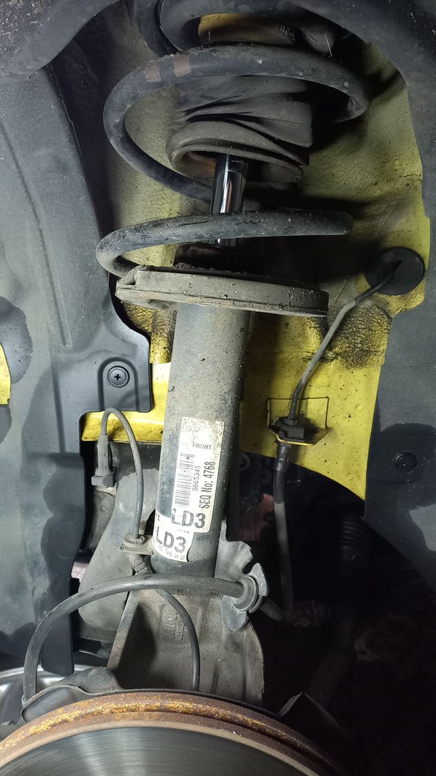

The other day I had the car on jackstands with wheels off (for a brake fluid change) and took a hard look at it. While all the suspension components are firm with absolutely no play, and all bearings look fine to me (except slightly worn front sway bar bushings), what caught my attention is the sticker on the shocks : "07.10.02".
So ... yeah. Front shocks have never been changed. There are no sticker on the back ones, but I'd bet they haven't been changed either. The car has 130k miles on it.
While the car pass the bounce test, on the other hand the suspension is super firm. At first I discarded that as "Mini have a harsh suspension", but I'm starting to believe it's just worn and in dire need of a refresh, especially coupled with the wheel gaps all over the place.

What started it all, the right-side top mount crack (technical inspection didn't notice it). It didn't evolve since I own the car, about 6 months and 2K miles.
Damaged front-left boot (technical inspection did notice it, though it didn't fail the car):
Vintage sticker
There seems to be a small dip where I point. Is it from factory or some damage?
Body roll might be because of worn front sway bar bushings? They seem to be starting to dry-rot at the bottom. Opposite side is in a similar state (photo is blurry, not included).

At that age and mileage, the struts are most likely toast; I replaced mine at 64k, though I did live in a city that is notoriously harsh on suspensions. You'll probably also want to change all four strut mounts and sway bar bushings, and if the LCA bushings haven't been done, it'll need those, too. Obviously check tie rods, ball joints, trailing arm bushings, etc. at the same time.
The springs are under very little force. You can actually pop the assembly apart without a spring compressor, though I wouldn't necessarily recommend it, and you'll need a spring compressor to put them back together anyway. The inexpensive ones that use threaded rods are fine.
Do remember that the R50 without the sport plus suspension option (is that the case here?) always had more body roll than the R53. You might consider going to a larger rear sway bar and upgrading the front to the r53 bar if it only has the standard sport suspension. I'm still running the stock sport suspension front bar on my car with an oversized rear bar, but I'm not running stock struts or springs.

  • New strut tops (especially since the front has failed)
