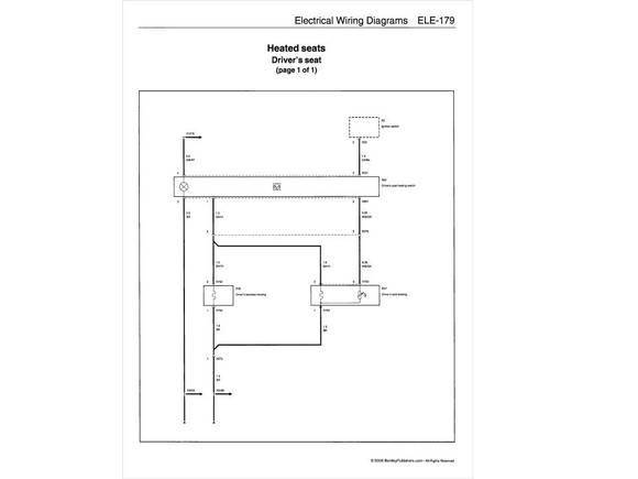

Does anyone have a full wiring diagram of the seat heater circuit ? (if your could post up or provide link … that would be much appreciated)
Are they controlled by a module or are the switches only controlling relays ?

These were sent to me by @jcolletteiii

Thank you (Both) !!

Any chance you can post higher resolution images... a bit too fuzzy to read the call-outs.

U should message @jcolletteiii directly. I don’t have the original images.
and I saw a partial seat harness on eBay with the air bag plug and the wiring and plug that plugs into the seat heater.
it’s listed as available from Way Motor Works. If he has one, he might have two. It won’t fix all your challenges, but it will show you which wires go from the switch to the seat. You can then work backwards to see which of the other wires going into the switch need power and ground
