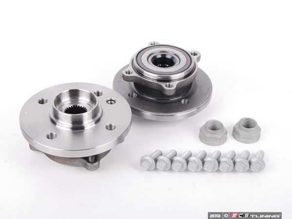

All i can think of is the back of the bearing is bad on the ring tone, thats were the bearing first rusts. How new are the wheel bearings?
Does ECS sell these bearings ? Thanks
Old Jan 10, 2023 | 08:52 AM
Posts: 36,759
Likes: 2,548
Yea, whole bearing/hub. 7/2006 is the switch over from M12 to M14. So thats the split year on the bearings. So watch out for that. I Just did all four on my old R52 since i was rebuilding the whole underside.
https://www.northamericanmotoring.co...ed-sensor.html
When you refer to the switch from M12 to M14 ; is that the lugs bolts? Thanks
Old Jan 10, 2023 | 10:26 AM
Posts: 36,759
Likes: 2,548
Yes 100% that's the difference in the hub bearing from Gen 1 split years.
Not new just didnt feel any play or abnormal amount of corrosion on them. Buy I believe you hit it on the head with the bad tone rings.. because my abs dummy lights will periodically be off when I 1st start the car , then it starts rolling and then after a short distance the dummy lights come back on , like the sensors can't read correctly...actually had this same issue in an impala ss I'd owned awhile back.
also thx for reminding me about the bolt size change in the years , because i planned on ordering new hubs , 7mm hubcentric spacers and extended lugs..
Old Jan 13, 2023 | 12:16 PM
Posts: 36,759
Likes: 2,548
Yep no problem, i think i have done like 8 wheel bearings on MINIs in the last 5 years...lol I have seen it all.
