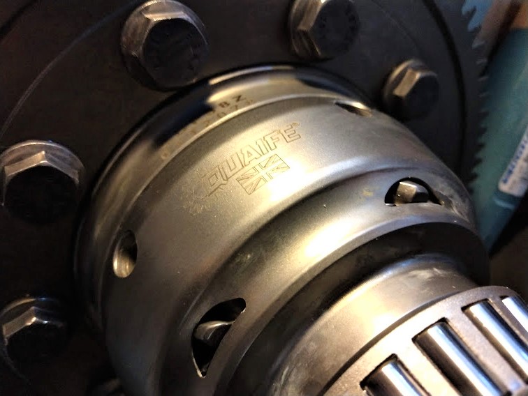

It was $500 as an option when new, but I haven't been able to find a separate part number for it,
does it have a part number?
All I could find is the entire gearbox # 23007574848 for around $4,000 from the dealer.
I did a Quaife in mine at 140,000 miles, which replaced the factory GKN SuperLSD...
...if you're interested in my used factory unit,
I'd sell it.
