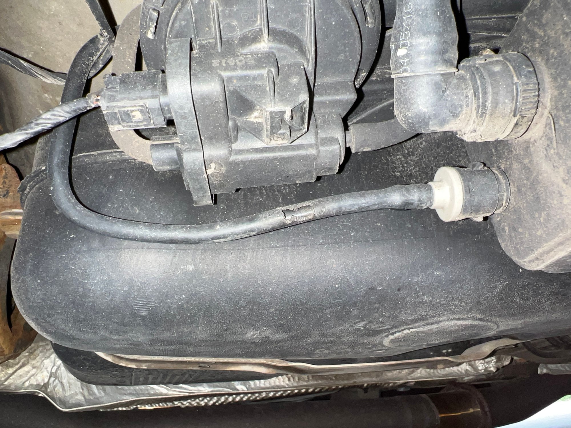

Hello all, i just noticed a hole in a hard plastic hose under the rear right side of my 2005 MCS. I have had a small evap leak and wonder if this may be the cause, and would like to know so i can order a new one. thanks in advance!

Start with realoem.com
Find the part number. Looks like you may need to drop the gas tank to replace that line.

Cut section out patch with hose profit. Not a high pressure line at all. 10 minutes and done with crap likely in garage already.
