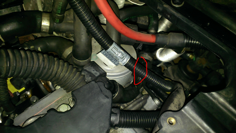

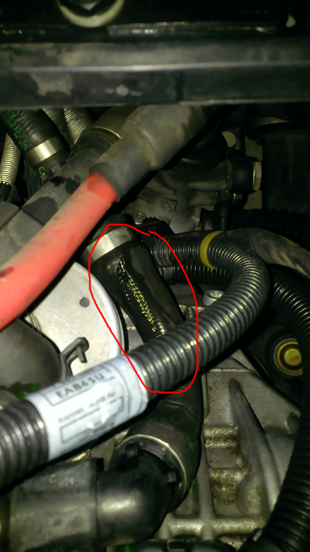

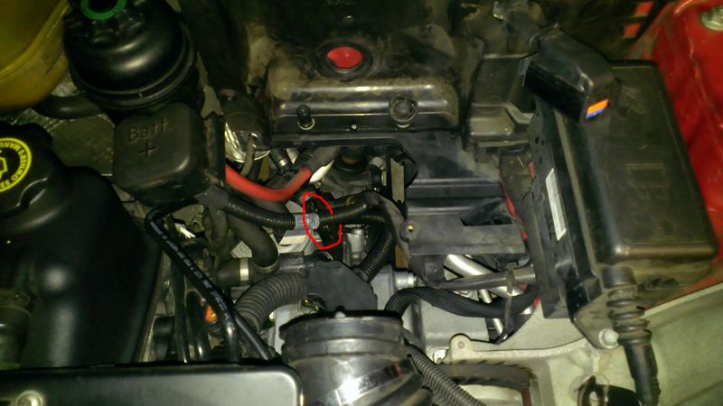

Can anyone help me identify this item? I finally figured out which item that could be causing my MINI to leak. I was told by dealership it was my thermostat and radiator but this is nowhere near what they're saying, I think this has something to do with heating and cooling...
Also any recommendations of where to get this part that needs to be fixed that's better even if it's aftermarket?
Sincerest appreciation to any help received.
Here is the parts break down that might help. From your pic the hose looks like it is expanding and is leaking at the clamps.

It seems that diagram is for the manual transmission, I kind of wish I have gotten that instead, but I have the auto transmission. The closest I could find for the part that's broken is actually part of this assembly.
http://new.minimania.com/part/NME865...S-W-auto-Trans
Is this possible to find in another form or be bought by parts? It looks like some of those hoses should be permanent but I could be wrong.

If my memory serves me right, I remember that an 05-06 MCSa coolant hose assembly is only 1 piece with about 5 different connections. I dont think you can just get that small piece of hose that you found damaged.
Thanks, SRICHS is correct, for automatics especially, this part is a whole assembly. Wish there's an upgrade version sold online but for now found a solution acceptable to fix this. Keeping an eye on my temperature and my coolant level for now in case anything happens.
if you are auto savvy I think you can make a patch for this - or maybe I should call it a splice.
It appears to be leaking at one end. I'd back up a few inches from this point and cut the hose. Remove and discard the swollen end. Cut a short piece of new hose, same size and attach with a hose clamp. Get a short piece of copper tube to match inside diameter of the rubber pieces. Slide this into the two ends of rubber hose and secure with a pair of hose clamps. You will loose a little interior diameter but I doubt it will matter. This patch should cost about $10.
Think "garden hose patch kit"
if you still can't visualize PM me and I'll give you pictures of a similar splice I did on my 79 - classics have some ugly, complicated hoses too.
If too close to a bend, consider cutting back farther and bending the copper tube to fit the bend.
Worst case is it leaks and you decide you still need the new hose. You're out around $10.
@Capt_bj
I apologize for bringing this one up from the grave but just responding back
My dad did just that... sort of... the hose that was broken was held by a metal ring that doesn't seem to be removable so he had to surgically saw it off since it is clamped or held to a plastic tube. Manage to replace the specific hose alone and used a much thicker (yet still flexible hose) to replace. Used regular screw-in clamp to seal it back in. So every time I do my maintenance, I'll have to make sure nothing is getting loose over time. Temp has been acceptable, but the best part is no more leaks.
