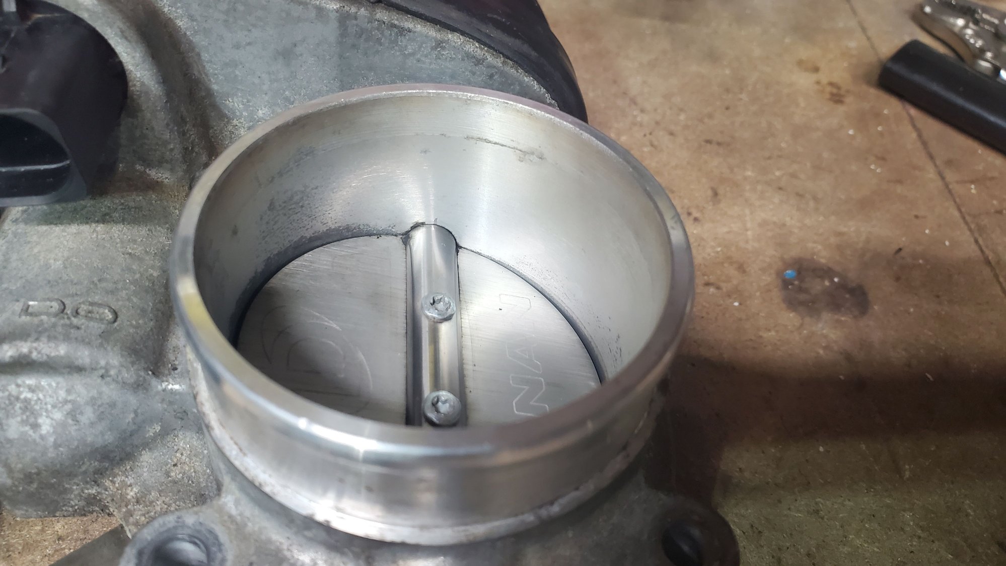

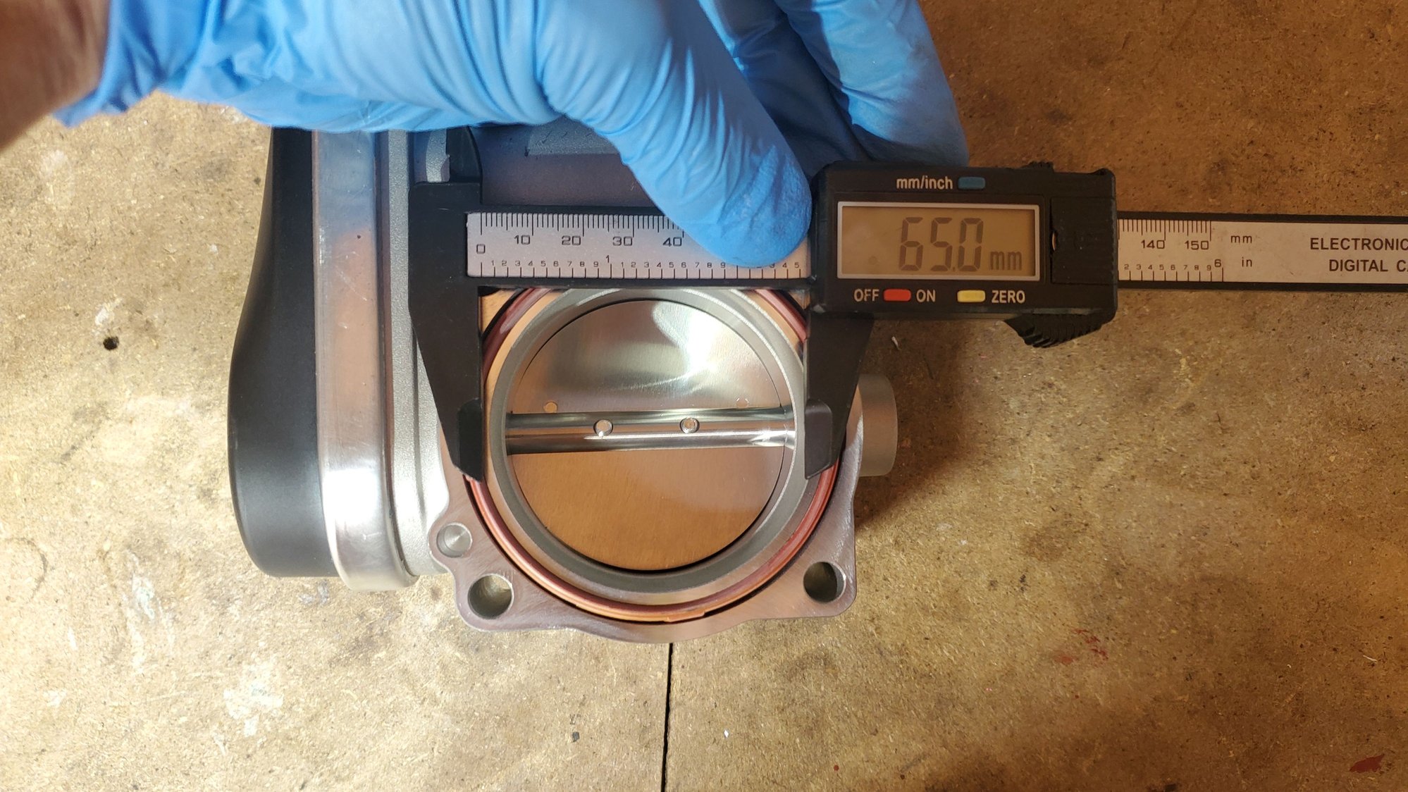

Sooo I decided to port my Dinan throttlebody now and then test it..I was able to port it out to 65mm..
I feel like the Dinan now breaths much better up end but again it did sacrifice a little low end.. so my opinion on the ported Dinan vs the ported v12 throttlebody IS one IS NOT better than the other..my Dinan now performs just like the oem non ported v12 throttlebody but does not flow as much up top as the ported v12 throttlebody does..
but the Dinan vs ported v12 once again , the ported v12 just provides a better upper end above 4000rpm but below that I feel like the Dinan is outperforming the ported v12 throttlebody.
sooooooo , where I drive my car mostly ( 30mph-60mph) im probably just going to stick with my ported Dinan as I don't do alot of freeway driving or highway n stuff where I'd benefit more from the ported v12 throttlebody..
here's the Dinan before(2.4xxin so like 61mm) and after porting and a pic of the ported v12 throttlebody before I swapped them around..
