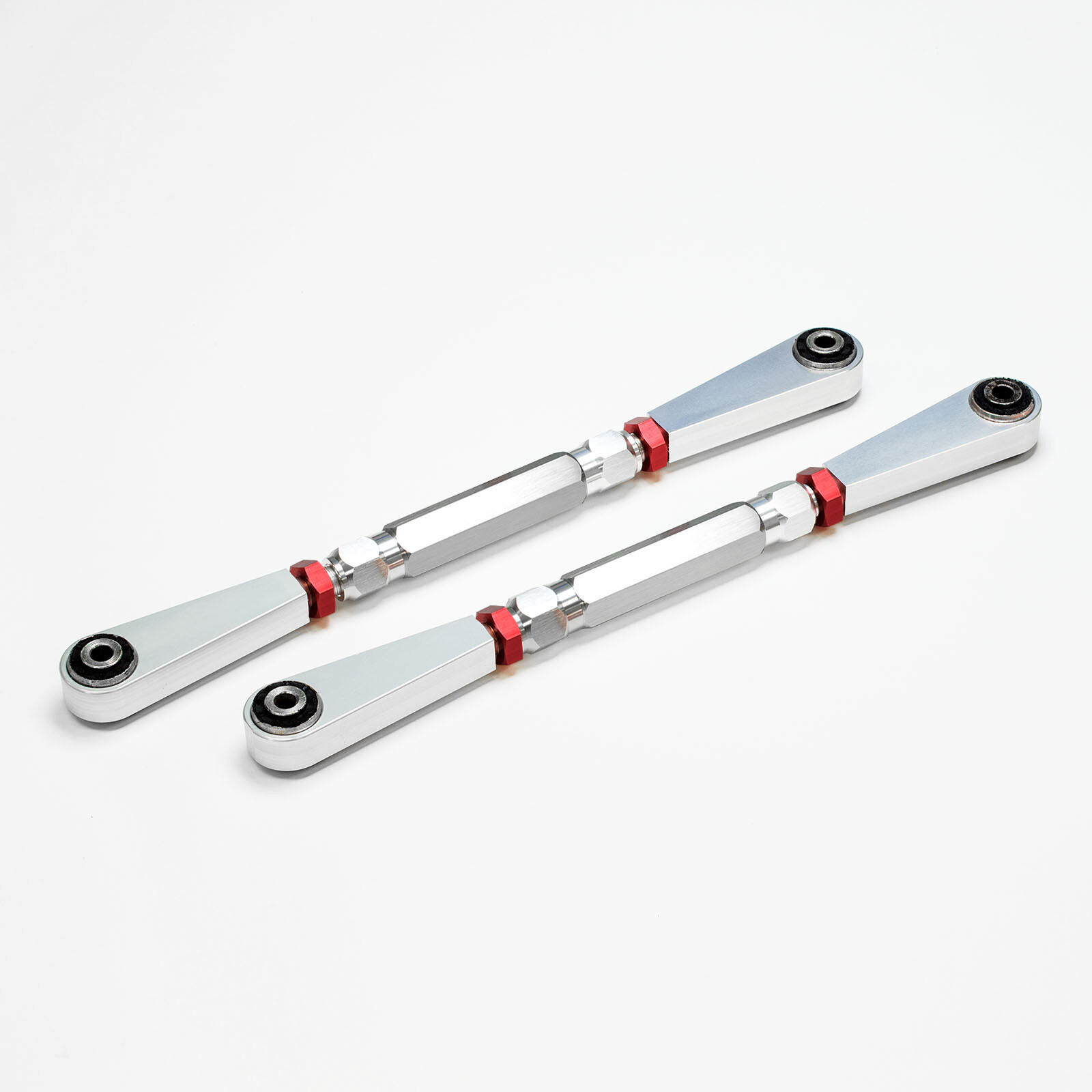

I have/bought/installed those same rear adjustable control arms on my pre-facelift '04 R53.
I like them.
My Mini is not lowered and drove fine. My original OEM (@86k) were in perfect condition and really didn't need replacing. However, It seemed that the Left/driver rear wheel camber was slightly more negative than the Right.
After replacing/upgrading all 4 struts/shocks, SB links and bushings; The LR camber was still noticeably negative. I'm glad I had purchased these adjustables months before and was able to get my camber/alignment sorted out.
BTW: I have absolutely 0 rust on my car but the biggest PIA is unbolting the upper control arm nuts. There is almost no space to get a socket or spanner in there. I used a swivel joint. It was pretty frustrating but once the angle was figured out the second one was easier.

I'm in the rust belt so YMMV. I gotta ask, were the bushes in those alloy arms rubber or pillowball? I can't quite tell from the pictures. Mine's a street car so don't really want pillow ball joints.

I'll be completely honest with you - I don't know. They are Dorman brand.
Nothing was mentioned about the bushing; whether Pillow ball or Rubber, on the Amazon listing.
Although, I can tell you that the rubber was impressively hard and fixed. They don't pivot or "roll". I suspect they are solid Rubber. I compared them to my (18yr/o), OEM and the bushings appeared to be of the same type/construction.
After torquing down the upper before mounting the lower, (perhaps a bad idea...?), to the wheel - It took a tremendous amount of effort to pull the control arm into alignment to the wheel. It can be one tough monkey.
I went back - loosened up the upper, bolted the lower, then went back and torqued to specs (80ft lbs).

I love my ebay adjustable rear control arms..I ran them with stock suspension and now my coilovers and when I had an alignment done they did end up adjusting them to get my car better planted for cornering..I highly highly suggest getting them..

Dorman Rear Adjstable Control Arms
Originally Posted by mini_me123
edit: cancelled order, doorman has correct image for these and they're just OEM
EDIT: Hold on!!! - The link I posted below now indicates NON ADJUSTABLE but clearly shows the adjustable arm that I ordered almost a year ago.
The correct Dorman RAC product # I received is
522-058 522-058
Currently unavailable on
Amazon Amazon
Sorry.
Originally posted:
I ordered my pair of Dorman off
Amazon Amazon
a little more $$ than your link).
They are not stamped "steel". They are listed as Aluminum and are surprisingly light weight.
Hoping you receive what you want. I think they are well worth the price be it steel or otherwise

Can you confirm through your orders? the 980 is stamped steel allegedly. The 979 (link below) is adjustable steel. This is the official doorman amazon store so it's frustrating that they have the wrong image. Their website shows stamped steel for the 980 but adjustable for the 979 (link also below). They also have the alloy models but I can't find a bargain for those.
https://www.amazon.com/-/es/526-979-...language=en_US
https://www.dormanproducts.com/gsear...=control%20arm
Yeah you are correct. They are truly messed up!
See my edited reply above your/this post. I was scrambling to link you to the right product just to discover what you already went through.
However; Here is the link (Amazon) to the CORRECT product I ordered and received #522-058
....Although, unfortunately it is currently unavailable:
Dorman 522-058 Suspension Control Arm Compatible with Select Mini Models Dorman 522-058 Suspension Control Arm Compatible with Select Mini Models

I can double confirm as I put these on my kid's car back in 2017. They work fine and for a street car, they are totally fine.
It does, however, as pointed out earlier to be out of stock on Amazon and everywhere else. Might want to look for some other options out there if you need them now.
