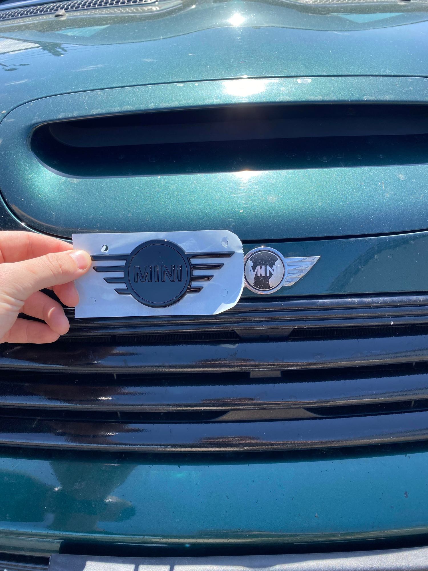

So here are some pics for reference- this is what I mean. The badge will definitely go over the crack to the scoop/the grill.....I'd rather it just fit between and not overlap at all which is why I don't like it. So do people just let it overlap? Do you have any example pics you could show me? But yes just getting OEM and painting black might be the move... Plus I don't want to have chrome front and back but then black "cooper s" I'd want it all to match ofc

Yep, they overlap it bit as they want an Genuine MINI badge as some of the the aftermarket ones dont have the quality. We had some MINIs at our last cars and coffee that did the swap. If you think its too big for your liking you can return it. On the Cooper its fine, on the S/JCW on the front you don't have a lot of room.

Ahhhhh yes. Definitely don't want it to overlap so I will just be returning then. Please add in your description that for an S/jcw it will overlap just so future customers will know I'm sure there are others like me who are drawn in by the black but would want a flush fit.
