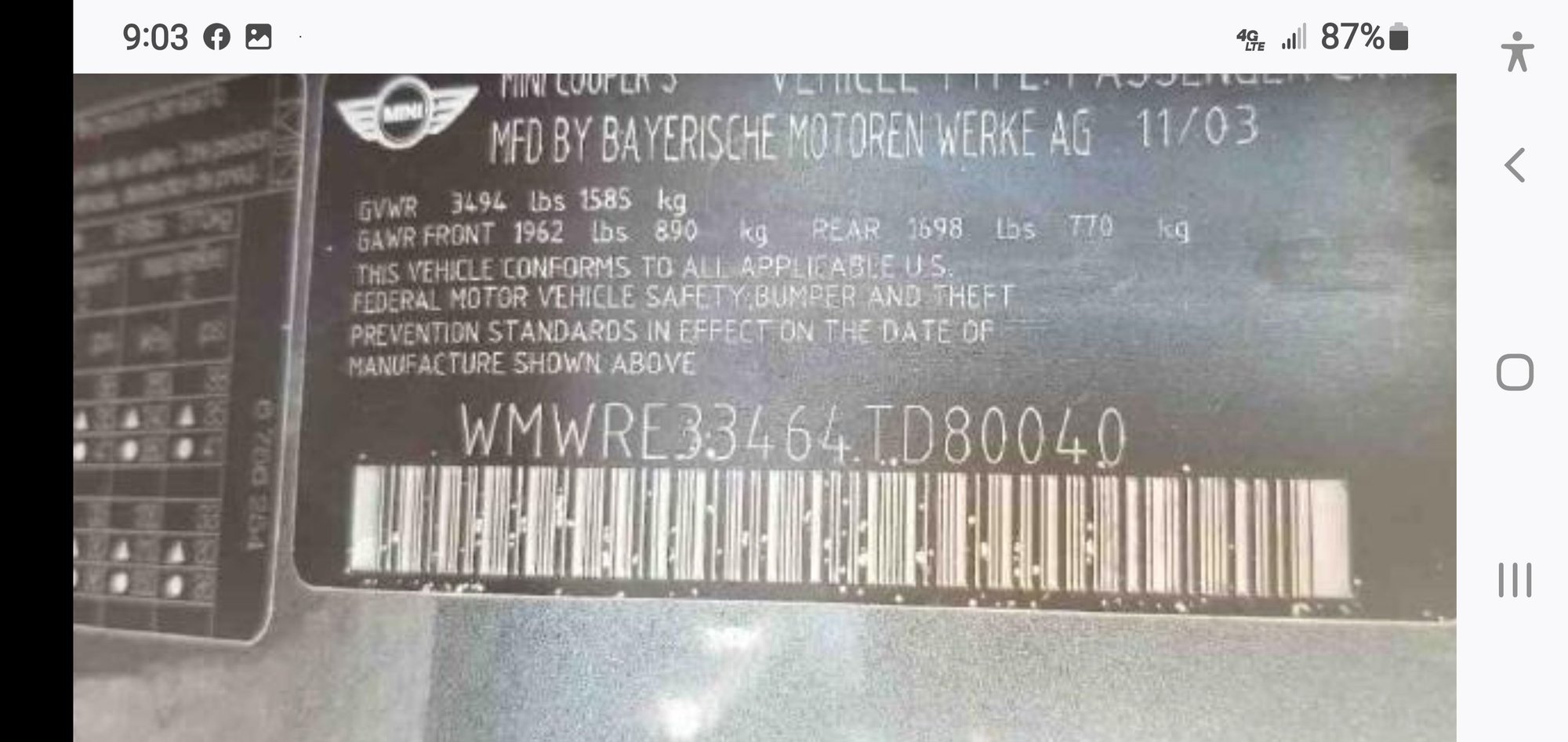

Found some pics of the car

Quick vin check says 6spd trans so if it has a 5spd it was changed . I'm not sure what to think regarding other engine mods. If there's a bigger cam etc.

The pic resolution is bad, but from some of the parts and the large outmotoring decal, that car looks like it belonged to someone that was really into MINI’s
That looks like a factory JCW carbon spoiler, possible Team Dynamics wheels, bigger brakes (possibly JCW’s), possible JCW carbon hood scoop, hatch handle, and super rare mirror caps. It also looks like the front and rear JCW badges are still there. Lots of $$$ stuff if you can pull them yourself. If not, I don’t know/doubt if they would be careful enough to pull the stuff off without damaging them.
