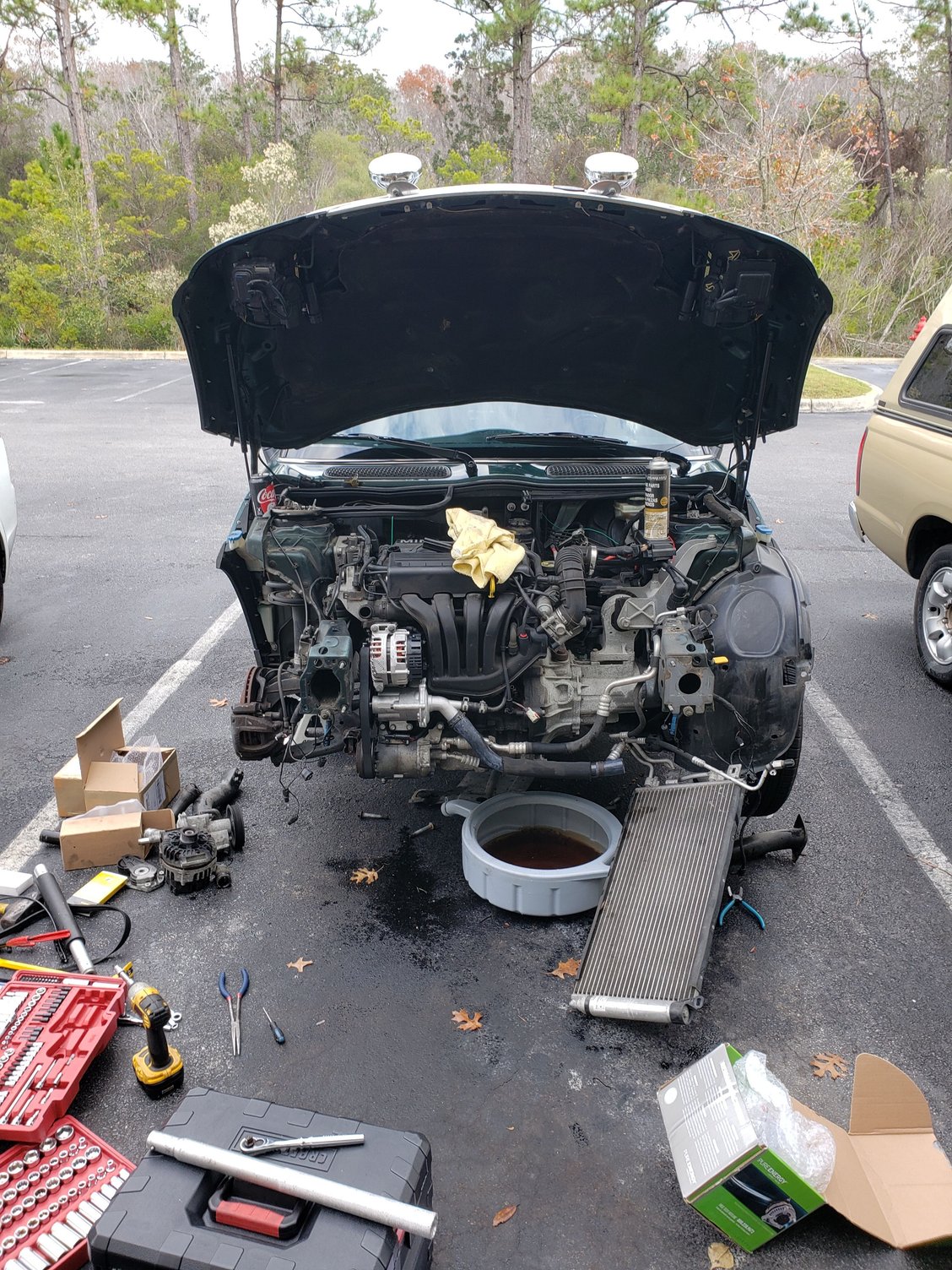

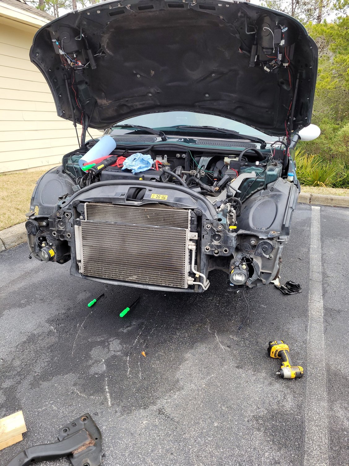

Heck I did my clutch in my apartment parking lot. Along with my 100k service.
HA , I recognize that toolbox set..lol things best purchase next to my 1400ftlb milwaukee fuel impact. Those 2x things have torn my car up and down countless times..though I too am looking into finding helper for my lsd and clutch job.

That portable tool set has save my *** a few times. You can do the clutch by yourself. Just get a engine brace from Harbor freight. Also get a couple ratchet straps. An it does not hurt to have a trans jack from harbor freight as well. Did not take to long to do. My install was delayed do too a clutch fork issue. Had to order a new one.
