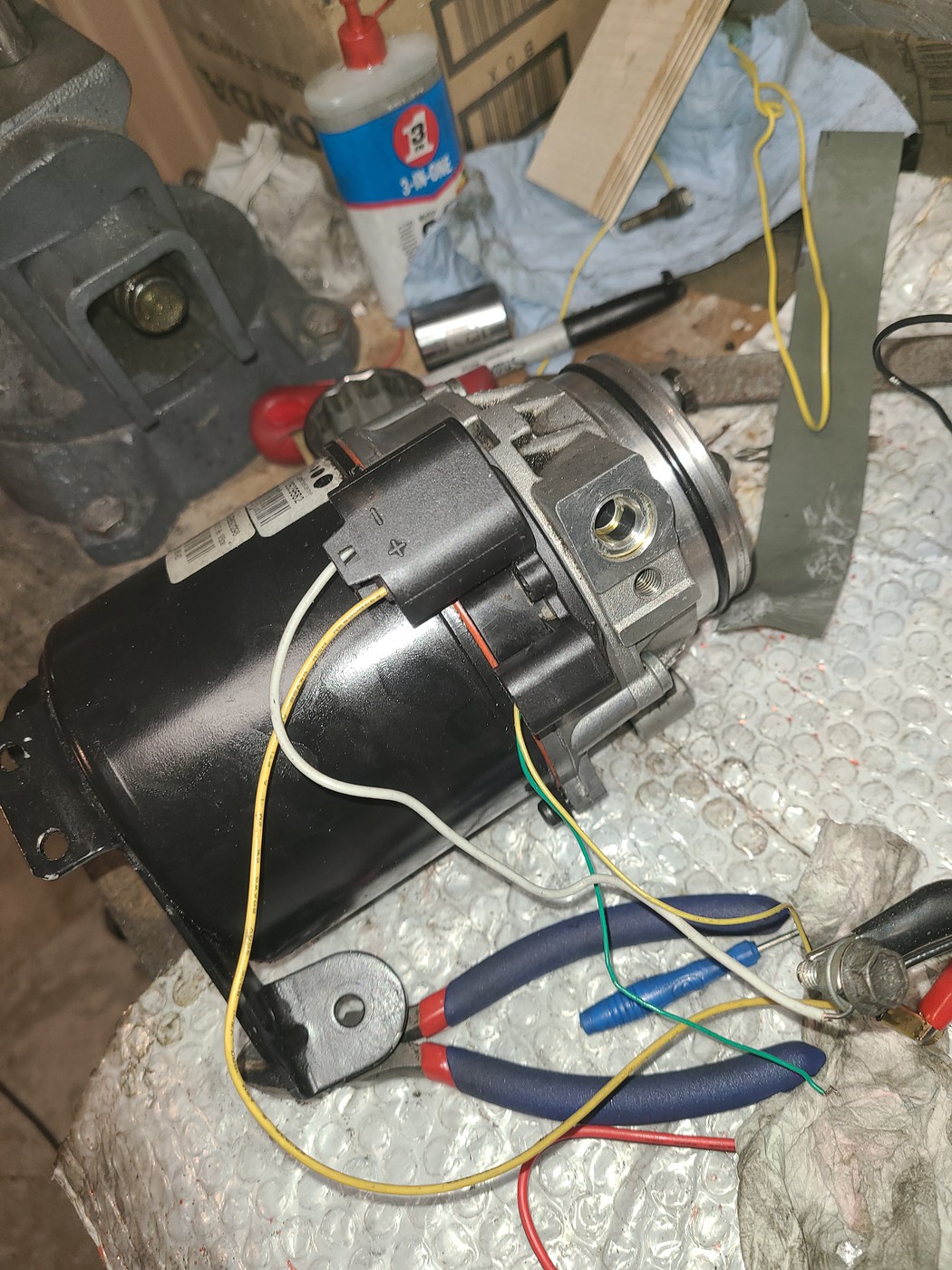

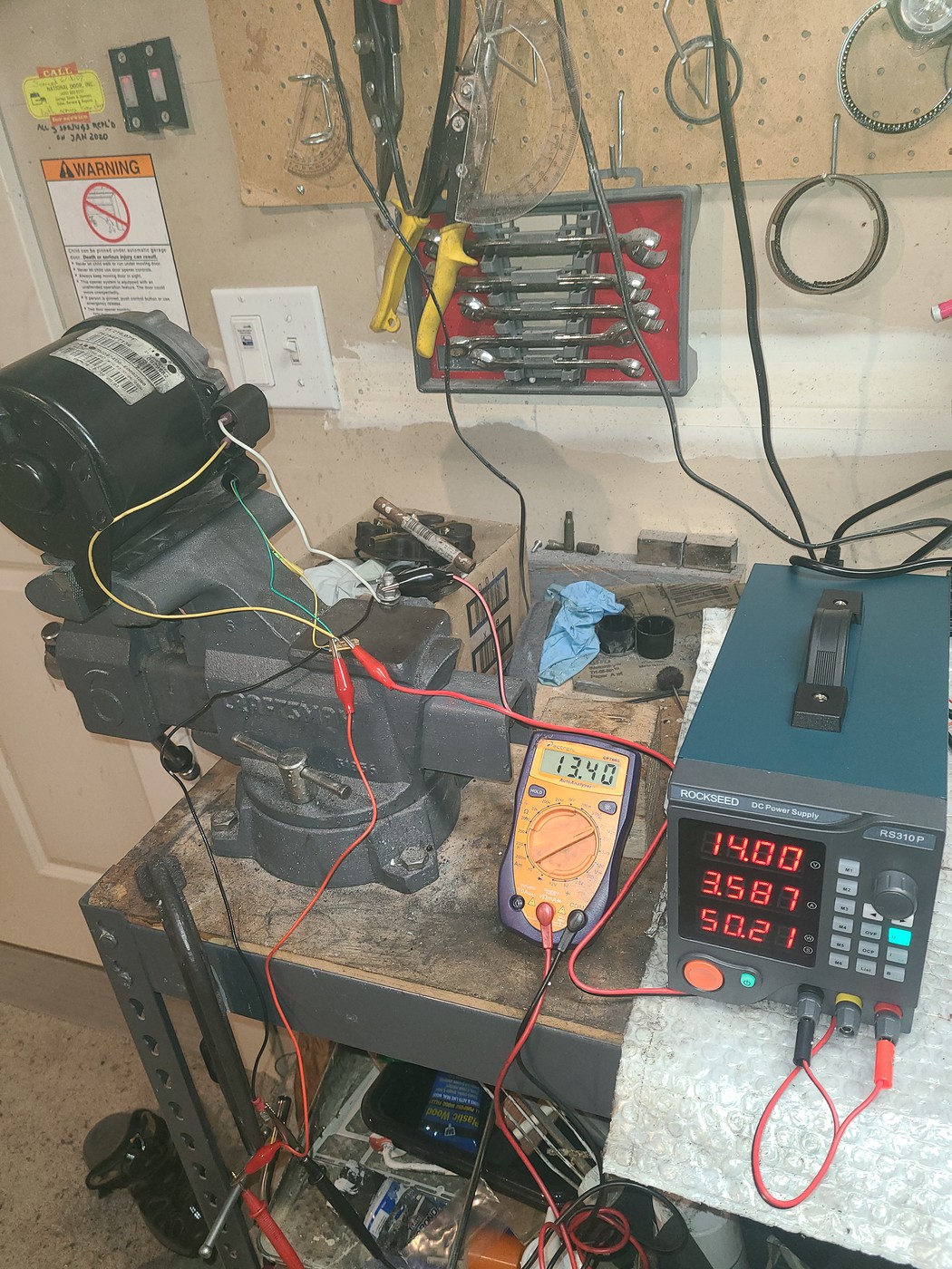

Nervos- Would you mind explaining in detail to a someone who is new to working with electronics (me) what exactly you were doing when you were bench testing you pump? It looks like pins 1 and 2 are both hooked up to the positive source in your Instagram post, correct? I used a 12V battery to connect to the terminals on the pump, so everything is getting the same voltage. I tried connecting pin 1 to positive and pin 2 to negative and vice versa, but that made no difference. I had the main power leads connected directly to the battery + to + and - to -.
I'm trying to understand if maybe my method of testing this thing is wrong, or if there is another problem on the board to deal with.

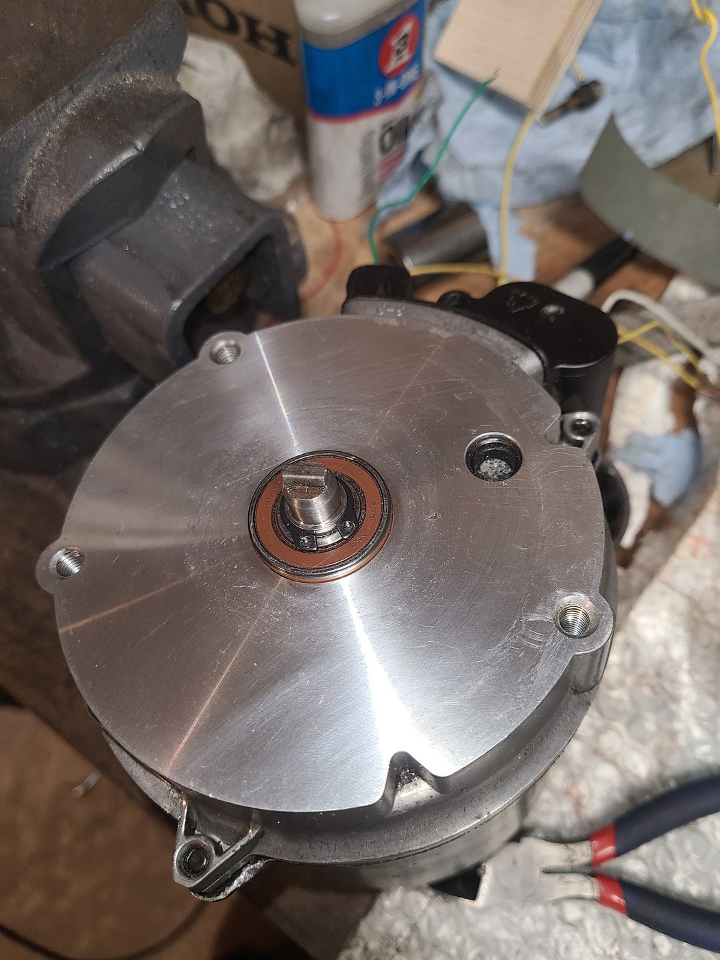

I have received the new motor armature from MTec today. Fast shipping!

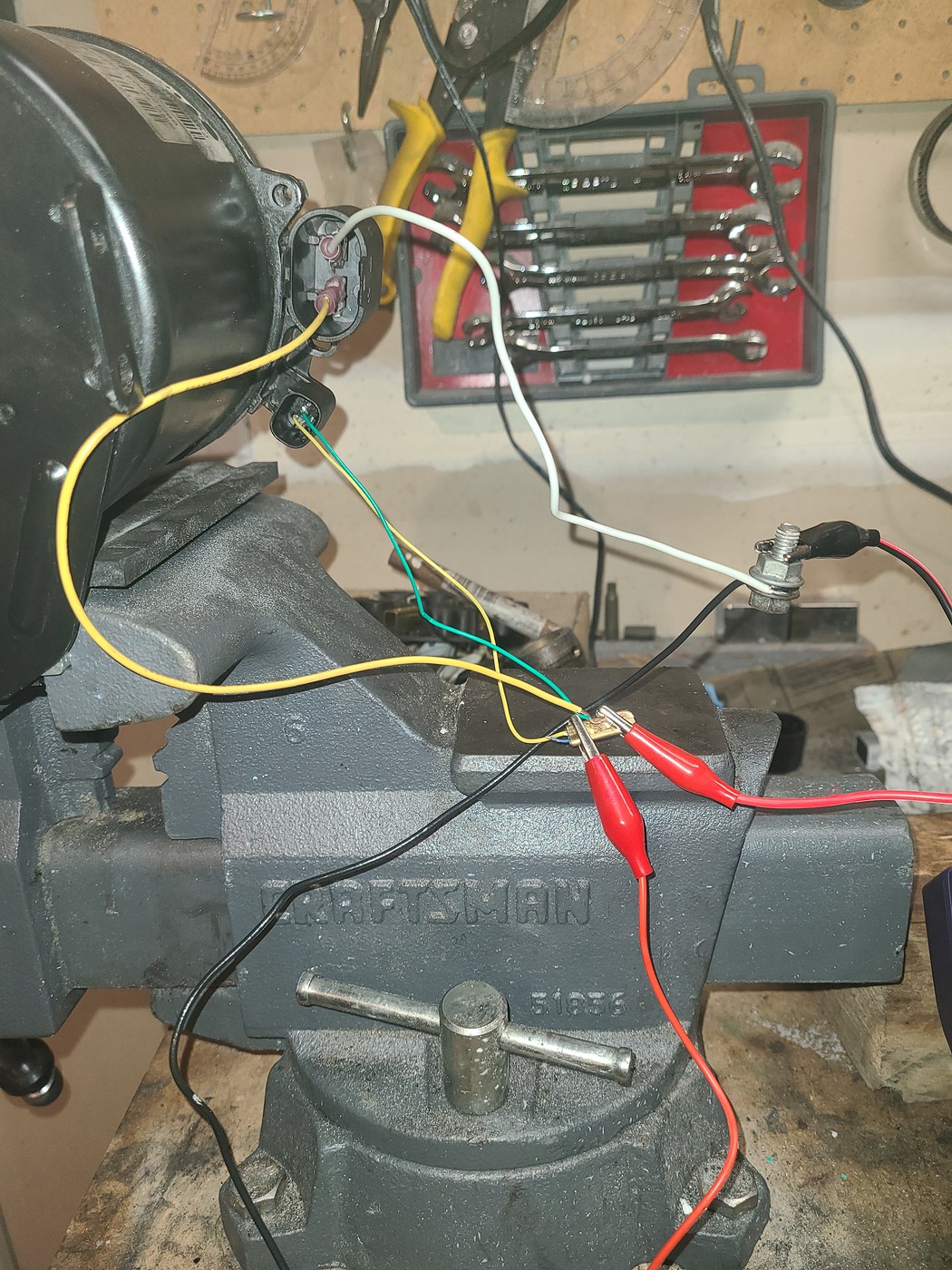

You can apply any voltage in the range 12..14V. No need in different voltage, same one works for all the wires. -12V goes to - on a big socket, +12V goes to + on a big socket and pins 1 and 2 of the small socket (pin 1 is closer to the big socket).
Here the thick white wire is '-' ; thick yellow, thin yellow and thin green ones are all +12V. Make sure your battery is in good condition and charged, it draws pretty good current, esp at start.

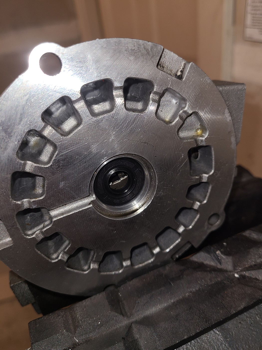

Correction. The 1/8" (3 mm) thickness O-ring is fine for the motor housing (the big orange one), but it is too thick for the oil pump. Diameter is fine, but the thickness must be thinner. I'd say it should be 1/16" (2 mm). Just FYI.
