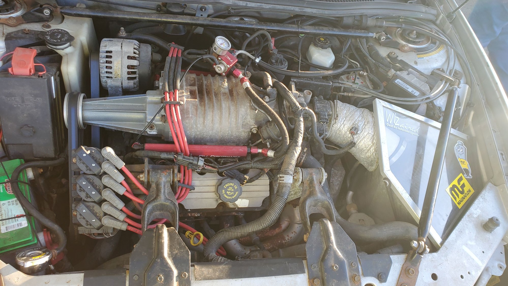

I couldn't find anything related to this info I was looking for by someone who's personally used the mods..well, I did and I've answered my questions and I hope if anyone else down the line , like me was wondering the exact differences between a 17,19 and 20% pulley..
M45 snout bolts right onto a m62. This is in my garage
