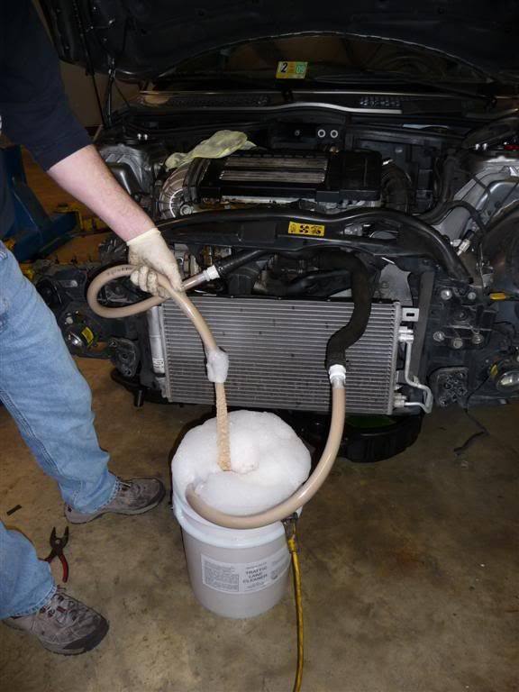

I want to do a flush similar to the one in the picture below. They ran several buckets of a detergent mixture through until the returning liquid was clear. It's from a thread on the forum detailing a similar but MUCH more severe version of the problem I have.
https://www.northamericanmotoring.co...acks-this.html
I have a new oil filter housing/oil cooler, thermostat housing, and thermostat ready to go in as well as the coolant hoses to the oil cooler. Ideally, I'd like to flush the system before installing them. That's not a problem for the thermostat and housing. In fact, I've removed the old thermostat but left the old housing. Will install the new ones after the flush. It's more of a problem for the oil filter housing. I can't put the old oil cooler back on the car because the internal passages are likely blocked, at least partially. But I'm concerned that putting the new oil filter housing and oil cooler on prior to doing the flush will contaminate the new oil cooler. I might be overthinking it. Any thoughts or suggestions?
