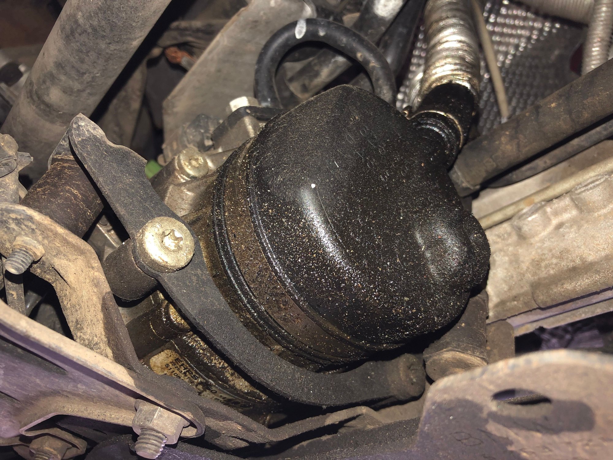

Power steering pump
Doing an oil change on my R53 and noticed my power steering pump coated with fluid. What might this be telling me, bad hose, leaky reservoir? The pump and fan are under recall right?

This seems to be common for our cars
replace hoses, clamps, res. and go go
check with dealer, but i think this recall expired

This is the reason why I changed to Canton PS alum. tank. No leaks so for!

Could also be general oil leaks from the engine, as this seeping oil will be blown onto the parts which lie after the engine (by just driving the car). I had the same issue and replaced:
-Oil filter housing gasket
-Oil cooler gaskets
-Oil pan gasket
-Rocker cover gasket

Definitely contact other dealerships, I just had the power steering pump recall performed Friday on my newly acquired R53 that never had it addressed.

New power steering pump, new power steering pump fan, new fluid as well as an assortment of odd ball things. (clamps, o-rings, and hoses?) I'd have to pull my paperwork out to confirm exact pieces but the main hitters were those. They also inspected the wiring and confirmed that was in good shape so nothing needed there.

I would agree to this but the oil leak is LOCALIZED to the pump.

Pump was groaning and whining when turning at low speeds (in and out of garage etc.) and very heavy steering at lower speeds. Every now and then the power steering pump fan would make an awful noise too. I just picked this R53 up two months ago so I've been going over things and knew when I purchased it that those would likely need replaced. I checked the VIN against the safety recall and found out the recall had not been preformed on the car though so I reached out to the MINI dealership for confirmation and they instantly ordered the parts to have it done.

I don't think it does expire my car was an 04 with 210000 miles on it when I took it in and modified to **** and they did my power steering recall yeah it's been recall and with my new Mini that I just picked up, another 04 that I also will be taking back to the same place to have them doing the same work on this car too.

So i thought id share the outcome on my Power steering. Called dealer to find out about the recall and made an appointment so they could inspect it. They did confirm that they would take care of all components related when i made the appt. They ended up replacing the pump, fan, hose clamp, self locking collar, hex nut flange, O-ring, gasket ring, rubber mounting, torx screw and new fluid. They wouldn't replace any hoses that were leaking as i hoped they would. But get this, they wanted $298 to replace the feed hose that was leaking and after i almost laughing out loud i politely declined. I mean, if it would of been reasonable i might have said sure why not. But come on man. Anyways they also did an inspection beforehand and made a video of it and sent it to me via text as i was milling around the dealership. The result was all the trouble spots associated with Mini's.... A couple of leaks, valve cover gasket and oil pan gasket. Also but more concerning is my control arm bushings are shot. Estimate for both Gaskets and the bushings and labor..... $3086, yikes!

Yep most should be covered, but most of the time its those lines that leak down on the pump. If the pump did not fail and leak. Those are not replaced unless the pump is replaced under the warranty extension. When i took mine in they saw i had the newest pump already and the lines would not be covered if they leaked.
Its up to the dealer from what i found on the pump and lines when they look at it.
