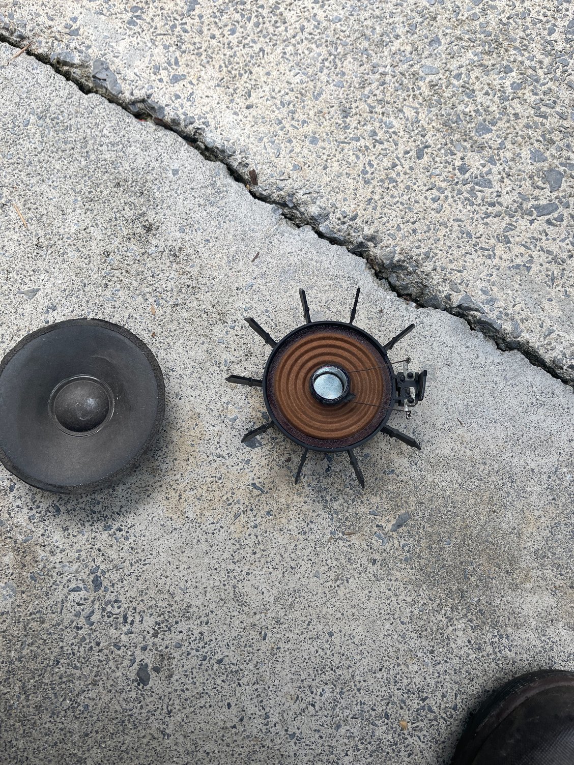

I did a thread search and if I read it correctly our cars have 5-1/4 inch speakers and they do, well sort of. The new speakers I bought were 5-1/4 and way too small to be bolted directly to the door. I measured and then I cut the old speaker out of the plastic adapter thingy.
I screwed the new speaker into the old housing. Made a small wiring harness from the stock plug to the new speakers. Installed it on the door and then blasted some AC/DC Thunder Struck to test it out. The door panel fits perfectly with no rubbing or interference. I was able to finish the passenger door before the rain stopped all work. It's going to sound even better when I get the drivers side done. It's going to be nice to have it balanced out instead of just the back speakers.
Next is the drivers door speaker and lube the window track. Then install the new drivers seat back fabric.

I finished installing the new front speakers! The drivers speaker was in the same condition as the passenger speaker. I played some beach boys just for you dmath!!
While I had the drivers door panel off I lubed the regulator and wires real good. I am sure it's days are numbered too.
Found the crunchy noise coming from the passenger side regulator.
