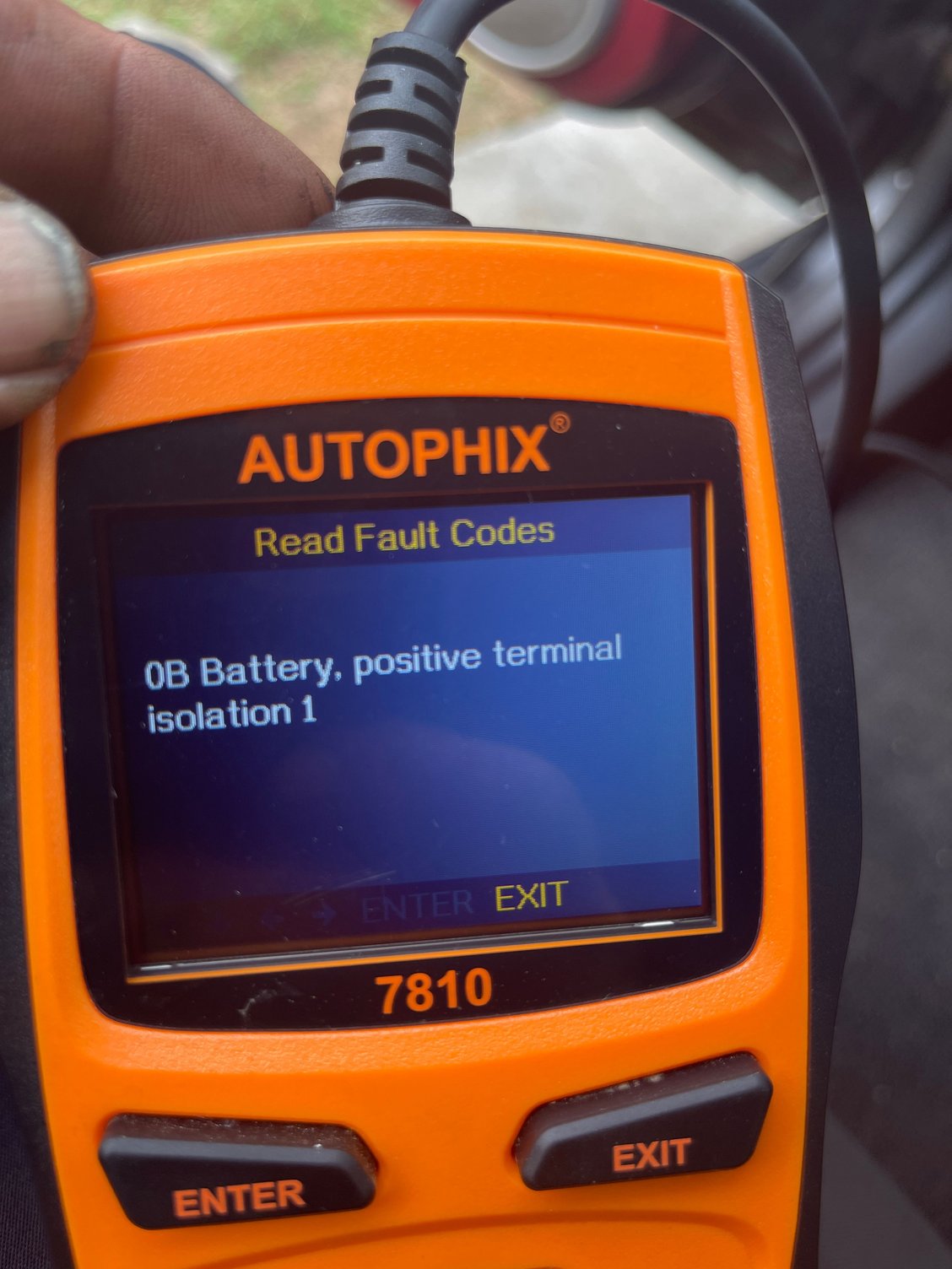

Yanked the interior out and replaced the Airbag ECU this afternoon. I hooked the battery up and then turned they key with fingers crossed. Light came on, went off and came right back on. DANG IT. Got my code reader and read the codes, same codes as I had before. I cleared the codes and then turned it off, then back on. Same thing, light on, off then back on except now I only have one code instead of 11. My original diag of a bad ECU was correct because none of the other fault codes came back. The only code is 0B Battery, positive terminal isolation 1.
Its good to know my code reader will erase airbag codes. Only problem is I can't find anything on how to fix it. My battery is up front and I only have 2 positive cables coming off the battery. Both of them are big and no funny looking resister in sight. One looks like it goes to the starter and the other to fuse box. Any one have an suggestions???

While pulling the interior and it sitting on the parking pad I noticed a leak. In the middle of the car towards the back for the engine compartment. Looking at it briefly I am thinking power steering. Great….
I cleaned the battery terminals and no change to the light coming on. I guess the next thing is to pull the fuse box and clean the positive connection going to it. Hopefully I can find some kind of troubleshooting. All the ones I find is related to the cars with the battery in the back or have the funky explosive terminal, and I do not have either one. The battery is almost brand new so it’s not a weak battery.
