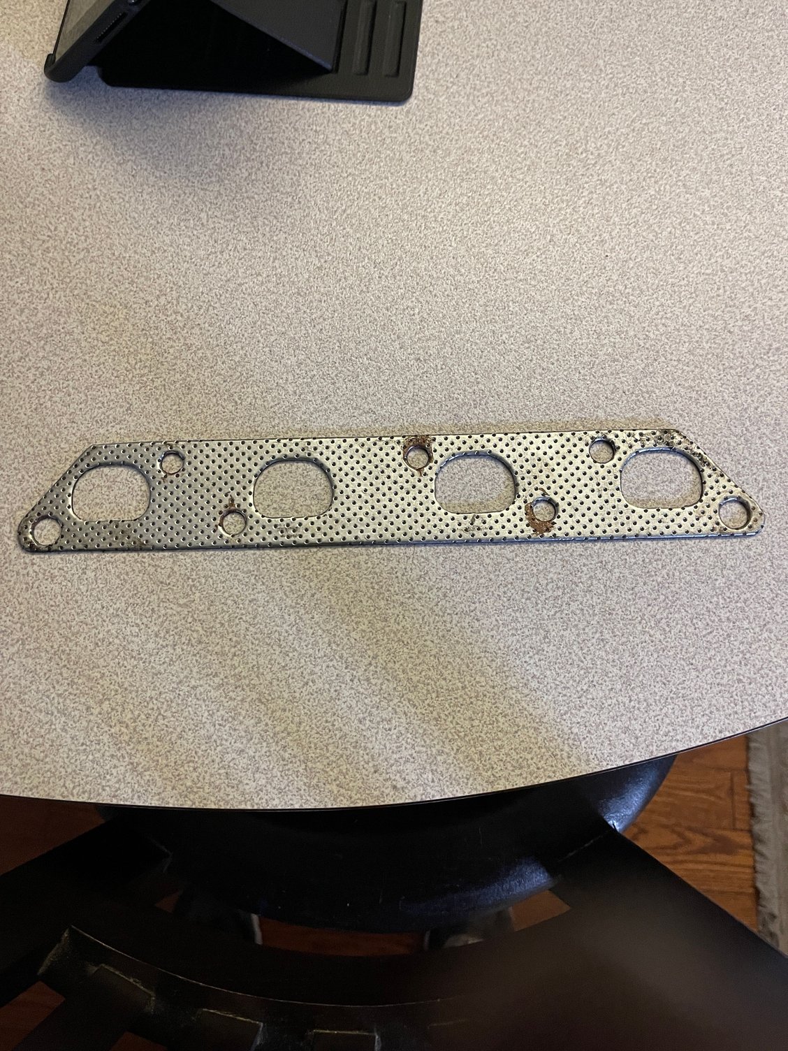

First issue was the new exhaust gasket was missing a hole.
I have it all back together, steering linkage was a real pain to get lined up and back on.
Today I :
Reinstalled the frame,
New coolant
Installed all new exhaust, downstream sensor still throwing a code
Funny idle, really bad at start up. Give it some gas for a minute and then it idles ok. Turn on the AC and the whole cars shakes again. No codes except the 02 sensor. I reset the ECU but no big difference.
AC compressor comes on but no cold air, pretty sure it has a leak and the past owner filled it up before I bought it.
My back and hips hurt so bad from rolling around on the concrete all day but it's back together.
