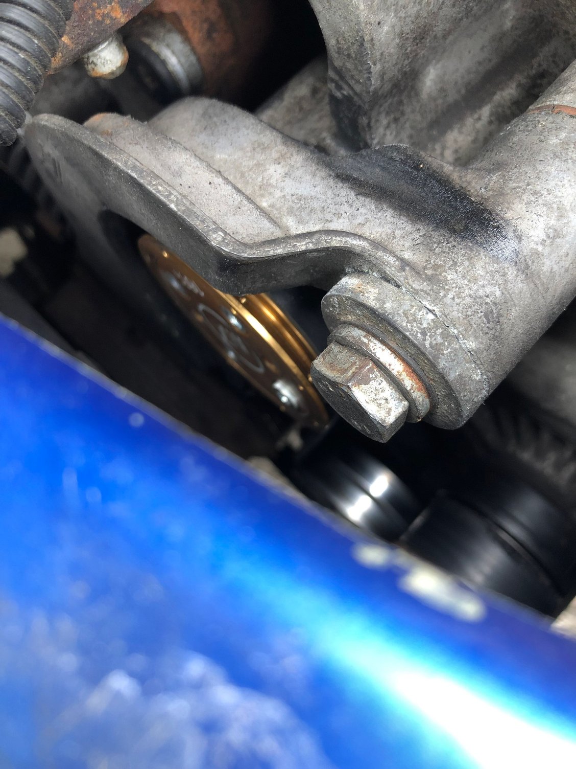

Hello all, wanted to share my terrible m7 pulley experience. It was the 16% pulley. Here’s my story
Within one month of the pulley install, 1 of the screws came lose causing the belt to warp.
No problem, maybe my mini specialist didn’t tighten it. Go back to him, we take the belt off, inspect all the other pullies, bearings and tensioner..everything checks out great.
Reinstall the pulley, everything is aligned, new belt and all.
Immediately after starting the car, the pulley backs out 1/4 of an inch, causing the belt to slip. This is what happened to me overtime. Pulley was slowly backing away and eventually my belt was chewed up and I have no boost.
This pulley only lasted me one month. I am not impressed.
I am not the only one who has had this experience with m7.
I now need to get a new pulley, and I am going with the craven speed 15% .
My love
… photo speaks for itself
My brand new belt

100% installer error.
Pull the pulley, check the shaft, check the other pulleys, clean everything, re-install using serviceable lock-tite,

Sounds like your mechanic didn't install it right. Those same pulleys are on all kinds of cars, and never have any issue. To say the entire company is bad just because you had a problem with a pulley (most likely an install issue) is pretty childish.
What did your mechanic torque the bolts to? And did he use any blue locktite?
