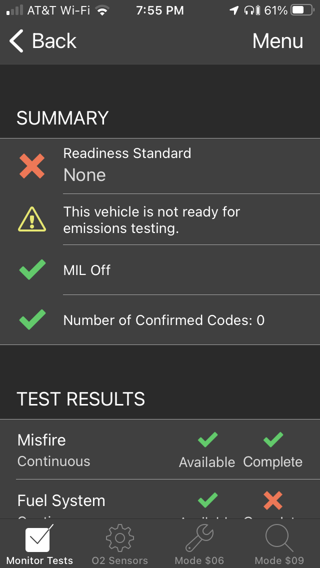

OBD II images
Here is what my OBD Fusion phone app is showing. Adrian provided me with a post-facelift MS5150 ECU with tune embedded and that's what it's reading. I took it back to the state inspection station today to see if there had been any changes to the readings just in case my app was working improperly -- it wasn't as you can see. Oddly, their scanner was indicating systems were "N/S" (?), not "N/A" (not available). They had never seen an N/S designation so they were flummoxed. This afternoon I removed the MS5150 ECU and reinstalled the original pre-facelift ECU thinking that I could get the inspection then swap the ECUs out afterward. My Mini started ever so briefly twice (for a second) then died. It now won't start at all -- cranks but won't start. Strangely, my phone app is now showing it ready for emissions testing with the original ECU. The only mechanical change made between ECUs was the installation of 380cc injectors which might make the Mini run rich with the old ECU but shouldn't prevent it from starting. I now have a Mini that won't pass inspection with one ECU and won't start with the other. None of this makes sense to me and I'm a better than average mechanic. I'm totally open to any ideas anyone might have on how to solve this dilemma.

ews keys probably need to be re-sync'ed on the old ecu, you can do it in INPA
that app makes it look like almost all the tests are still pending?!?

Exactly. That's the problem. State site is seeing the same thing and can't inspect it. I'll swap the MS5150 ECU back into the Mini tomorrow and, hopefully, it will start but that doesn't solve my problem. It still doesn't make sense to me that it won't start with the original ECU.

Update -- After viewing the Texas state emissions testing information online I found this: "If any of the non-continuous monitors say N/A (Not Available) or N/S (Not Supported), then there is no monitor for that system."

The "not ready" designations are the crucial information. I also have the failing report from the state inspection site so all the information is in hand. I uploaded the ECU and sent it to Adrian who changed the country code and sent it back. Haven't had time to download it yet but will do that tomorrow and see if it makes a difference. I honestly don't believe it will but one step at a time. I'm curious to know if there's anyone else out there with an Adrian tune that has had an issue with a state inspection failure.
