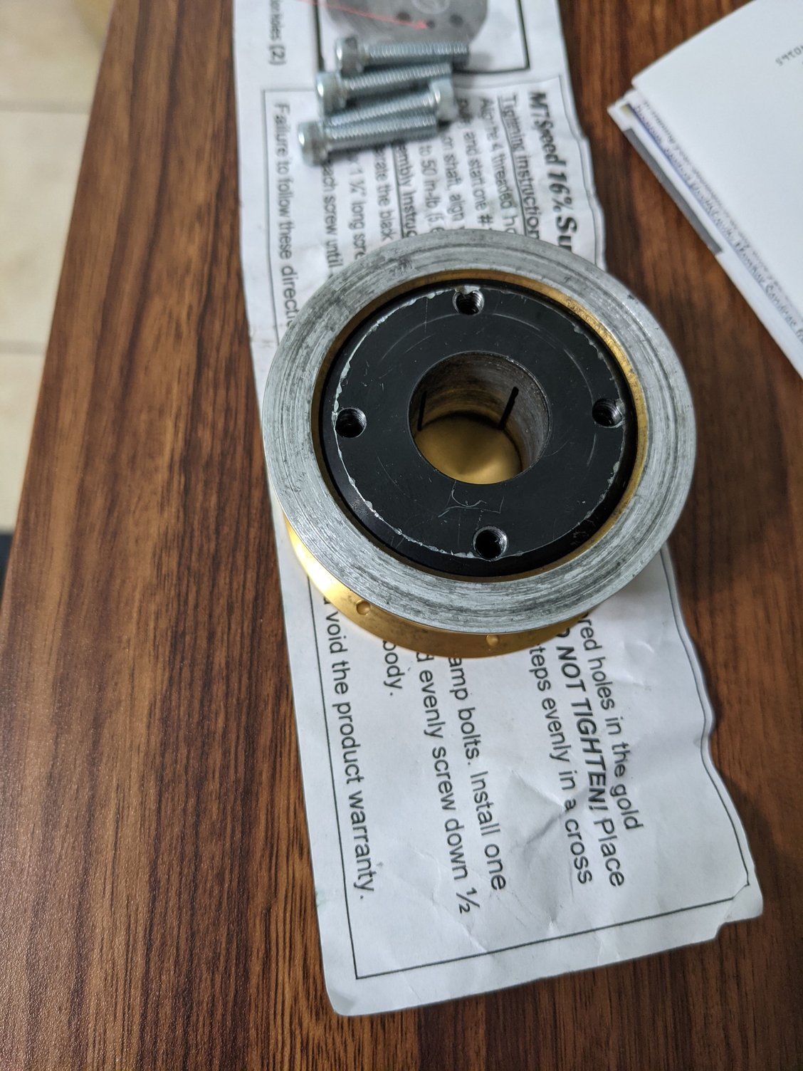

Ended up having an issue with the M7 SC pulley, the bolts came loose even though I tightened them to spec (50 in-lbs). I followed their directions to the letter and ended up adjusting the placement a couple of times to have a perfectly lined belt. That means it briefly rubbed against the SC before moving out and shredding the belt. Because the pulley spun on the shaft, the shaft is a little bit scored. Had to use sandpaper to smooth it out and be able to install a new pulley, not very happy about that. Switched to a CS pulley and followed Mod Mini's instructions, looks like a better design on the collar and the car feels a lot better now. Good thing I pulled over in time so there seems to be no damage to the engine due to heat. Dealing with ECS to see if I can get it replaced under warranty or if I'm stuck with a broken pulley.

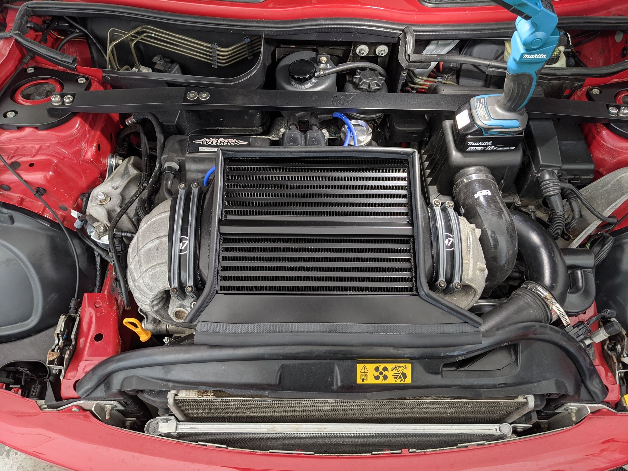

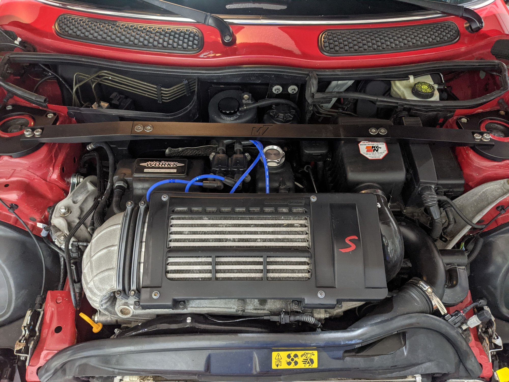

I was waiting for a GRS but went with an Airtec instead, also did the M7 boots. Wasn’t thrilled about grinding down pieces of the intake manifold but so far it’s working great. The boots are a pain in the *** though, not looking forward to removing this intercooler

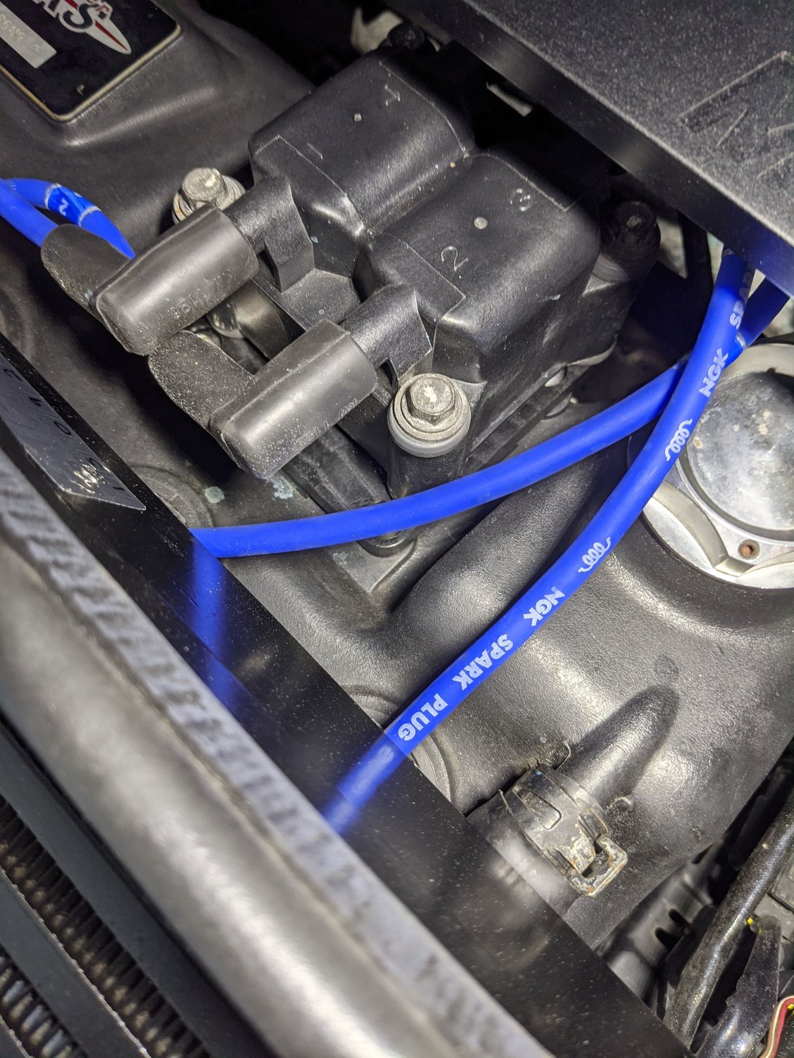

Finally received a couple of pieces from the UK: a coil pack relocation plate (better clearance with the larger intercooler) and a visor mount for the UltraGauge. Also, my headliner is starting to fall apart so I'll have to figure out how to get it fixed

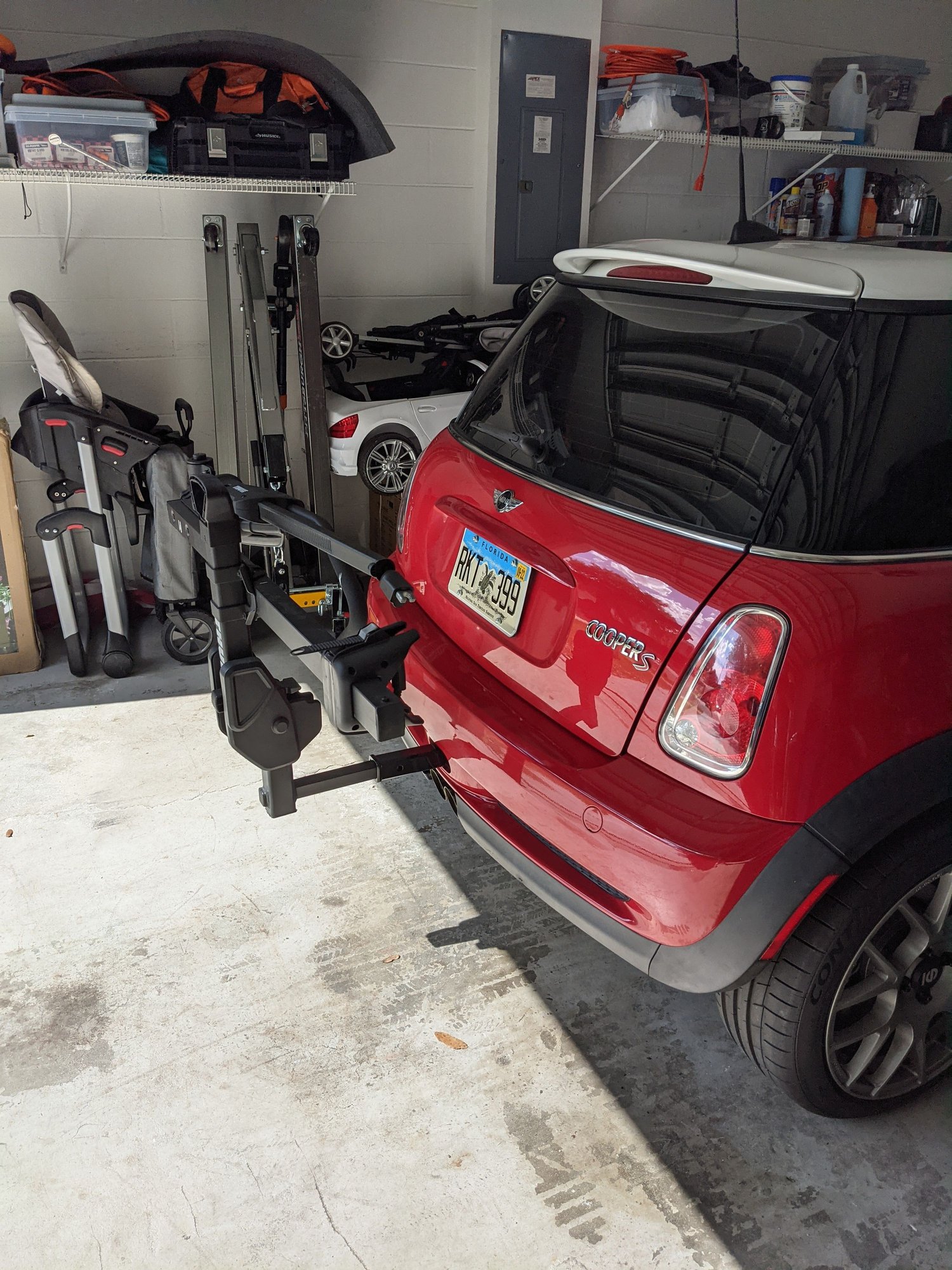

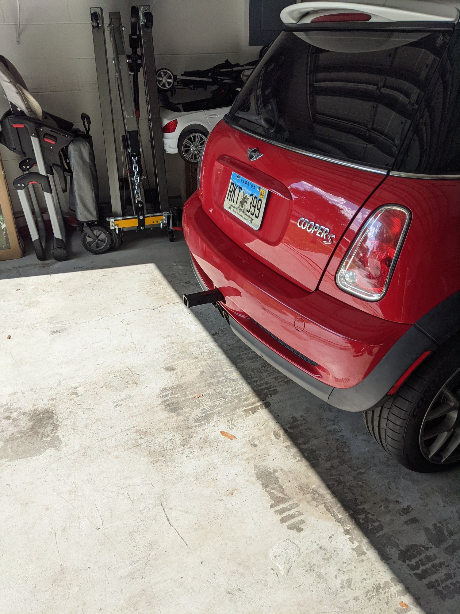

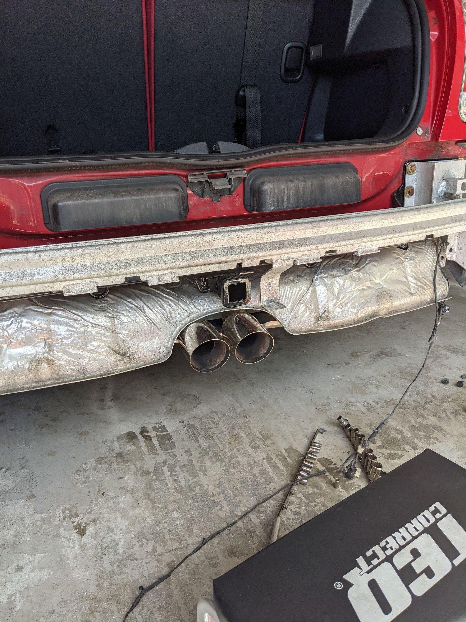

Received the new side markers and had to change the plugs for the wires as they were broken, looks much better now. Also, I was able to find the hitch on Amazon, ECS kept delaying the order saying CURT was backed up with orders. Looks weird with the extension, but it's much easier to connect\disconnect things as the hitch itself ends up behind the bumper. I can ride my bike again!

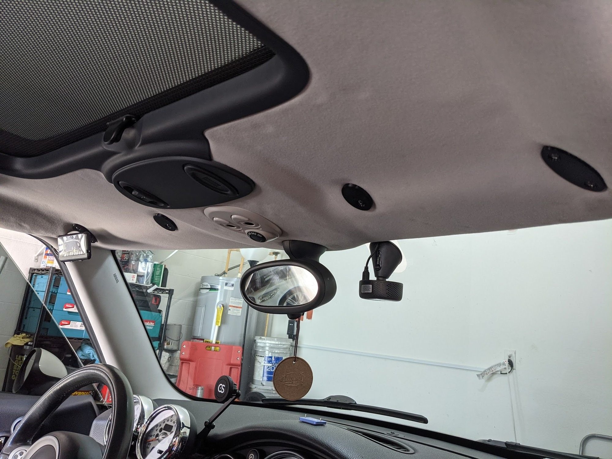

Found a guy that does mobile headliner repair, he replaced the fabric and looks much better (glue still needs to dry). Turns out my scoop broke when I installed the Airtec, it seems it was broken before and someone fixed it. I like the new look.
