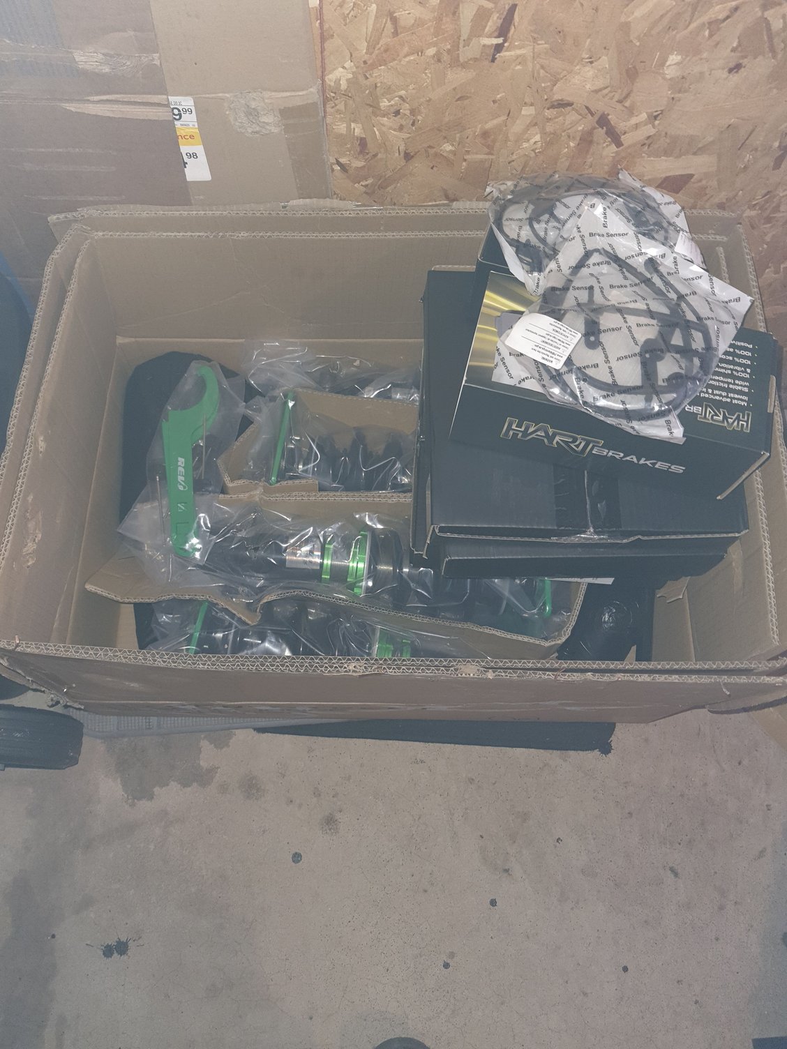

So I'm finally going to put on my coilovers and better brakes.
the brakes are obvious and strait forward BUT is the rear caliper a simple compress style or a spin in style ?
I also have rev9 hyperstreet 2x adjustable coilovers.. is there anything else I should order and be replacing while I'm doing the coilovers ? I'm guessing that the removal of the old suspension is also easy but when I put on the new coilovers should I put them at either the highest or lowest settings and set them from there ?
any tips or tricks that could help me during this ???
