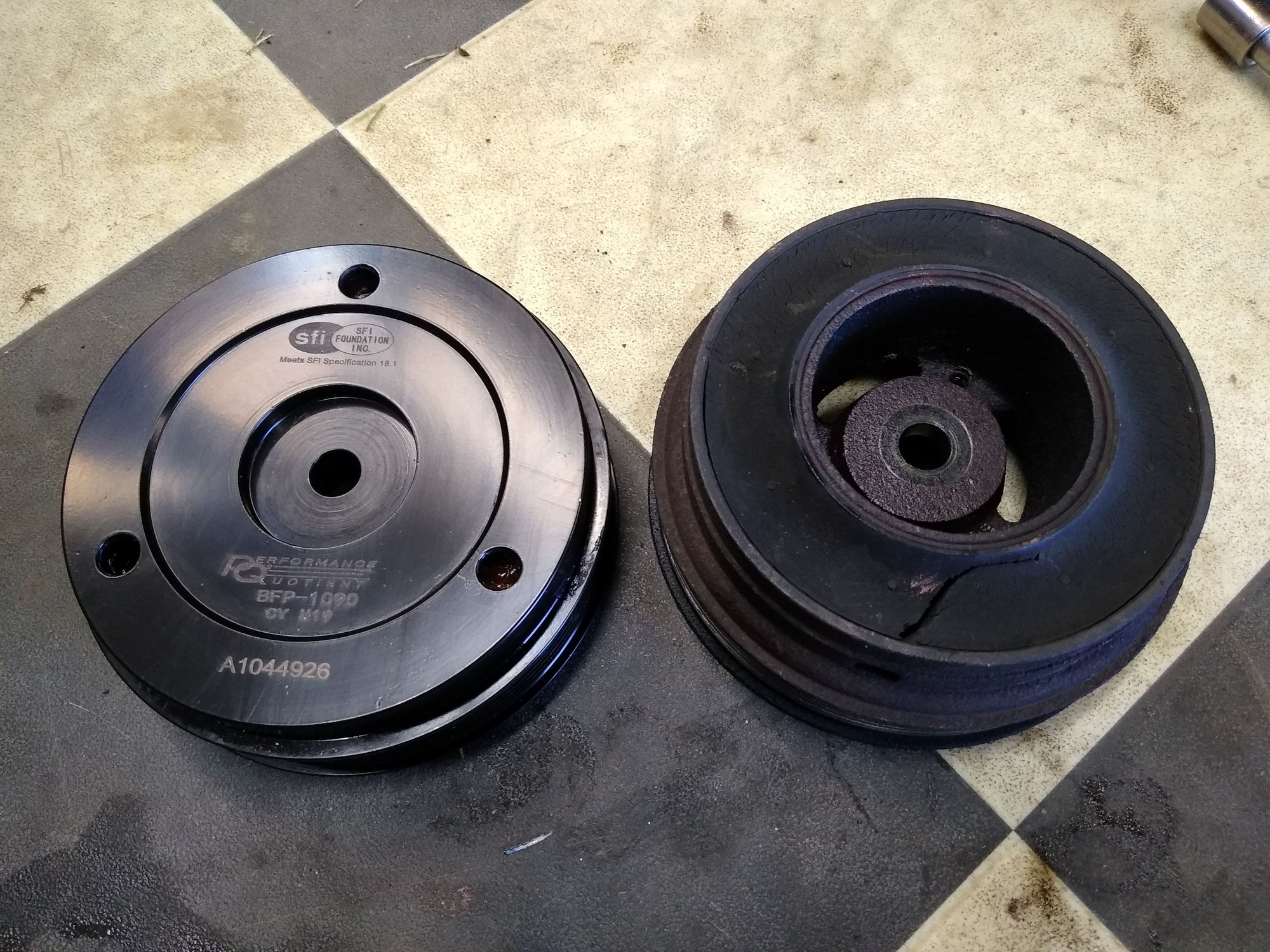

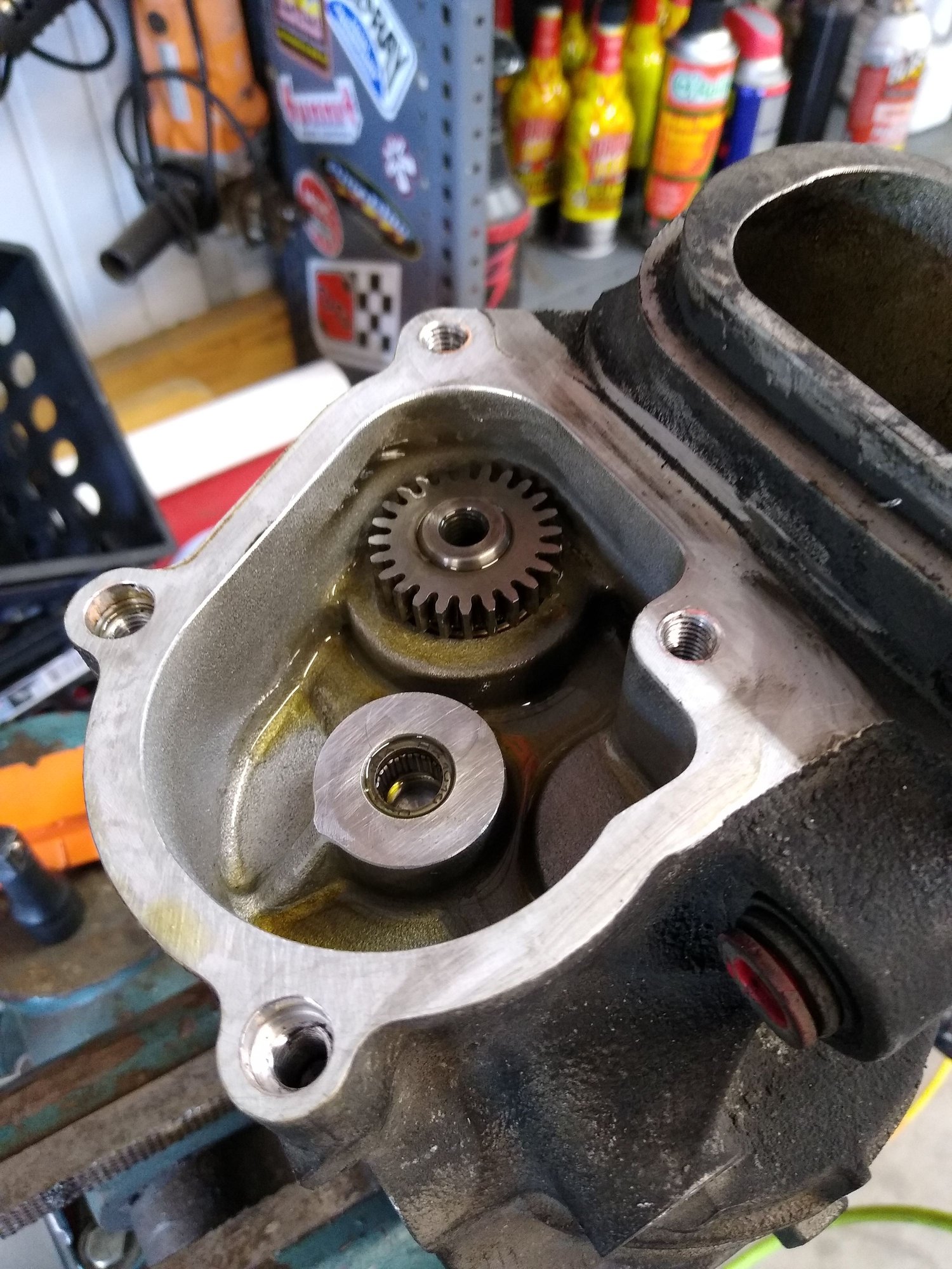

Just thought I would post some pics from my work on the car this weekend. At 183K miles, it still had the OEM crank pulley on it, and it was starting to leak some coolant from that blockoff plate behind the supercharger….so it was a good time to pull that off and check it out also. That, and it needed a new belt and an oil change while I was at it.
I ended up draining about 1oz of oil out of the front SC reservoir, and not much more than ½ an ounce out of the rear. It was low on oil, but still had enough in there to keep the gears lubricated apparently. The oil actually didn’t look all that bad….dark brown, but not black. The gears all look brand new!

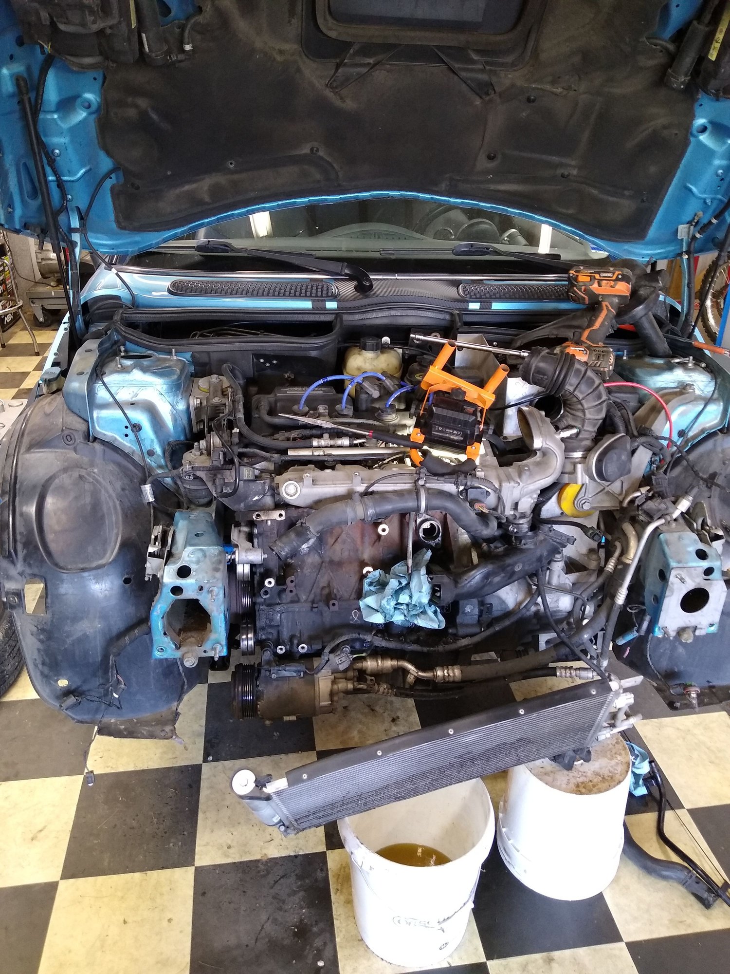

Got the new crank pulley on, new belt, replaced the o-ring on that coolant plate, serviced the SC, and got it all back together………
CRAP!!....now it’s leaking coolant like crazy from the front of the car! I’m pretty sure it’s coming from where the waterpump plugs into the block. I probably should have replaced that oring that goes on the water pump snout……time to pull the front of the car off again tonight. At least that should be a pretty easy fix….

That damper is not listed on the Performance Quotient site. I'm assuming it's a PRW. Where did you source it and can you tell the difference?

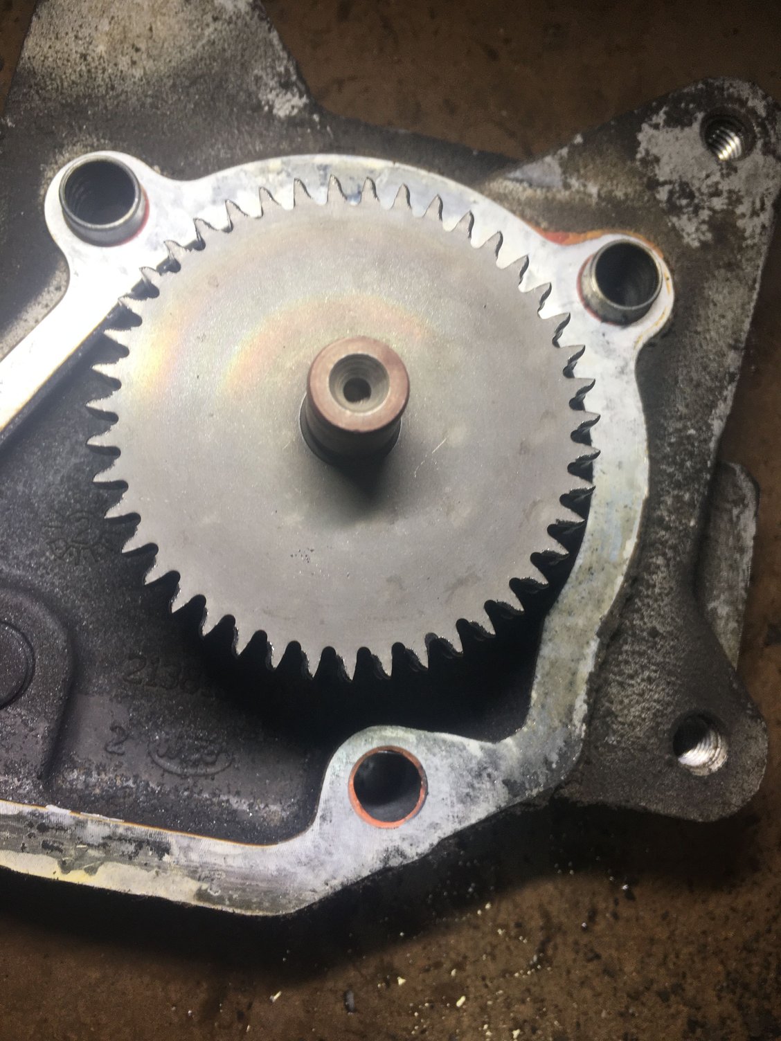

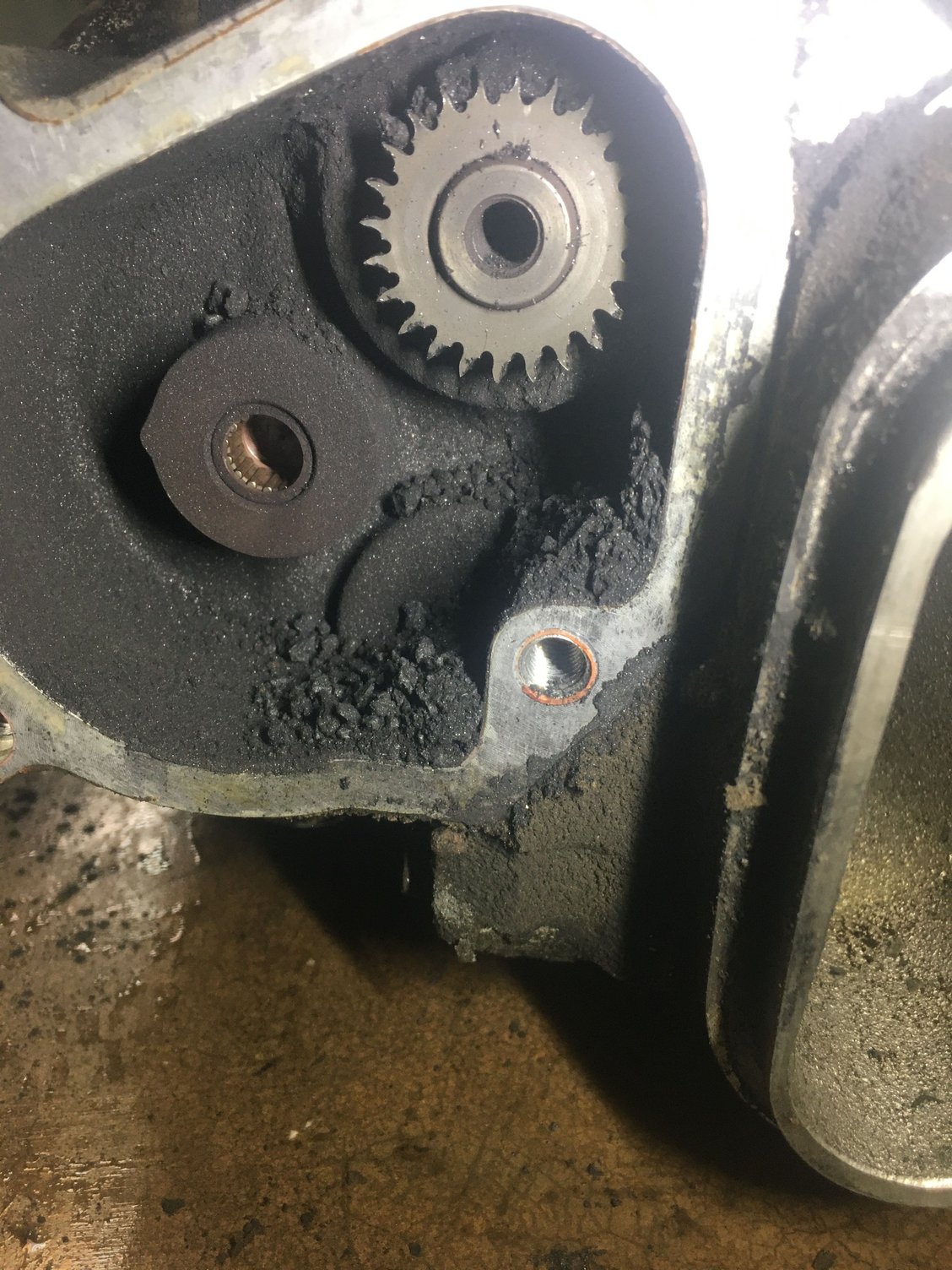

That's remarkable that your 183k mile supercharger has oil, let alone somewhat clean oil in it. Are you certain it's never been serviced?
I just pulled my 157k mile supercharger on Saturday because of the death rattle. My PTO was dry and had a pile of gear dust/gunk in it. I would say about a teaspoon or 2. The gears themselves were worn sharp. I didn't look at the front gears though.
I'm just amazed at how good your supercharger looks at that mileage!
