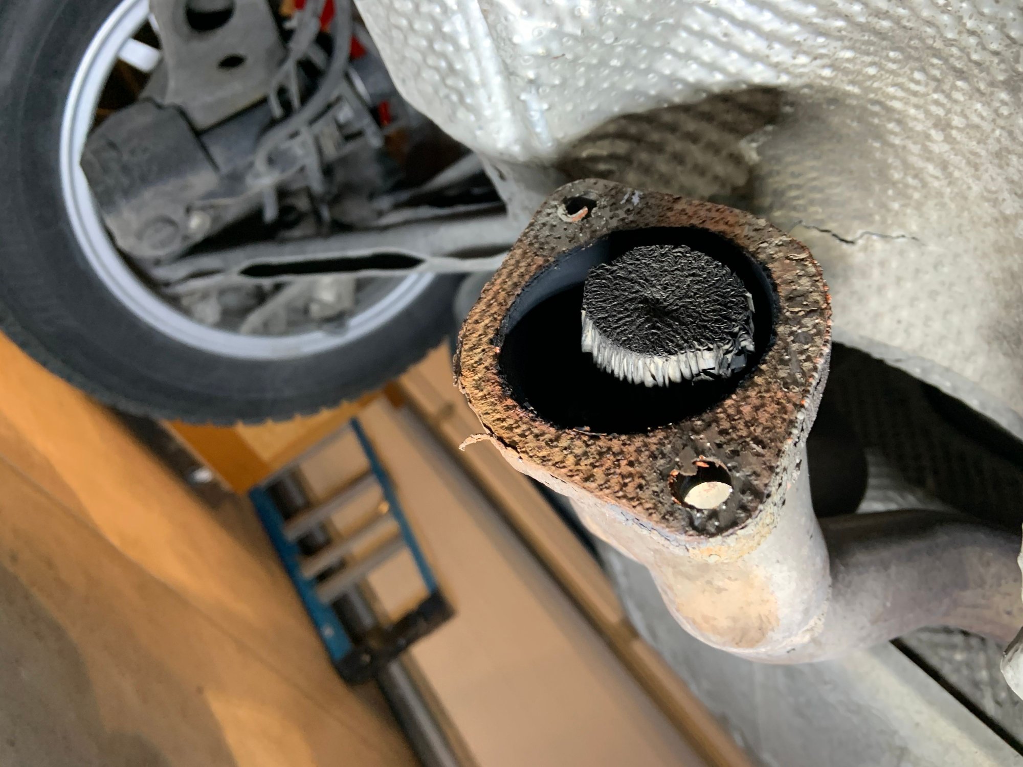

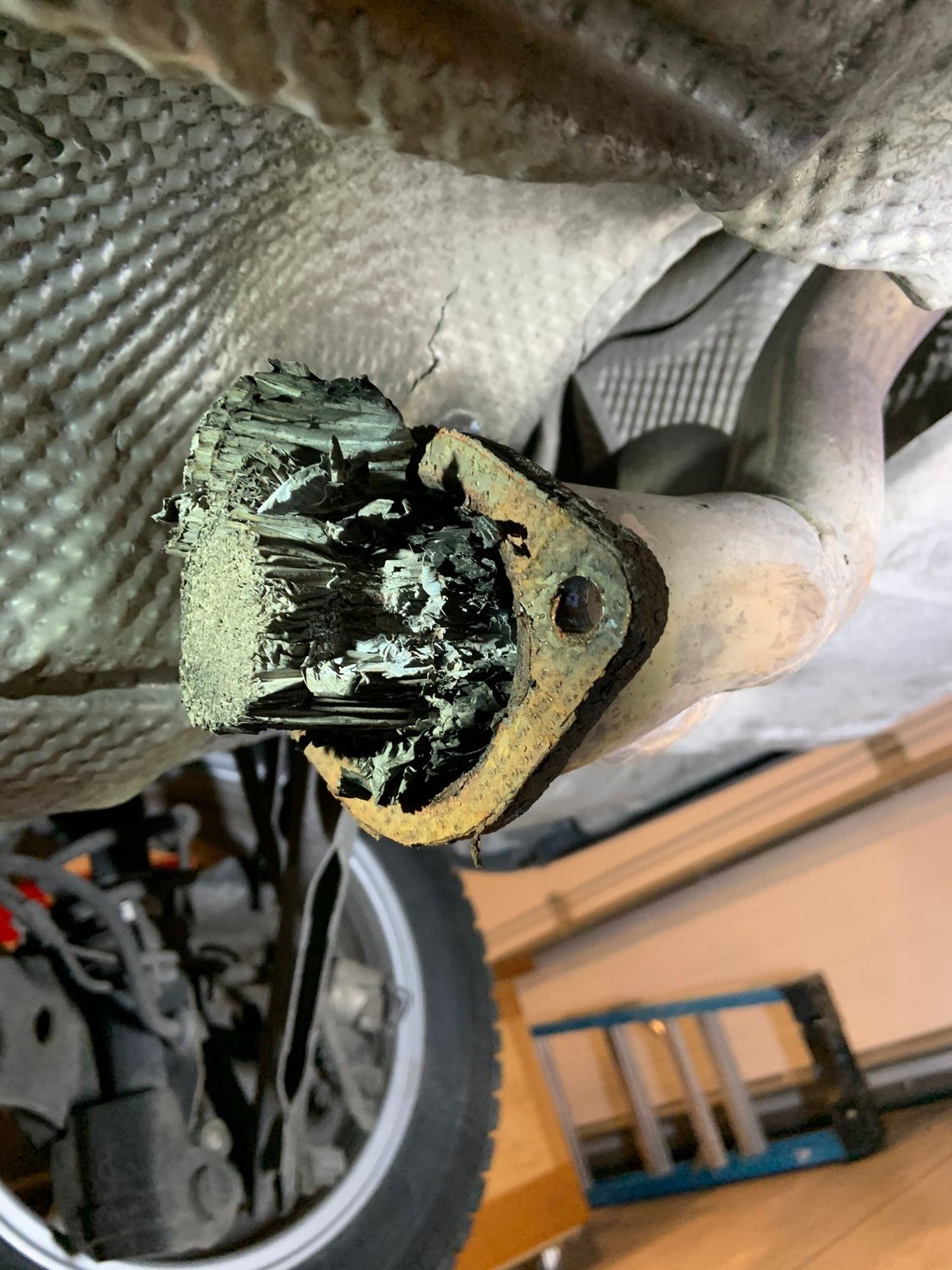

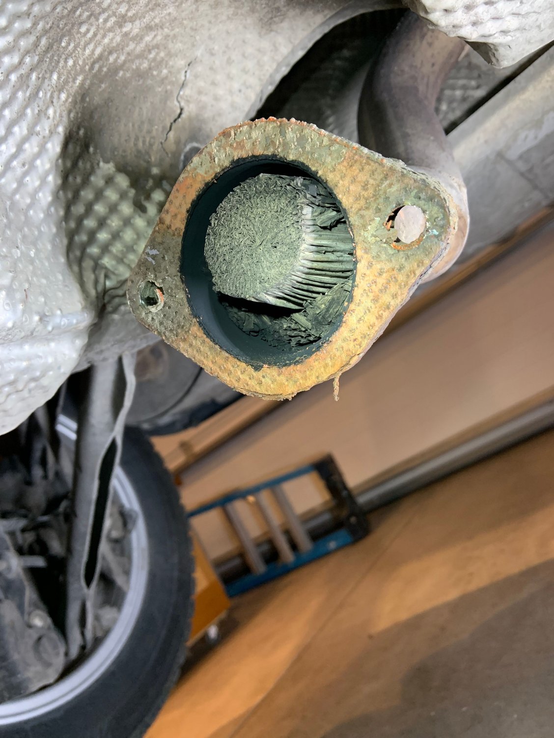

Started about a month ago I began noticing my performance wasn’t quite what it was then the mileage took a hit. Then got a CEL with a code for 107 then a 108. Replaced both sensors and was better but not performance wise. A couple days later I had to replace my left front wheel bearing so when finished I took it for a drive. During my drive I got on it hard and heard a big “boom” and saw grey smoke behind me then the CEL came on. Got it home and pulled the code for non functioning rear 02. Removed the 02 and it was shredded, dropped the exhaust from the cat and the cat was empty. Non of the substrate was no longer there. I think some of it might be in the mufflers.

found it.... it where the pipe splits into two. So far I can’t get it out
