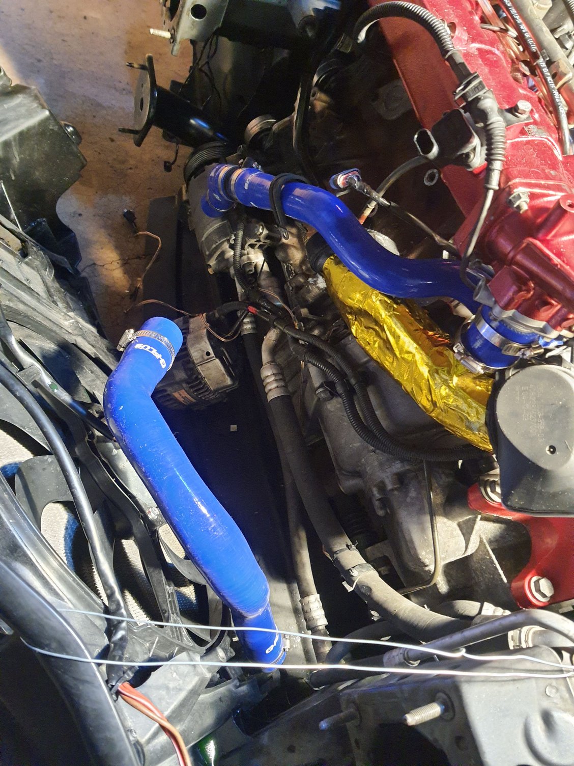

well ya but don't hold it there that long , I used just one of the handheld butane torches and circled around it for about 10 seconds only which was enough to make it flexible enough to then wobble down the tube. Thankfully my coolant hose kit I bought actually replaced that troublesome thing , which you can easily do too. Just remove it and buy a pice hose from a hardware or auto parts store and swap it out so in the future you don't fight it anymore.
