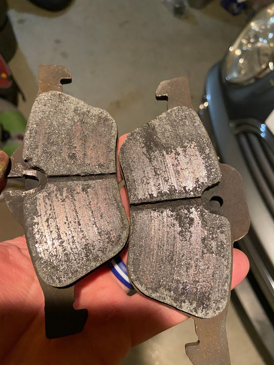

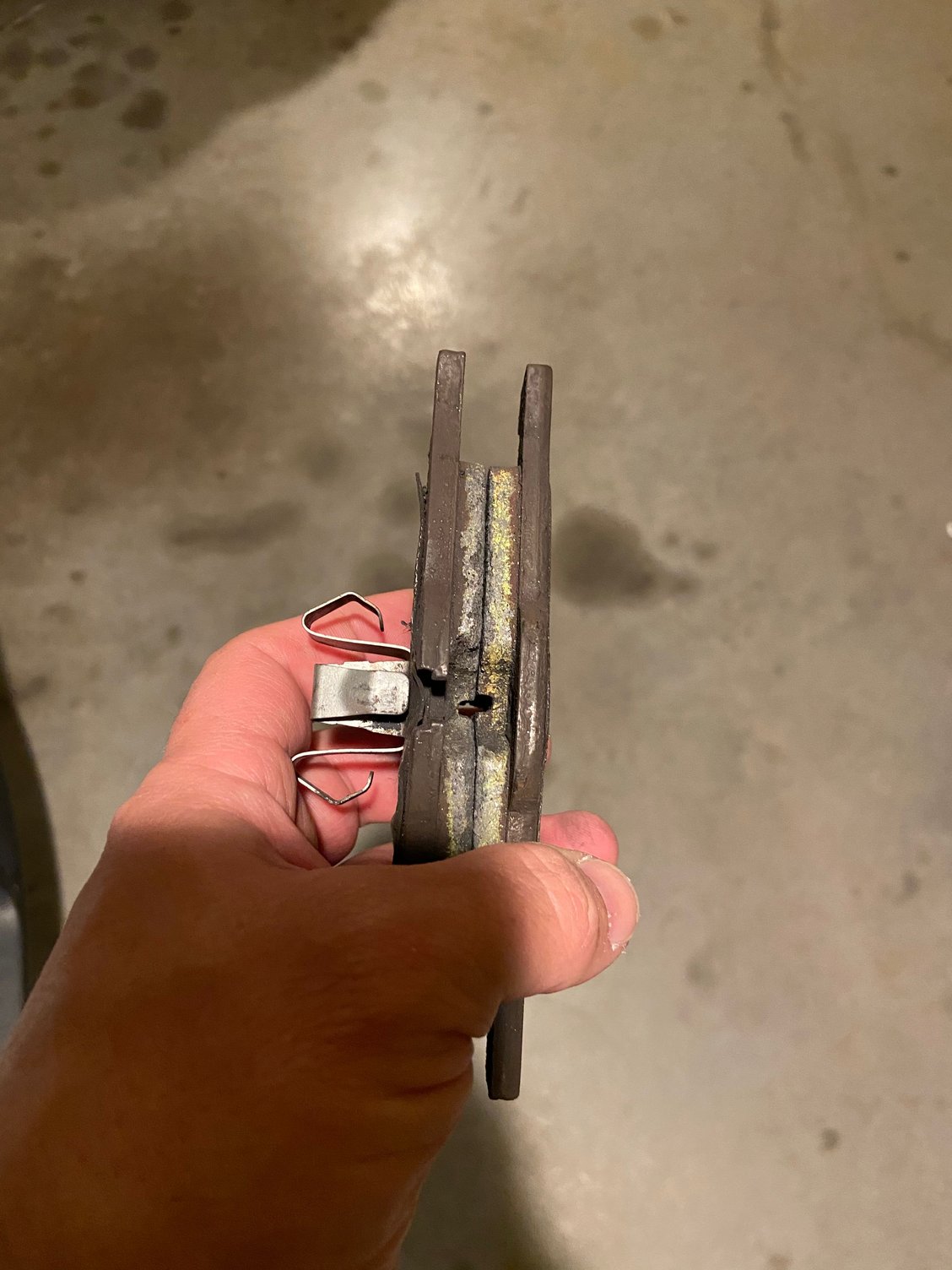

I also swapped the EBC yellow pads out and was surprised by two things. 1, the amount of wear, I didn't measure the pad thickness before going to the track, but I estimate that they were 1/2 inch thick, and now have 1/4 inch of material left of them. The second thing that surprised me was it looks like I've lost chunks of pad material. I've never seen pads wear like this before.
getting pretty thin.
Hard to capture, but the non-shiny parts of the pads seem like there's pad material missing.

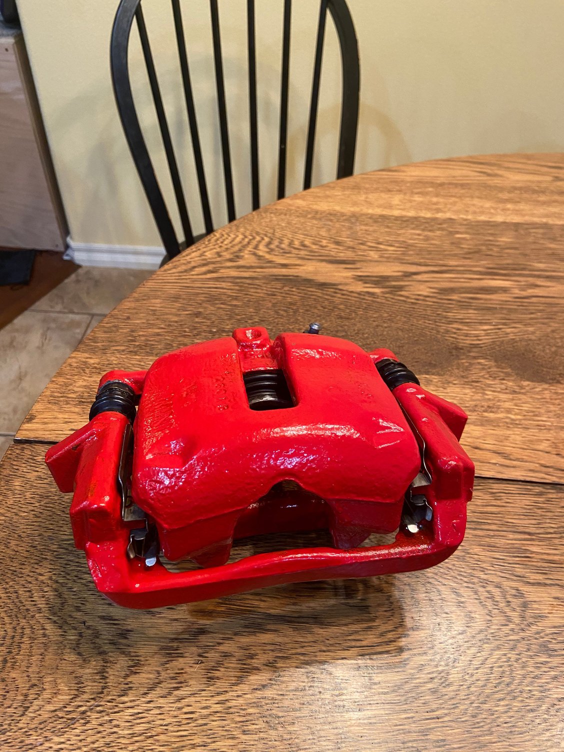

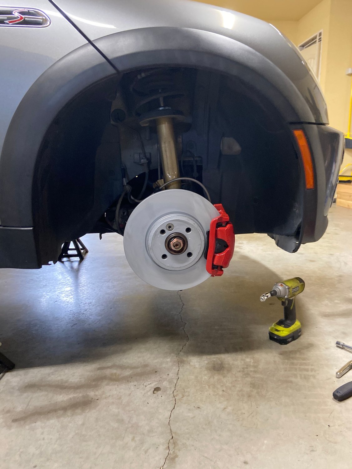

I finally got the calipers cleaned, painted, and mounted
I’m not in love with the pedal feel, it’s a little light and vague in the first bit of pedal travel, but I think it’s ok. Hopefully the increases heat capacity will be worth it.

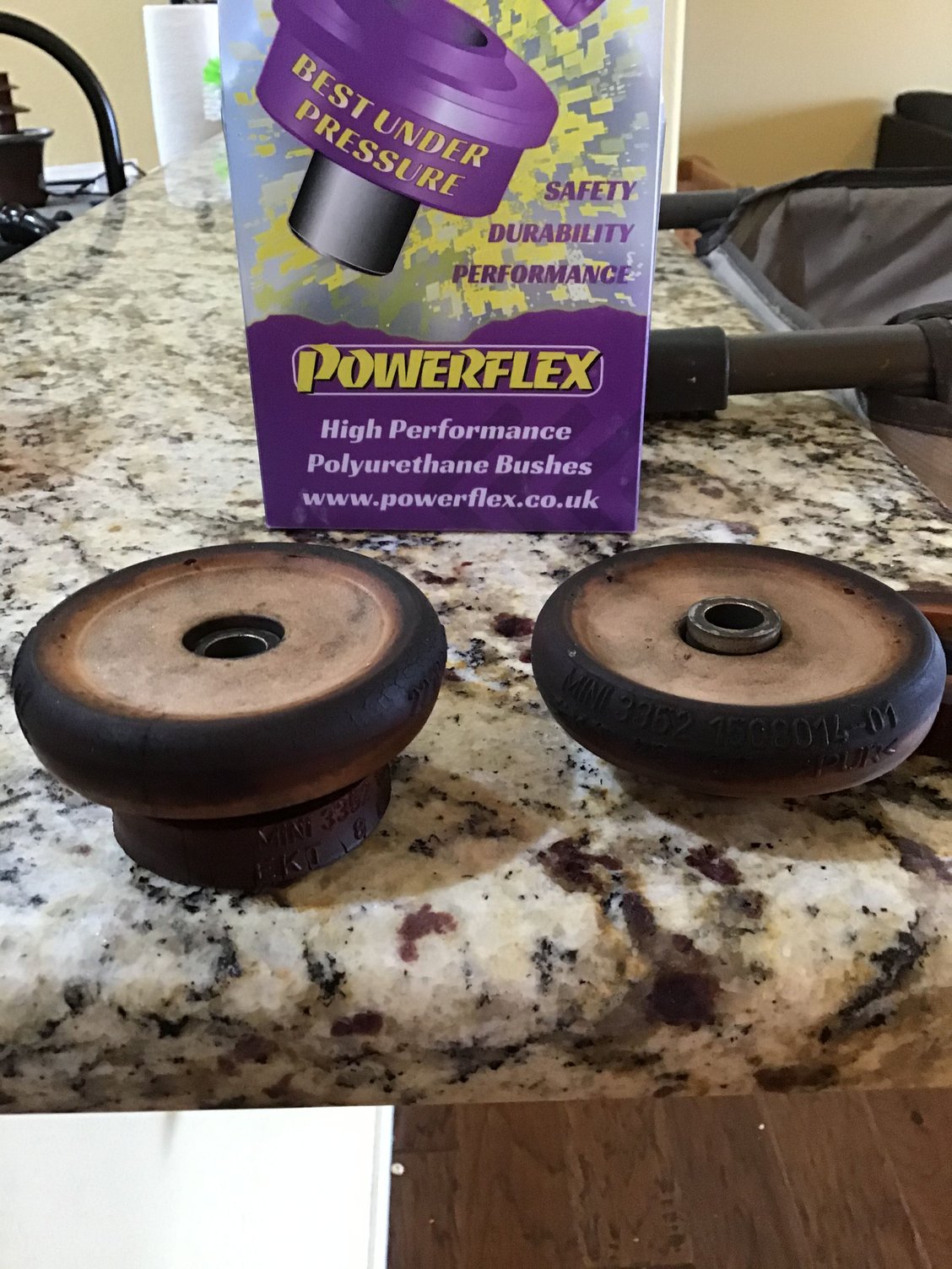

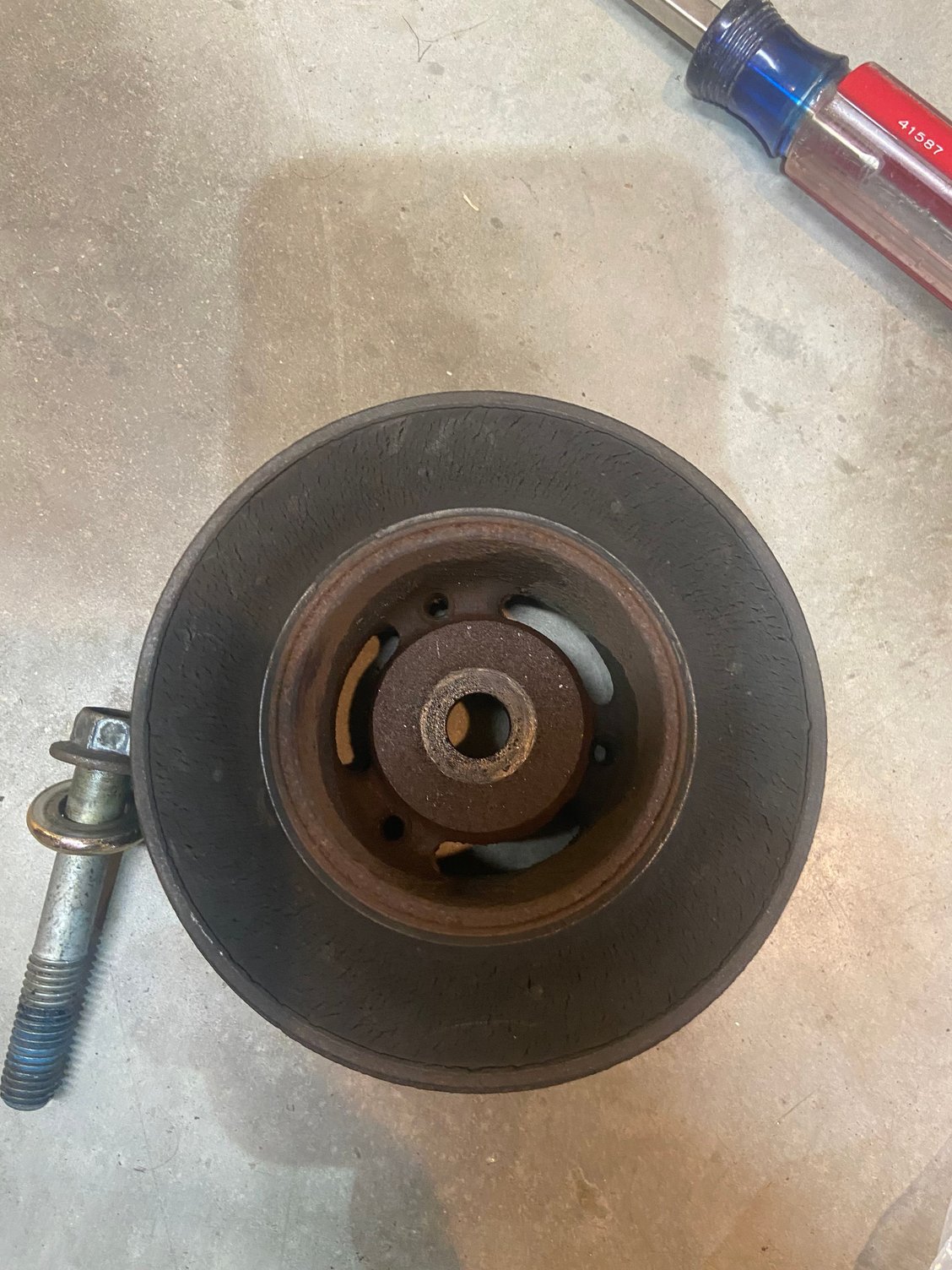

I also replaced my rear strut mounts with Powerflex models. After 18 years and 109 thousand miles, the original ones were done.
In a rare concession to ride comfort, I went with the yellow instead of black. I figured these are directly between the road and the car, and so a little more give might be good.
I also plan to install the Powerflex rear trailing arm bushing inserts. (Went with black for those) I’ve had just a little floaty vague feeling in the rear end and I’m hoping one or both of these will eliminate it.

Way too long on this update, but life has been busy. The day went well, the first 2 sessions were wet so I did them on my street tires, it was all I could do to keep the car on the track. I did have a bit of brake fade in the second session, I think because the DSC was on and trying to keep me in a straight line. I also didn't have my brake ducts on. But once the track dried the brake ducts and slicks went on and things went much better. I only snapped one picture, but it was with an R56 on track in the background.
I was much happier with the R56 calipers and the hawk DTC-60 pads up front, after I turned off the DSC and put the ducts on, I had no fade. I might be able to get away without ducts, but I didn't try it.
I was pretty happy with the handling, but found the rear end got a little light on me a couple of times.
I haven't gotten out since april, and looks like I won't until august or september. I still need to replace the EBC yellows in the rear, I've pretty much decided to go with carbotech, probably x12s.
I'm also hoping to add the WMW/TSW under chassis brace to the car, but they're currently on backorder.
